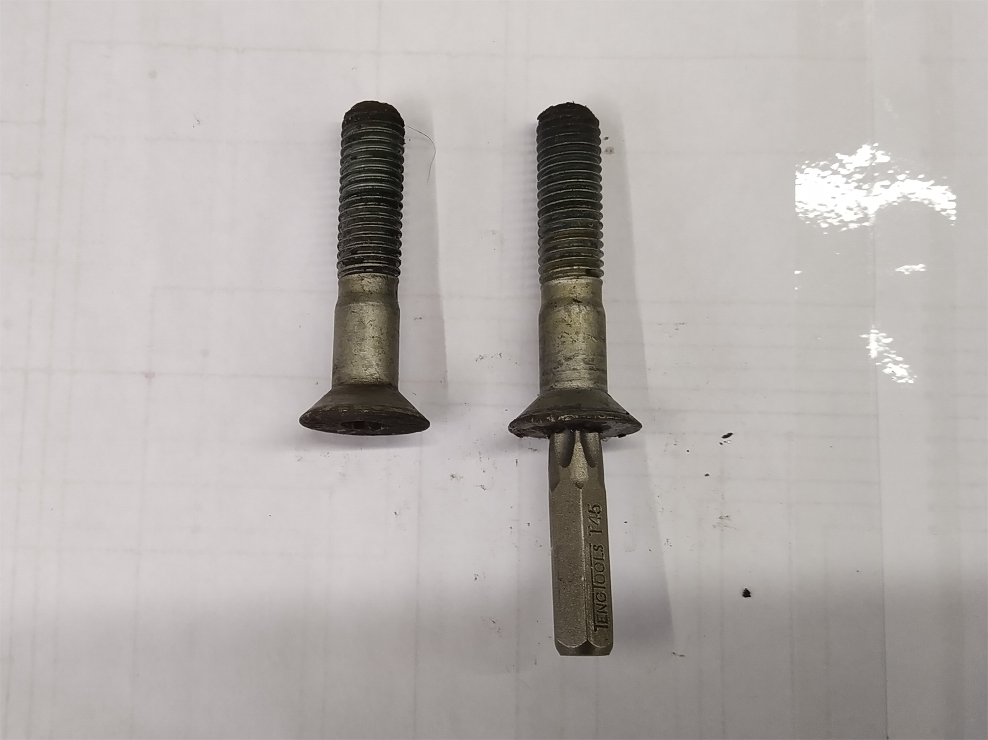

Thanks for confirming the AI on Google. Unfortunately things did’t go too good! I removed left side rocker cover , but two screws on the right spark plug cover wouldn’t budge! As predicted I have chewed the heads. Any recommendations where to purchase replacement screws? I have ordered stuck screw remover bits on Amazon(Hope they will work! Thanks for your help.

If they’re allen head screws (cap heads), find the torx bit that’s marginally bigger and hammer it in. Mind your fingers! It will cut itself a new grip area and the hammer shocks will help loosen the corrosion binding the screw in. Once the torx bit is in as far as it thinks it wants to go, use an impact driver with the torx bit.
I’ve removed recalcitrant and wrecked allen bolts from M5 to M10 using this method.
[Edit] I forgot to add, I hate those eze-outs (the tools you’ve bought from Amazon) with an absolute vengeance. They break easily and once broken it’s either a replacement part required or extremely expensive spark erosion to remove the eze-out and the bolt.

:grin: Here’s an example; I was removing the M10 (8mm cap head size) pivot bolts from a BMW K100 main stand and they were well stuck in (blue Loctite which is a factory fitting). On the bolt on the left you can just see the new grip area made by the Torx bit. The bolt on the right needed beating off the torx bit because it was gripped so hard.
Torx bit in M10 cap head screw
It does work.

Sorry for late response, I used the torx method. Now to check the valve clearances. Thanks for advice. Much appreciated.
