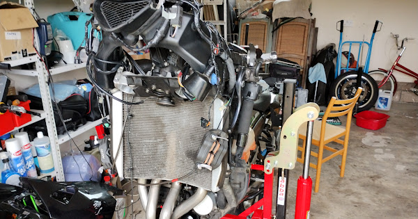

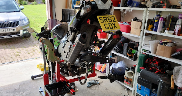

Lets you see why I am keen to crack this as, in my view, allows you to do so much over ramp/table type gear and without having to use tie downs, extra jacks and no risk of slides or topples. You can see the cradle that clamps the bike and that bottom bar that fouls the cat. BTW the front wheel chock you see is not necessary. I just happened to have the bike in it and neglected to remove it. I added the pic of the Morini where you can see the adapter I used to work with it. If you can see the brass coloured boss fitted to the upper fixing of the footrest frame just left of the big swing arm bolt head? I need to find them and hoping I took them off the bike before I traded it!!

Woohoo! Managed to crack the lift issue this morning. Found the bobbins that I had for the Morini and affixed them to the upper bolt locations on the footrest casting using a longer bolt.
That got me to within a hairsbreath of lining up the cradle clamps with loads of clearance under the cat. All it took to square them up was rolling the back wheel on to a piece of board maybe 3/4 inch thick and Bingo. Everything slid in and fit snug and tight. Locked it all in and bike solid as a rock vertical Couple of strokes on the jack pedal and up she came, bike going to stoppie position in increments.
Now even at that I can have the bike level for oil checks or to raise horizontal could simply put a cantilever jack under the sump but if I can get a single side swingarm sleeve to slip in the centre of the back wheel hub then I can use it as intended with the restraining strap to either have it both wheels up and horizontal for winter storage or wheelie position for front end work, dropping the forks etc. Well pleased I can again use the lift for whatever.
