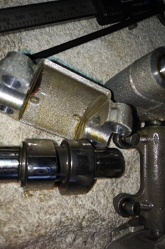

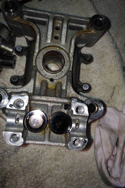

Well with only 15000 miles on the clock the flat tappets went into melt down, I had an oil analysis test come back and one of the metal counts (iron) had shown an increase in PPM particulates in the oil readings - a small amount but an increase all the same - so I pulled the cam box (easy job and stripped out the flat tappets and hey ho the black coating was away bearing the shine but so far hardly marked or worn metal underneath, the cam faces were starting to blue up a bit though. They are being replaced under the guzzi rollerisation free parts supplied set up - by jim allen motorcycles - who i have to say have been absolutely brilliant to deal with. pics attached of flat tappet and cam.
Glad you caught it in time.
You’ll enjoy the difference when its done and you have the roller map installed as well.

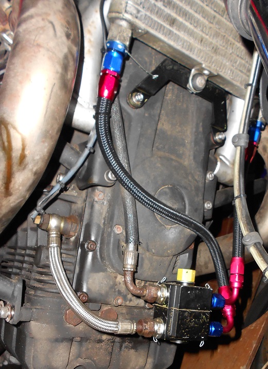

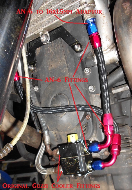

I made and fitted a Thermostat Unit to the Cooling Circuit on my Stelvio back in April 2017, around 10,000 miles on it since then (I know, long story, but I need/want to do much more).

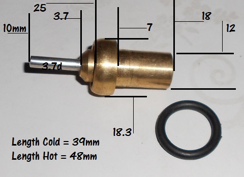

Wax-Stat used starts to open at 93°C.
Warms up quicker, and settles at around 110°C most of the time.

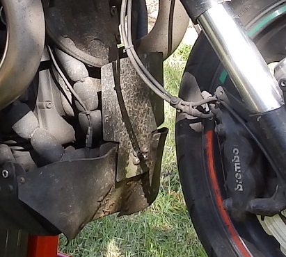

Still runs a little Cool in the Rain, despite adding a Shield to the Unit (sits right behind Front Wheel), and insulating the Hoses.

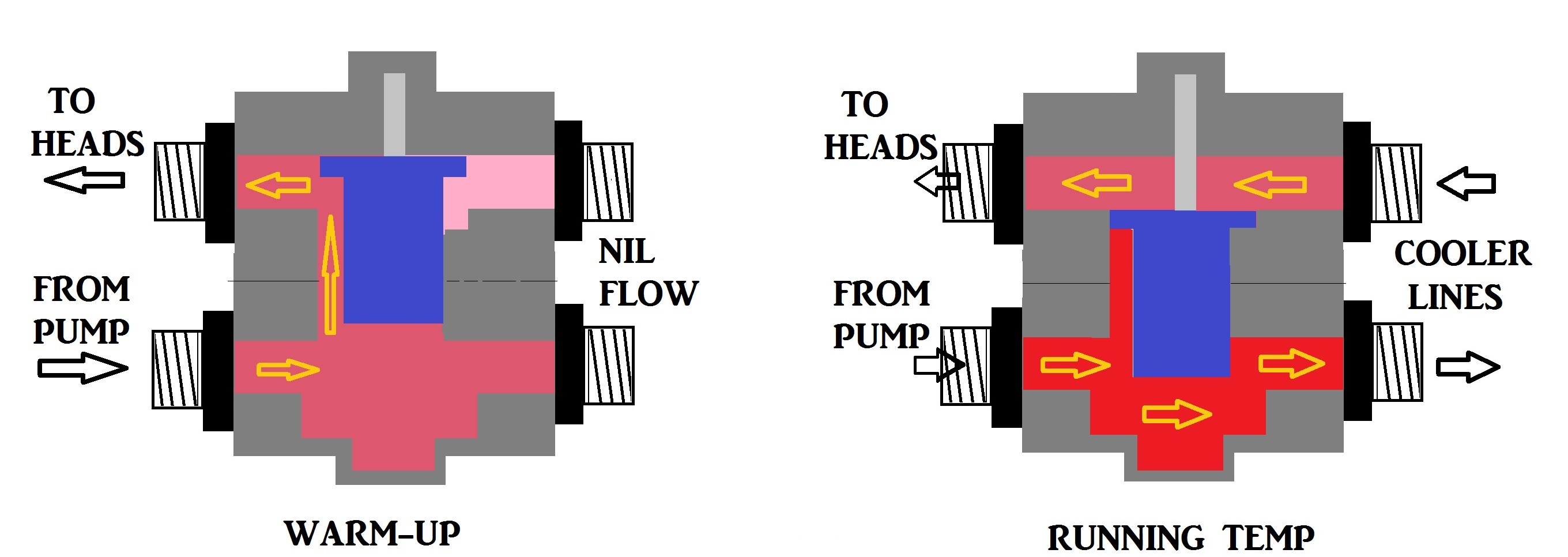

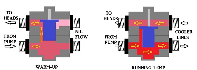

The Thermostat Unit does the bypassing Brian.
While it’s ‘closed’ (Oil Temps below 93°C), the Cooling Circuit Oil from the Pump (Low Pressure-High Flow) flows directly to the Heads, without passing through the Cooler. Once 93°C is reached, the Wax-Stat starts to extend (against a small compression Spring), closing off the Bypass Circuit, and allowing the Oil Flow to go through the Cooler.
When the Oil temp drops again, the Wax-Stat contracts (helped by the spring), to start to close off the flow through the Cooler.
The system continually modulates the flow to keep the Temps fairly constant in various conditions (Speed, Air Temp, Engine Load etc).
Spring not shown, but it would be underneath the Wax-Stat (Blue), pushing upwards.

Each Wax-Stat has a set Temp where it starts to extend, there were three or four to choose from as I recall, I went with the highest, at 93°C.
It’s the same unit as used in many Water Cooling Thermostats.

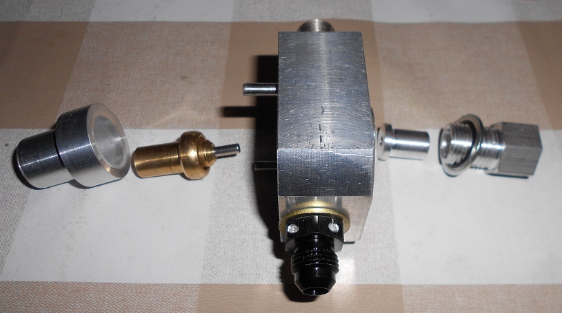

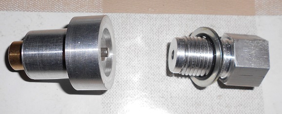

I made a Valve Body for my Wax-Stat to sit in, to direct/restrict the Oil Flow.
You can see the Base of the Wax-Stat sticking out on the left, Spring sits over that, the Plunger Rod can be seen at the other end.
The Rod goes into a blind hole in an insert in the removable Cap Piece, so as it extends, it pushes the Valve Body down against the Spring.
The Insert is removable, so I can replace it for one with a deeper or shallower hole, to fine-tune the overall movement of the Valve Body if required.
