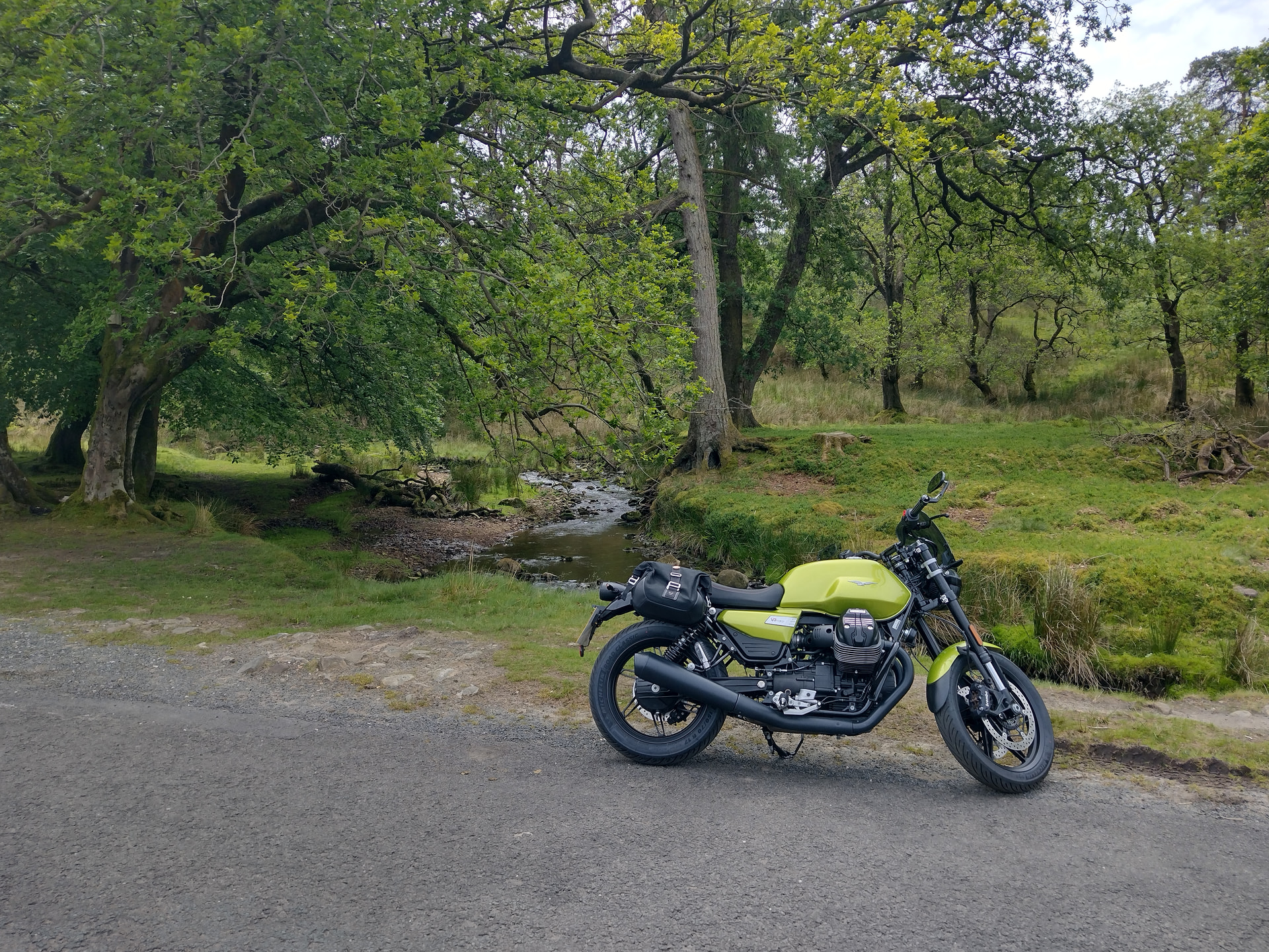

I had a Pyramid extender fitted to my 2022 v7 stone, I took it off as it seemed to ‘flap’ a bit; my fault as I didn’t take off the fender to fit it properly on the supplied pads (idiot). Anyway, I still had it on my workbench when I traded up to my 2025 v7 Sport. I took the Sport’s fender off, roughed up the underside and fitted the Pyramid extender using evo-stick and clamps. Looks fine (see photo) and so far hasn’t come loose. It’s reasonably effective too.
Whilst that looks very tidy and is arguably more aesthetically pleasing, it isn’t the Fenda Extenda recommended by Pyramid for the 2025 onwards V7 Sport which is considerably longer and has side supports that mount to the front brake calipers.
