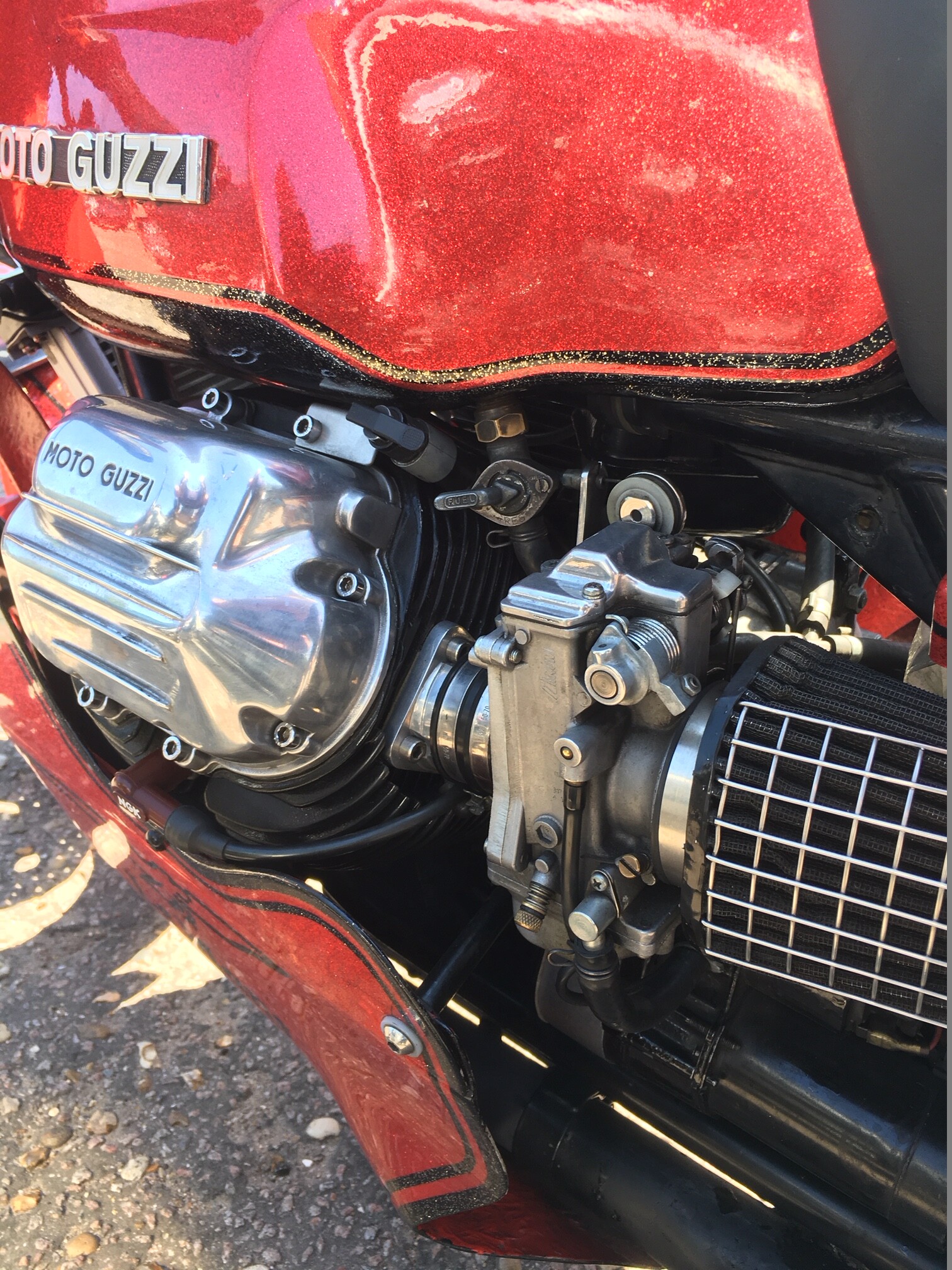

Is it this sort of pulley thing? Spotted in 2019 at the Essex branch Fordham Heath meeting
From memory Chris, a metal rod was fitted across the frame and passed through the holes in the bracing piece visible rearward of the carbs in your photograph, I imagine through some kind of sleeve. There was a pulley fitted on each end of the rod with a short length of cable to each carb. The carbs were further back so must have been on longer inlets. The tank was in place so I can only guess that there was a pulley in the centre of the rod with a cable going to the twistgrip. This was on a Le Mans in Italy that was advertised for sale around 2019. Advertised in Car and Classic.
