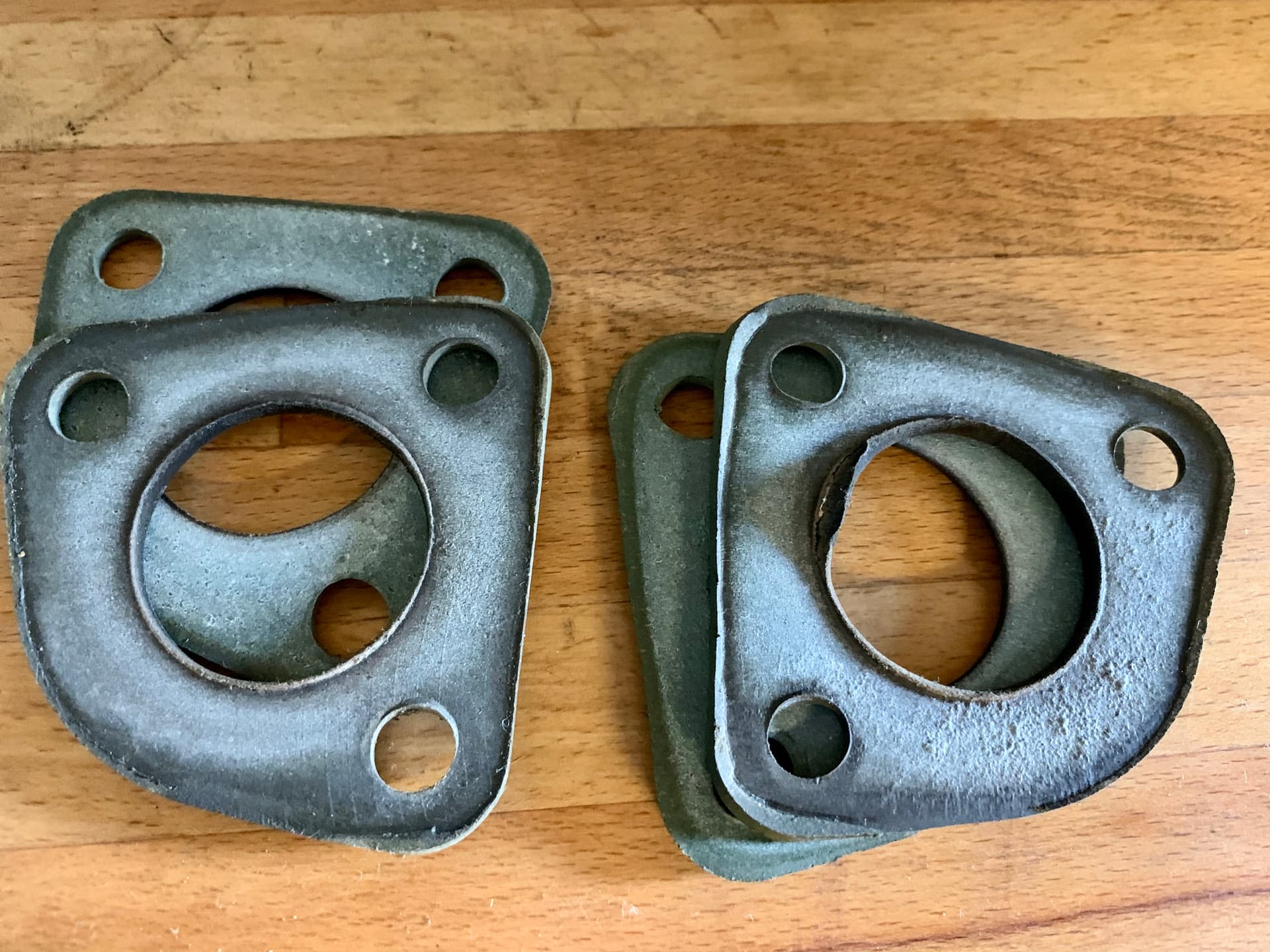

Replaced the inlet manifold gaskets this afternoon.
Strangely whoever had done it last had installed two gaskets on each one.
Could this have resulted in an air leak, between the gaskets ?

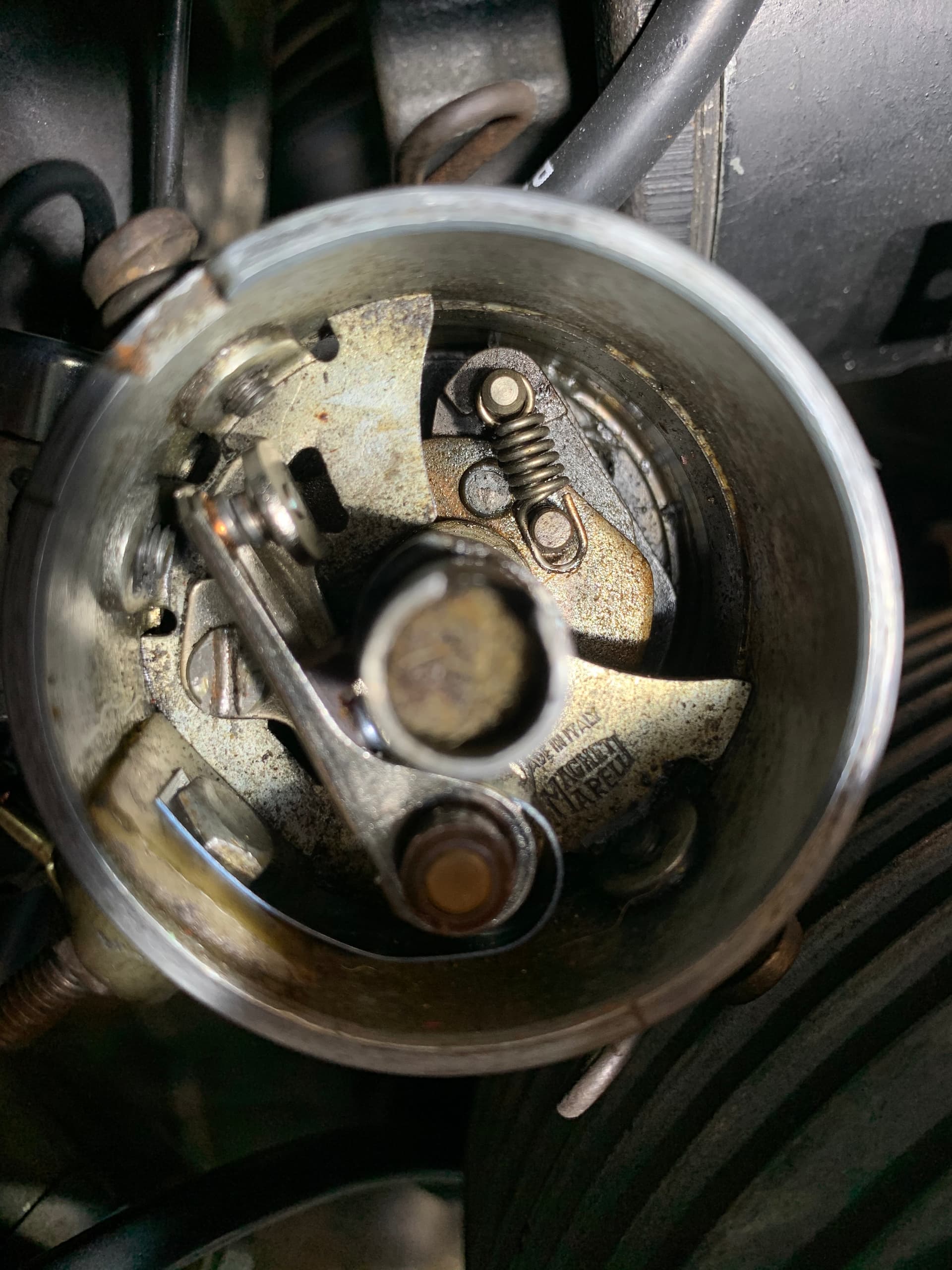

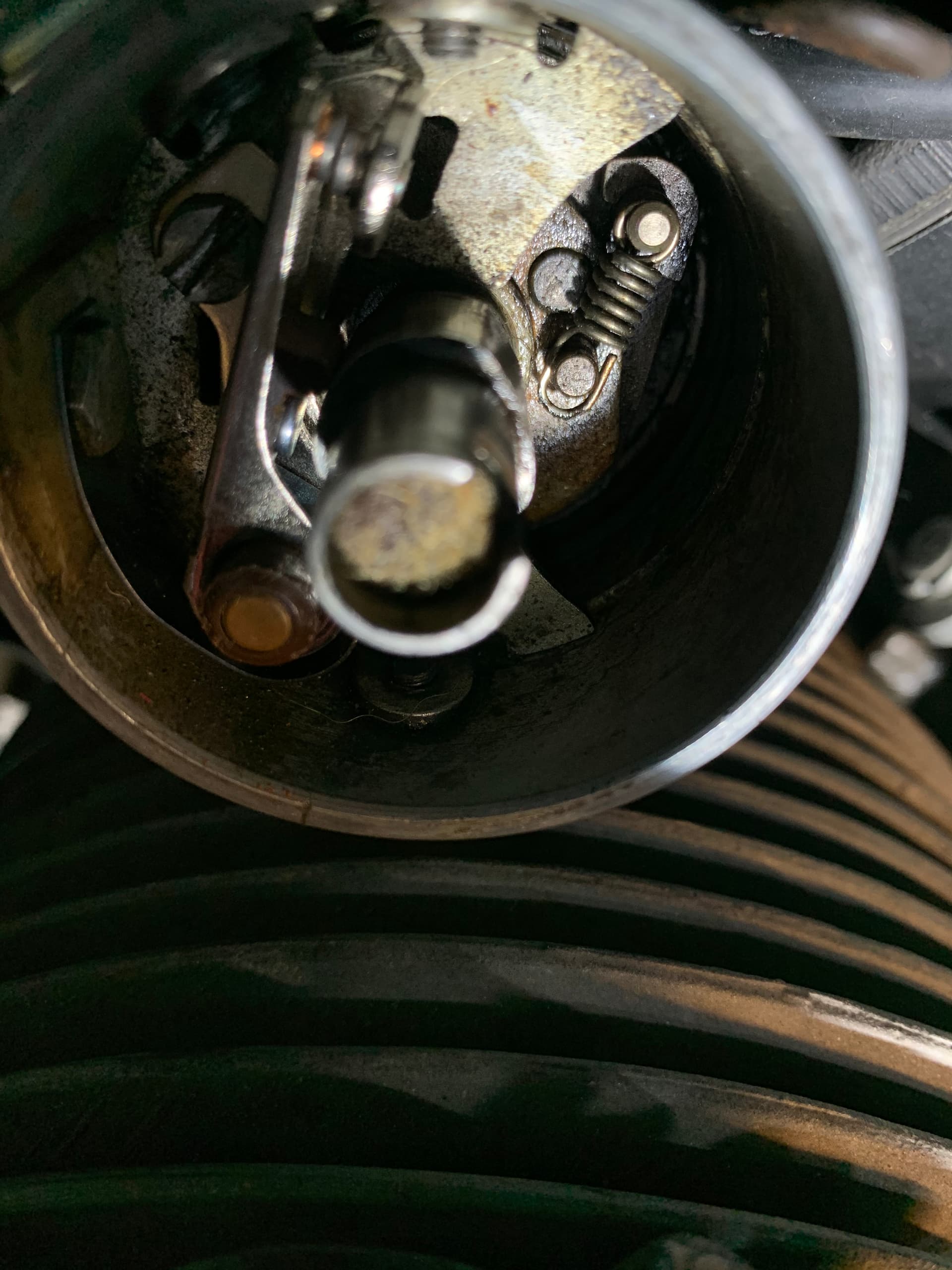

I think I may, just may, have located the culprit for all my woes.
One of the springs in the distributor, on the advance mechanism, seems to have lost it’s springiness.
In fact it might not even be the correct spring at all.
There is no tension on the advance weights, and a lot of free play in there.
Looks slightly different to the springs pictured on Gregory Bender’s site.

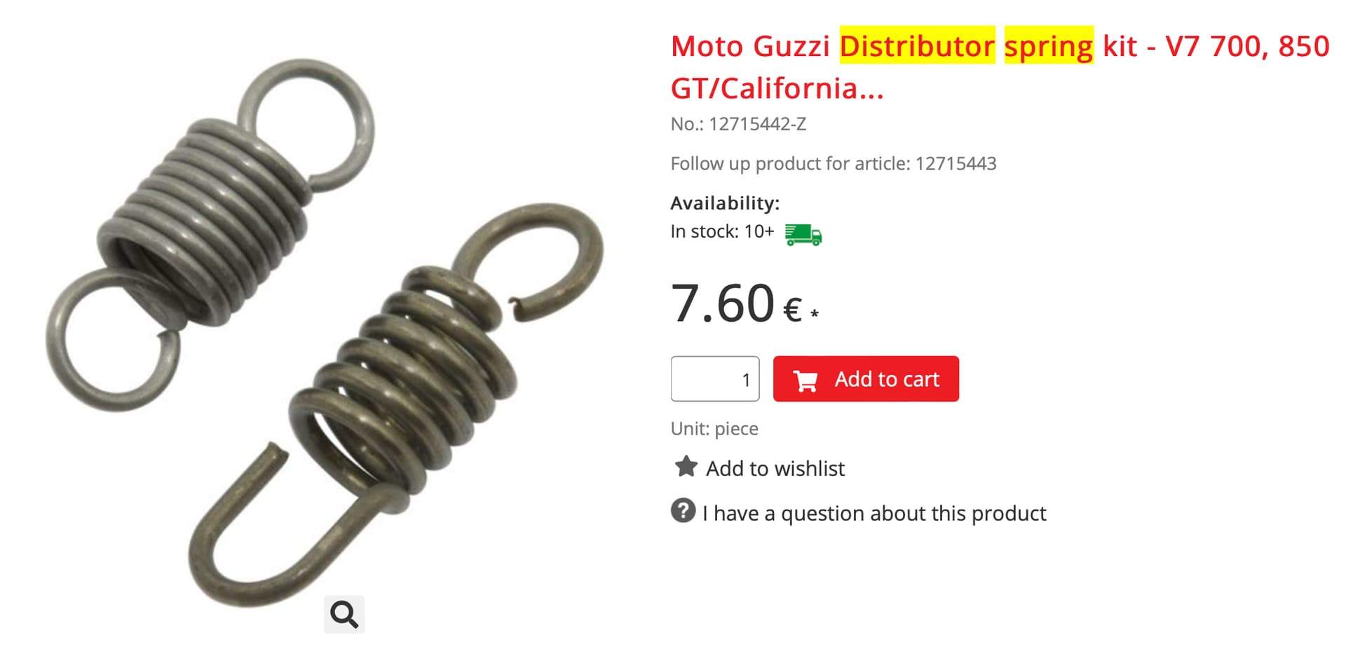

Looking on Stein Dinse, the replacement spring looks just like mine.
Maybe that’s not the problem.

I think 2 gaskets is normal - to reduce heat transfer to the carb.

Fingers crossed, but I might have finally sorted this out. .
Replaced the advance springs. Taking it apart it was obvious that nobody had done this in 50 years.
It was filthy in there.
Put in new springs, which was like doing keyhole surgery, and lubricated the weights a bit. I think that it had been stuck on full advance. Idling okay at the moment. Touch wood.
Thanks to everyone for all the help and suggestions.
Many bob-weight advance retards have one tight spring and one loose one. This is because as the weights move out they encounter more centrifugal force so they tend to move out quicker increasing the advance in a non-linear way. At that point the 2nd spring comes into play and slows the rate of advance.
I have a 73 Eldo as well. 2 inlet gaskets per carb is standard for heat protection.
Thanks.
I just have one each side at the moment, but will order two more.
