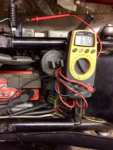

Again just for reference, this is the value of the factory fitted charging resistor on my lemans 4, 69 ohms

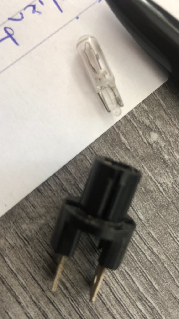

Just pulled the charging light and it looks like a 1.2 but can’t find any writing on it.
I was going to say, low resistance is notoriously difficult to measure, mainly due to tarnishing of the metal parts that you want to probe, and the probes themselves, a friend who used to be a technician for a cancer charity told me they would sharpen their meter probes until they’re like needles, so the sharp points could penetrate surface oxidation on connectors.
But like you my Fluke, that cost £250 second-hand 30 years ago :open_mouth: - and from a mate at that - has an internal error of 0.2 Ohms so first thing I have to do is subtract that from any low resistance measurement.

It’s an old Guzzi, I don’t think there’s any need to worry about fractions of ohms.
