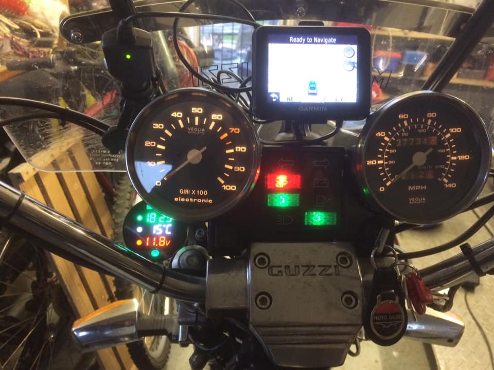

I bought a cheap car sat-nav off marketplace for a tenner and mounted it on the dash of my Cali. The screen keeps it protected from the weather.

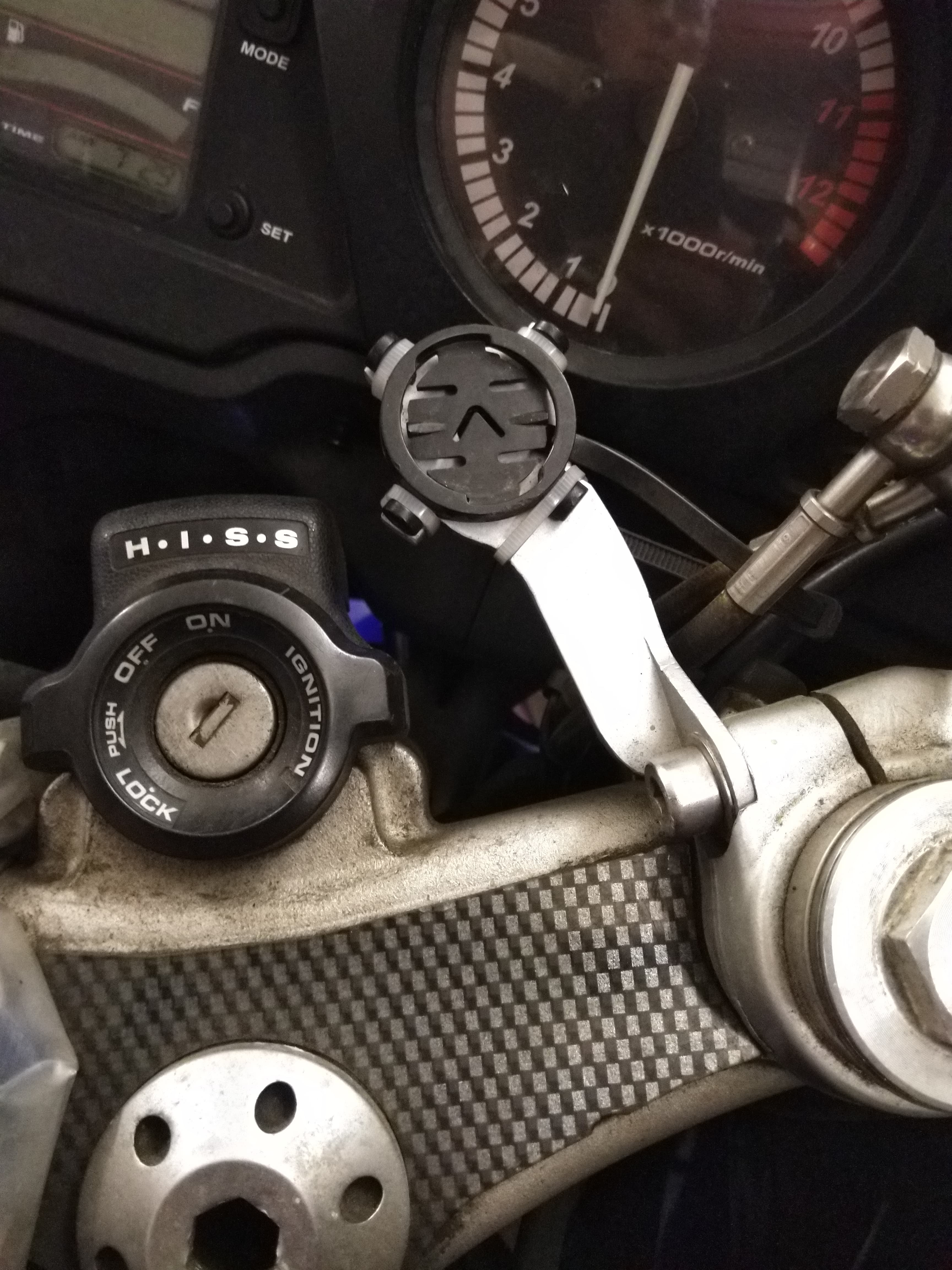

I too was worried about the beeline bracket snapping off, so I made my own from some 3mm aluminium angle I had. Also that is even tie-wrapped to the bike.
That’s very neat.

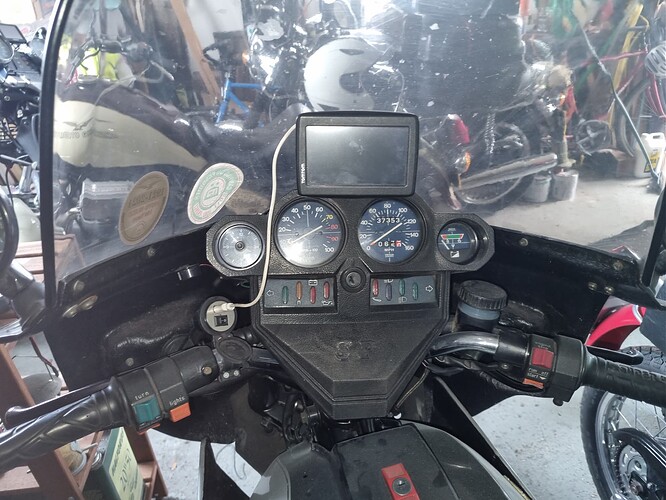

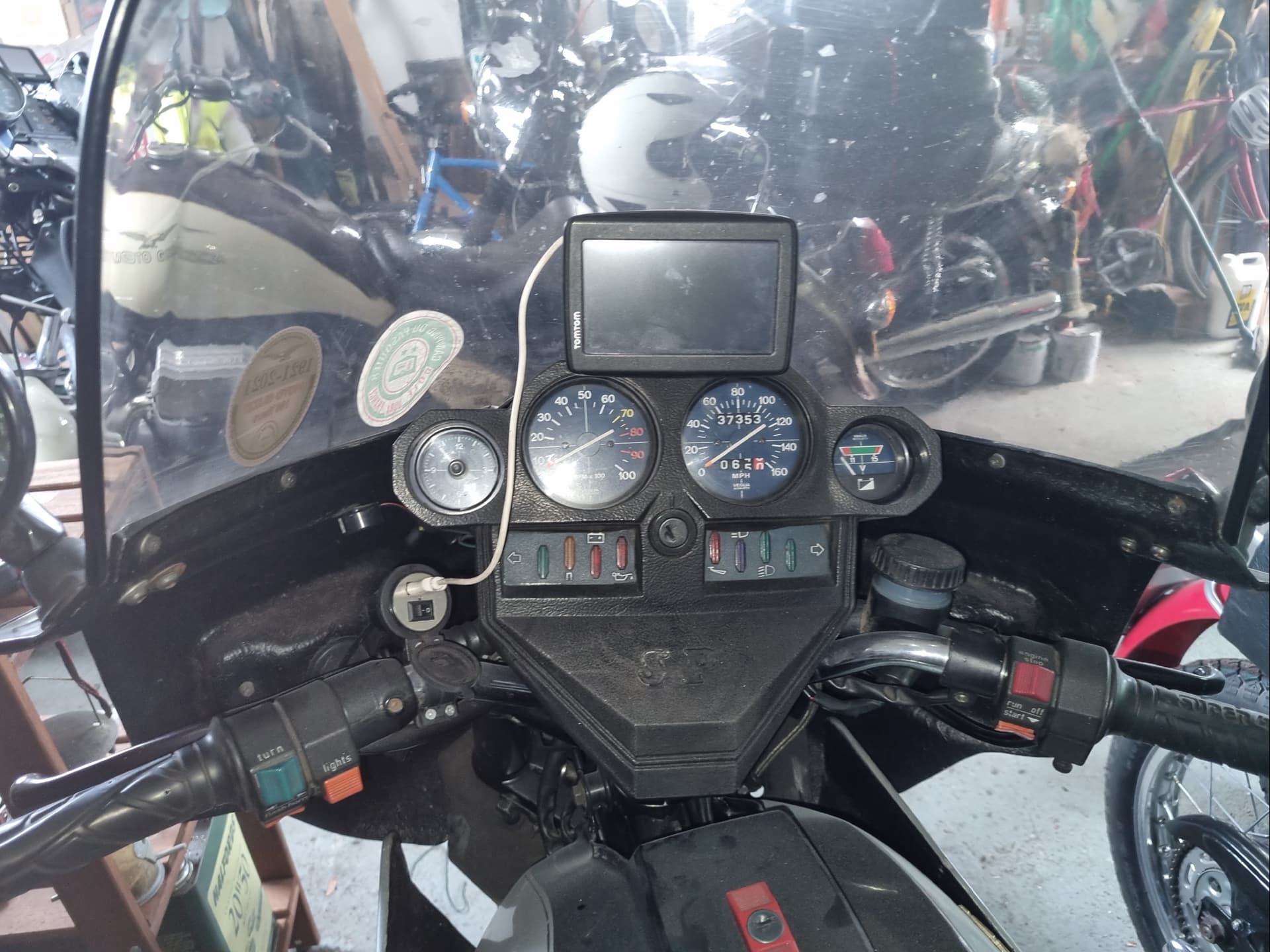

I have a car sat nav inside the fairing of my Spada & use the tomtom rubber suction pad to stick it to the inside of the fairing screen.
Thanks Don. I think I have a suction pad so I’ll have a play. The other issue I have is that as I wear vario focals I have to position it by the dials so I can see it.
This is how mine fits.
Don, I tried it and it does work well but I just dont trust the sucker to hold for the trip to Mandello.

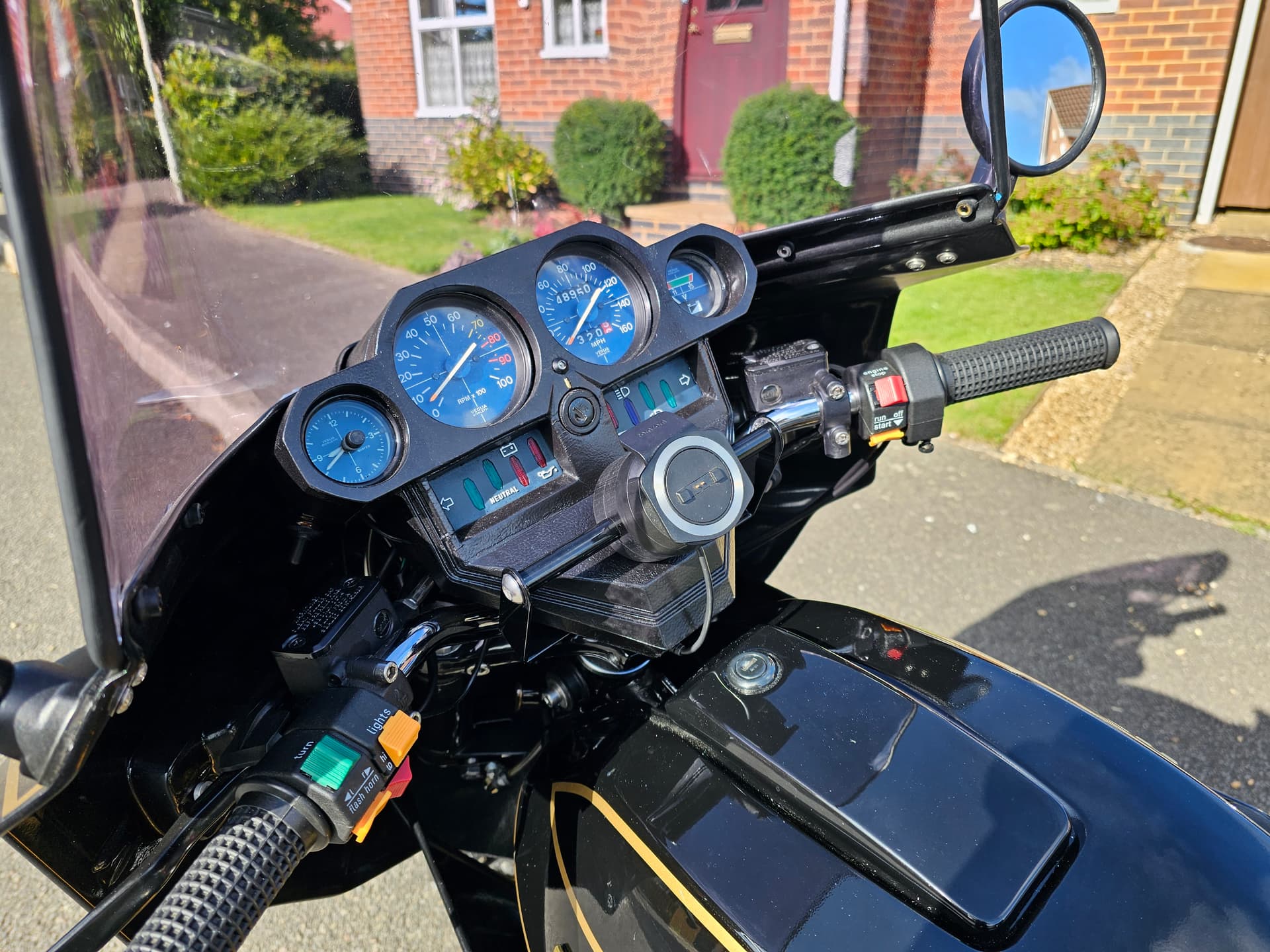

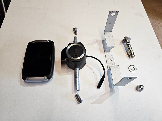

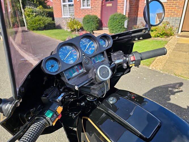

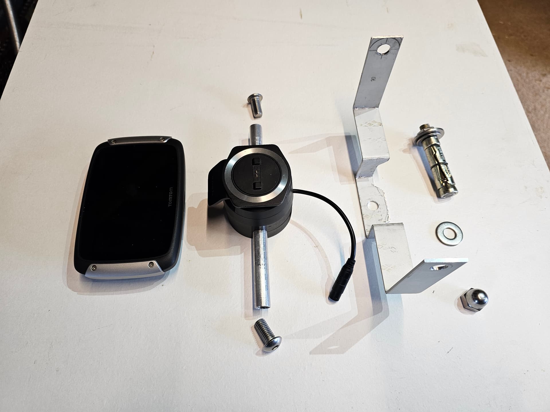

I found an M10 foundation bolt down the stearing stem works as a good anchor for some sort of bracket. Playing with CAD (cardboard aided design) to see what works best.
Andrew
The bracket was 2mm aluminium. Tried it out yesterday on a 130 mile round trip to Ardingly show/autojumble. Worked well but needs to be stiffer. Heavy mount, tom tom and big twin vibes created a lot of wobble. Suspect it will destroy itself if left as is.So I will remake bracket in steel.
