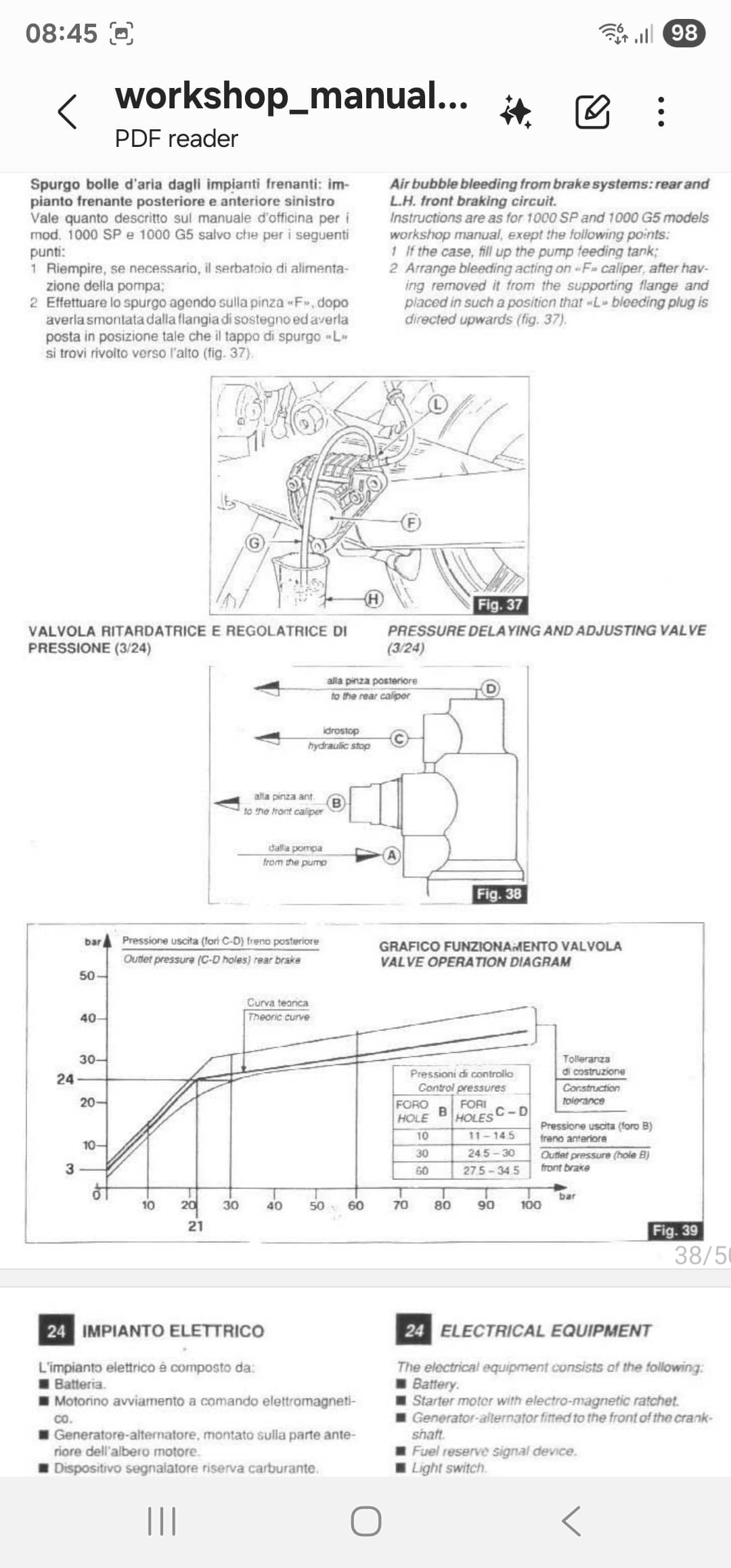

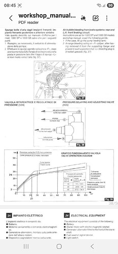

This is from the Cali 1100i workshop manual but the proportional valve is similar on the whole range. May help to prove your case. For what its worth my tester in Kent has never questions it as he understands this.
