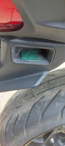

One to look out for…I noticed my bike generating a lot of rattling and clunking noises when negotiating anything other than billiard-table like surfaces.
Turned out it was the rearmost tabs on the panniers rattling about in their receptacles.
Proved this by inserting a couple of shims made from short pieces of double sided foam tape that quietened things down considerably.
It turns out that those large tabs on the panniers seem to wear with continued use…which is why the bags get easier to mount and dismount with the passage of time.
Made up some more permanent shims with a piece of bicycle inner tube and double sided tape that fits onto the floor of the tab socket. These work well to dampen the rattles. They will eventually wear out, but are easily replaced.

Hi Speedy23, a bit late in replying I know, but I’ve only just noticed last week that after around 8-10 trips away with the panniers fitted (I normally ride without them), the rear end of both panniers is so loose that I can easily move them a fair bit by hand. I think this reflects pretty poorly on the original design, so am considering having a word with the dealer about them and switching to another make (Givi, H&B etc). However, before resorting to this I just wanted to check whether the shims have completely fixed the issue for you? Do they still wobble by hand after the shims are fitted?
With the benefit of hindsight, I would NOT have bought the original MG cases, as they’re generally not as good (in several regards) as other bike makes I’ve had previously and IMO don’t justify the price tag.
No, the shims restore the tightness but they wear. Still only a 5 minute job to cut some new ones, though.

Speedy, I had a word with my Guzzi dealers and it turns out the problem on my specific bike isn’t the panniers themselves, but the slot where they fit into the rear of the bike (near the tail light). The attachment point has moved by one or two mm (now standing proud where they should be almost flush with the panel), making the rear of the pannier appear loose. One or two mm play at the top/rear of the pannier translates to a fair bit of movement at the bottom of the pannier.
The dealers are saying it can be fixed and are treating it as a warranty issue thankfully, which I really appreciate.
