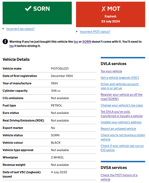

Your old bike is still about, the MOT expired last year and it had a new log book issued July this year. I’m not sure why it is coming up as a 350cc??? Are you sure that registration is correct?

Thank you @Don-Spada pretty sure that was the registration, but time and beer have passed.
