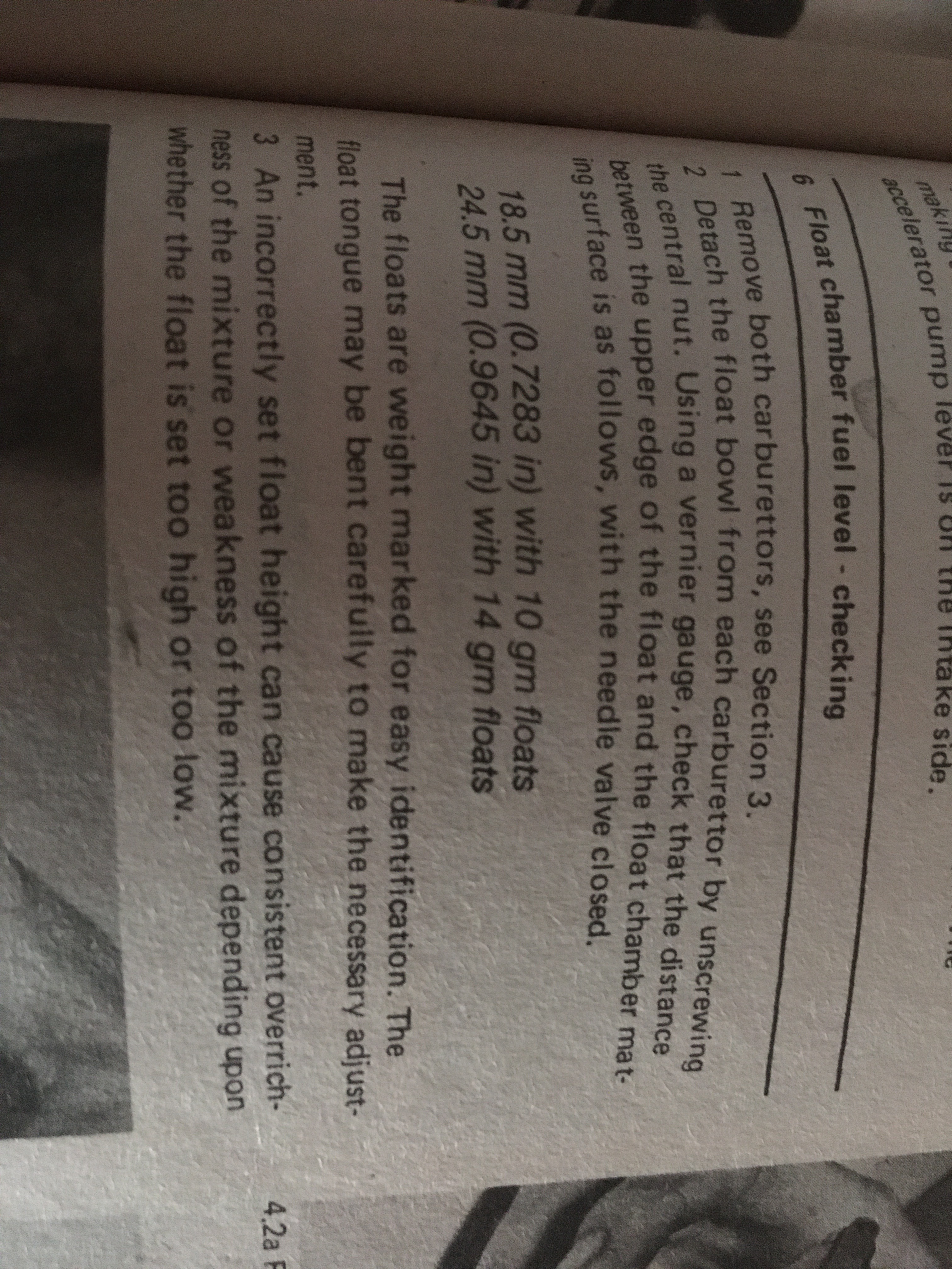

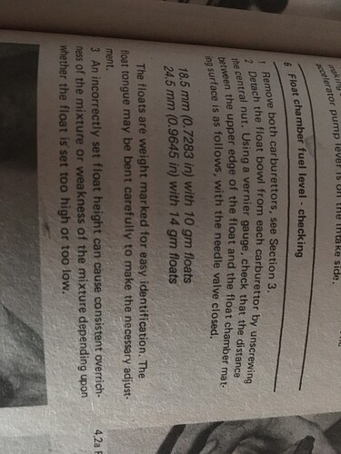

I believe the correct Float height is shown in that earlier diagram, I’m curious to know which manual tells you to set at 18.5mm. The original factory manual showed this diagram for all models and 850 Le Mans owners were tearing their hair out trying to conform only to discover that the correct setting for their 36mm PHF carbs is 18.5mm.
Hi Jay, this is the source of my float height information. The paragraph follows 2 sections referring the VHB and PHF carbs, respectively. I am puzzled because my carbs have 10g floats but the heights are set at around 24.5mm (the setting advised for 14g floats).
I don’t think incorrect float heights are my problem, as one cylinder appears to fire correctly whilst the other is rich, but the float heights are the same on both carbs.
Cheers,
Steve
Ah, I forgot about the Haynes manual. Yes it’s a source of information but not always helpful. Float height is very important. The factory manual gives the float height as per the above diagram so I would go with that.
And because I just can’t let things go, I’ve just dug out the original carbs off my T3 which I know were never tinkered with because I bought the bike brand new. The 10g floats measure exactly 24mm.
Hi Jay,
That’s reassuring - I thought I had the wrong floats and/or the wrong heights, but I’m happy that they are okay.
Of course, I may have a leaky float ;causing the rich running) but I’ll check that when I fit the rebuild kit.
