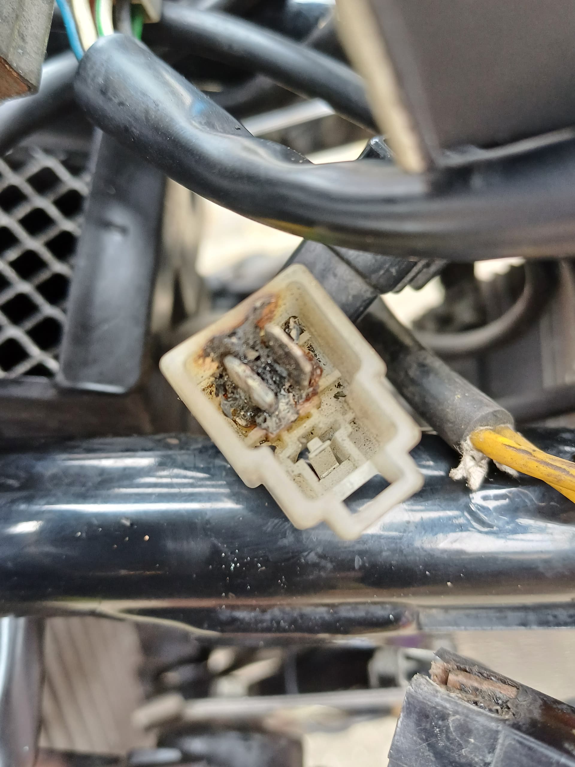

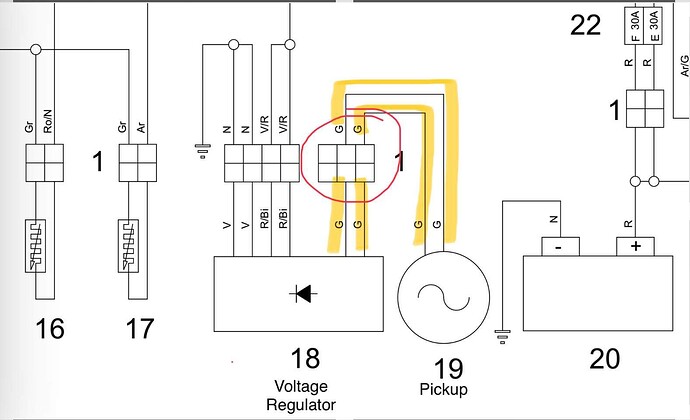

what is that supplying ?
it looks like the main feed, so out with the cutters and run some new cable and connectors
cut the cables right back to source, as the overloading will have heated the cable and made it brittle

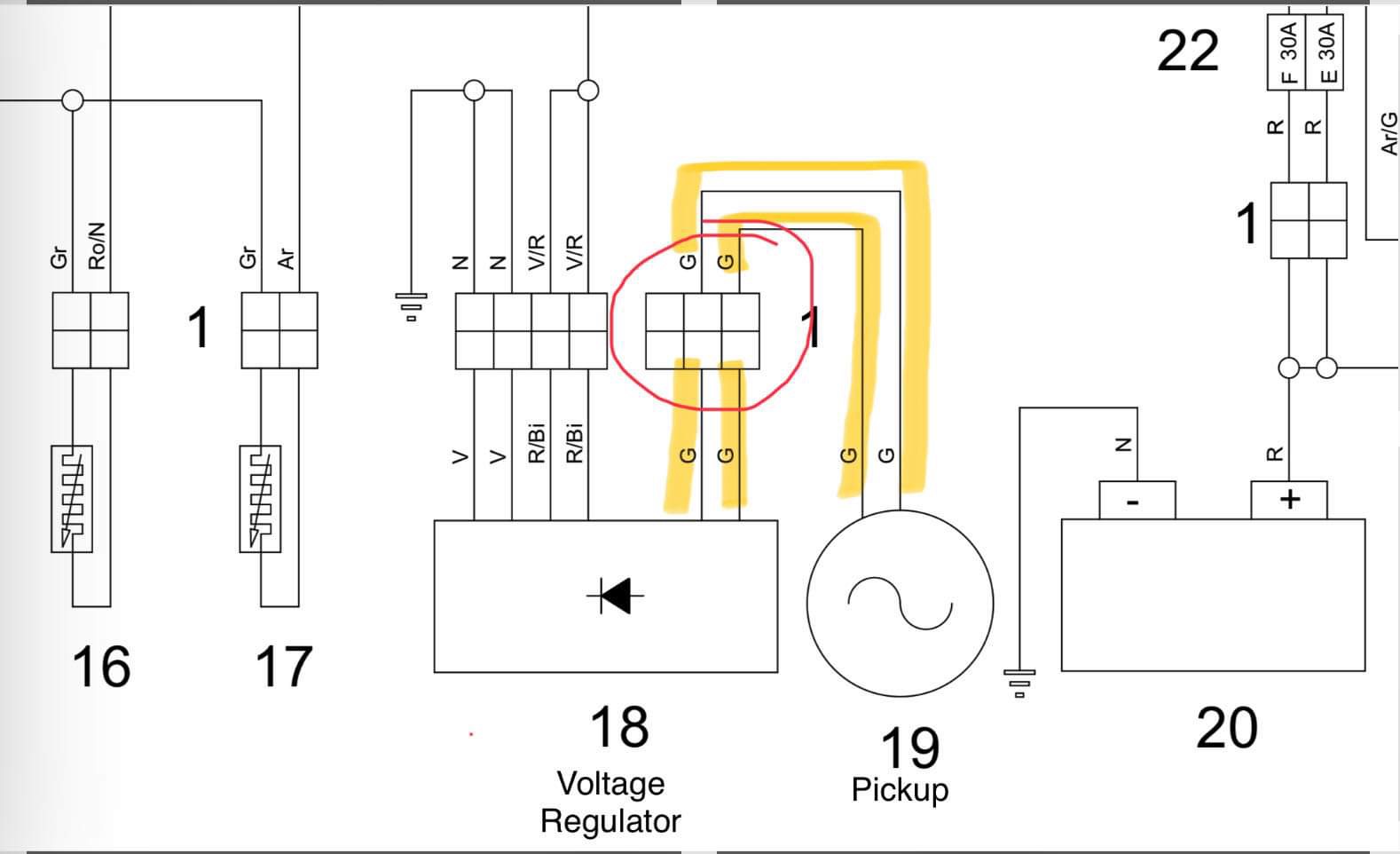

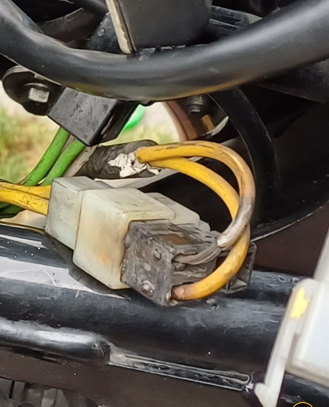

Yellow wires go from the alternator to the regulator. I assume this is also the rectifier.
Yes indeed, the two yellow wire connector block is between the regulator (reg/rect I assume too) and the ‘pickup’, so alternator.

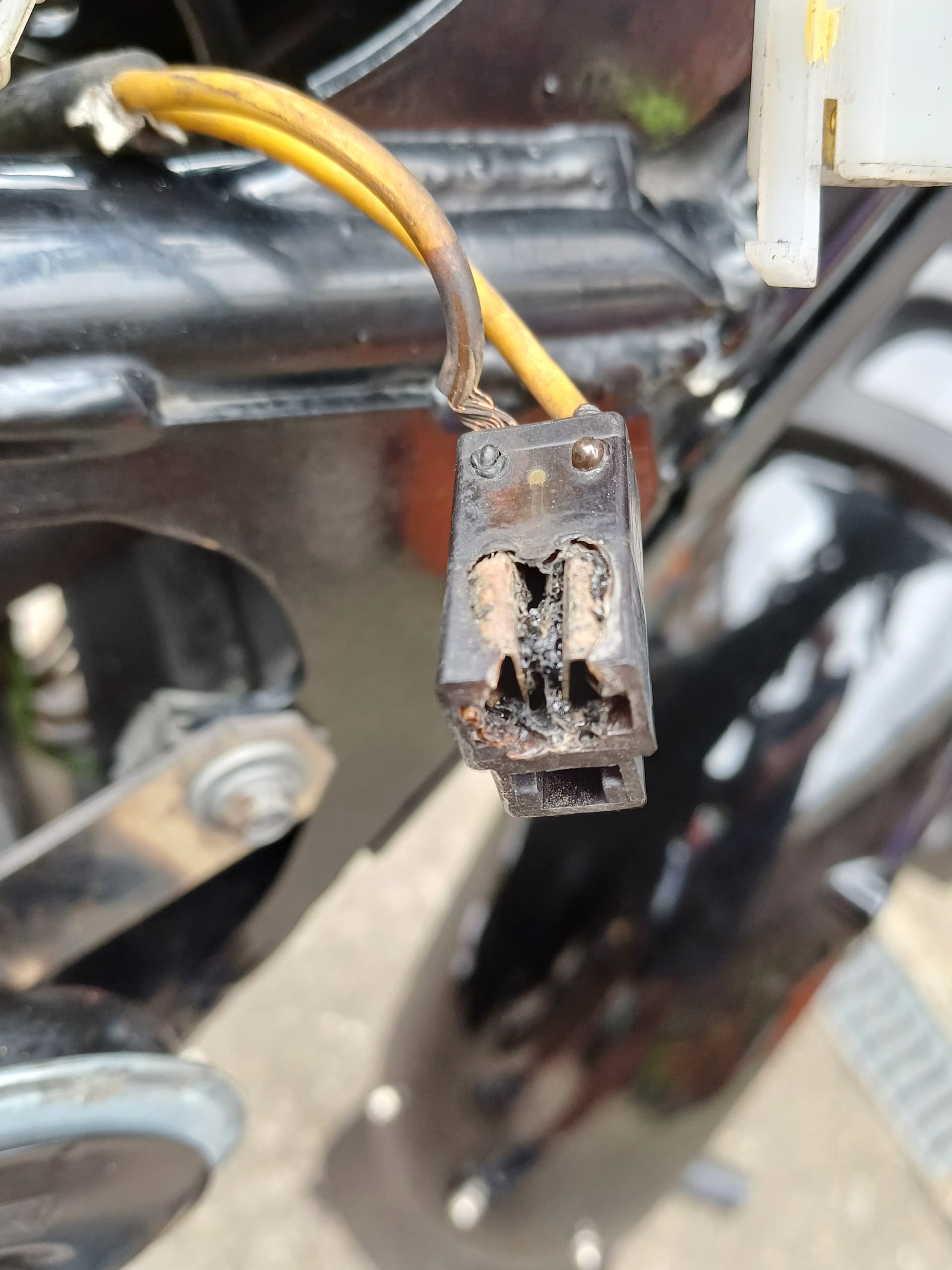

I’ve taken the starter to a well respected auto leccy, a quick test on his bench said it wasn’t right, told him how much I can replace it for, he’s gonna call back when he’s had a proper check.
He also gave me a nice Durite Deutsch DT connector to replace my burnt out one.

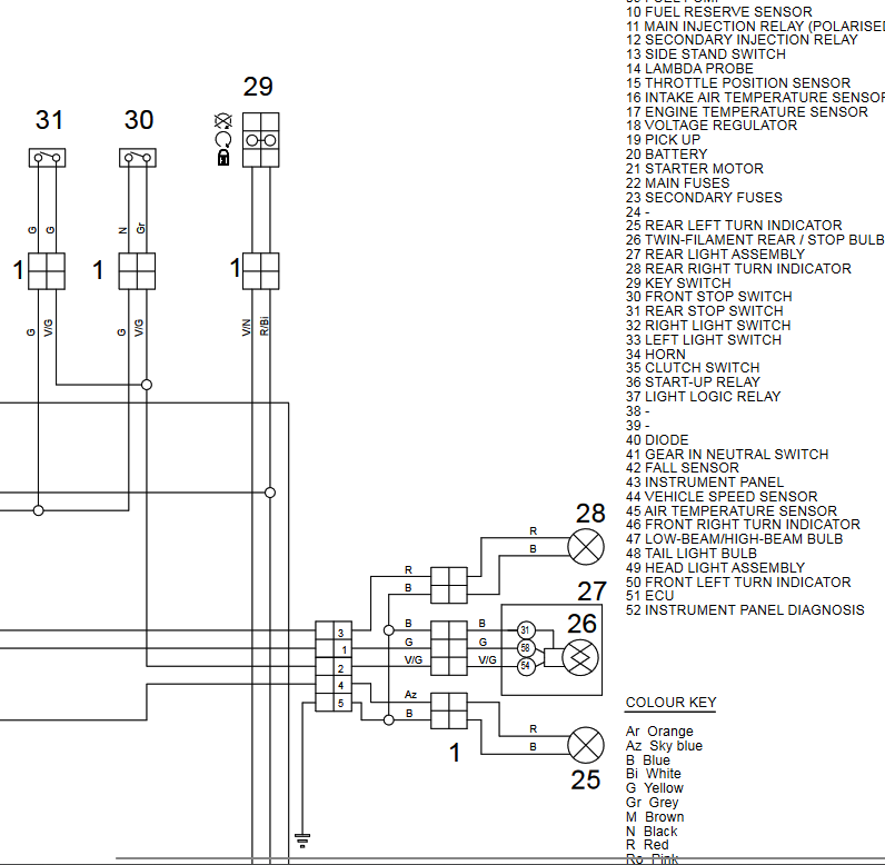

I also saw my ignition switch only has two wires, is this normal’.?
I’ve seen poor soldering at the switch as a potential issue on others, but on the pics I’ve seen, they all had multiple wires (lights, parking lights etc I guess) is that standard.?
And also, I saw that there’s a big chunky wire direct from the battery to the starter, this looks like genuine factory wiring. Is this ‘normal’.?
(Again, I’ve seen the wiring mod others have installed but mine seems not to require this).
Looking at the wiring diagram, the key switch does only have 2 wires connected to it. Number 29 in this image.

C. I’ve replaced the burnt connector on the alternator- reg/rec connector block.
I’d strongly recommend anyone who’s not looked at this connector lately to check theirs.
