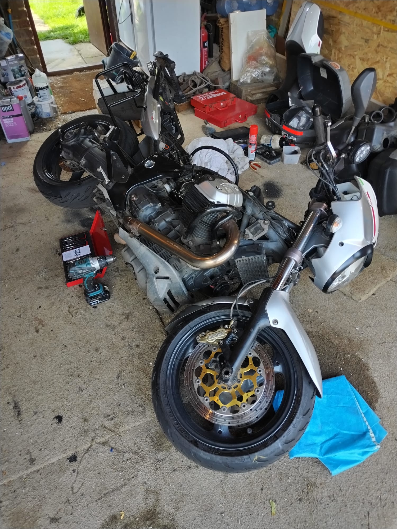

I have recently done the one on my Norge gearbox. As stated above use grease on the drill bit and low speed so as not to throw swarf everywhere. I used a timesert insert and used green loctite to seal the insert in. The wall of the gearbox is not very thick and I do not think a helicoil would hold as well.
Thanks @Mhirst1211! How did you get straight access to drill? Assume norge access is similiar to stelvio
From memory, strung the rear of the bike up with a chain block from the garage roof. I had to remove the offside footpeg mounting plate and the ‘lamb chop’ plate that holds the gearbox and main stand. Exhaust was also removed. This gave enough room to get a clear run at the drain plug hole. Drilled slowly, tapped to size for the insert and counterbored with the tool in the kit for the insert. I fit the insert using loctite hot strength green to insure it was a good fix and oil tight. Hope this helps.
That’s amazingly helpful, thank you so much @Mhirst1211!!!

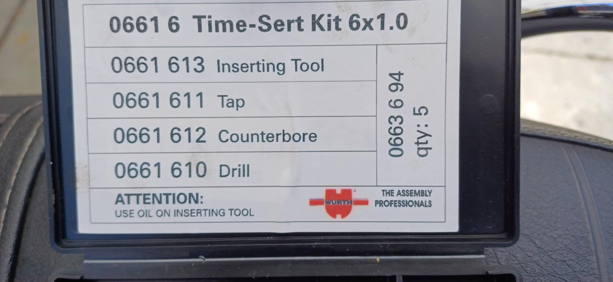

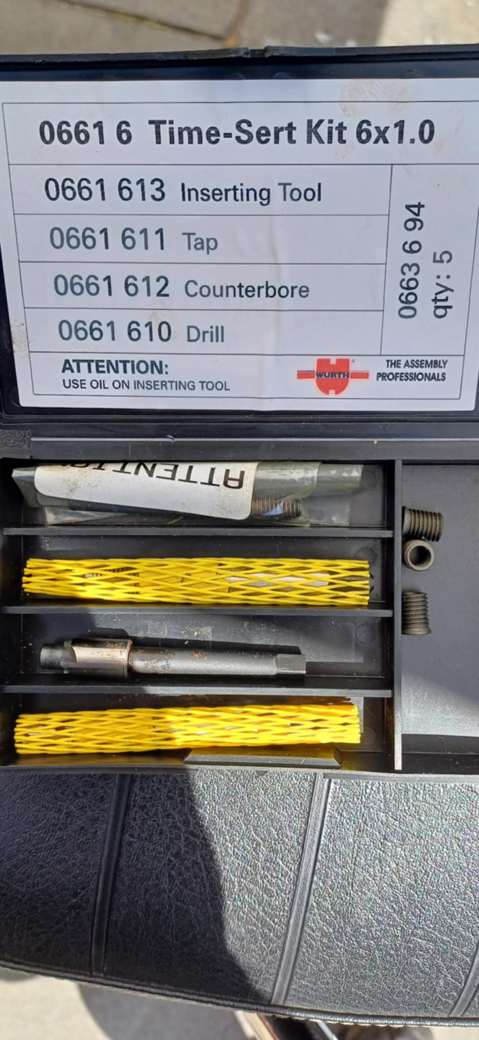

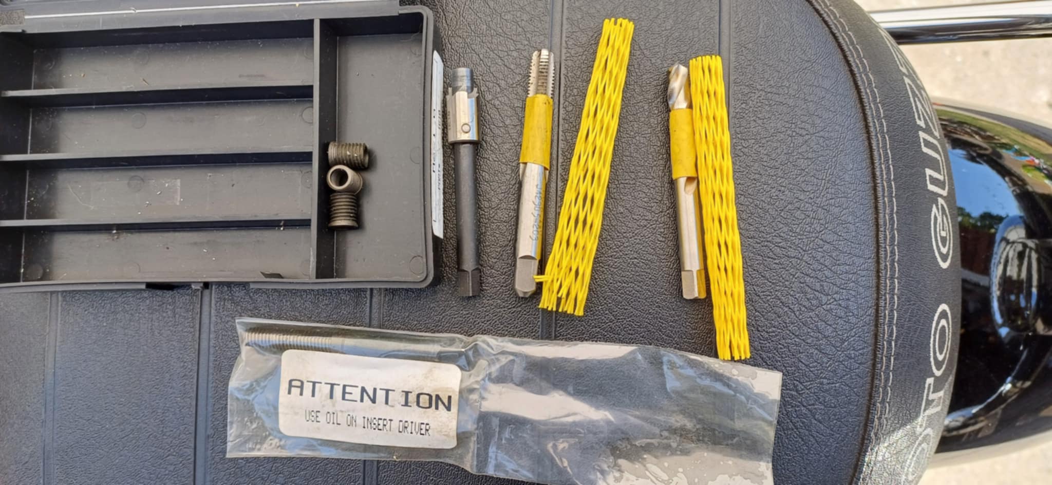

For info.. this is the kit I used to successfully repair the thread after I’d snapped an exhaust bolt flush in the head on my Fazer 600.
Can’t recall what I paid, £35 ish (in 2012).
Thanks @KingOrry, that same kit from Wurth now is £193.66!!
Fer Flips Sake.!!
