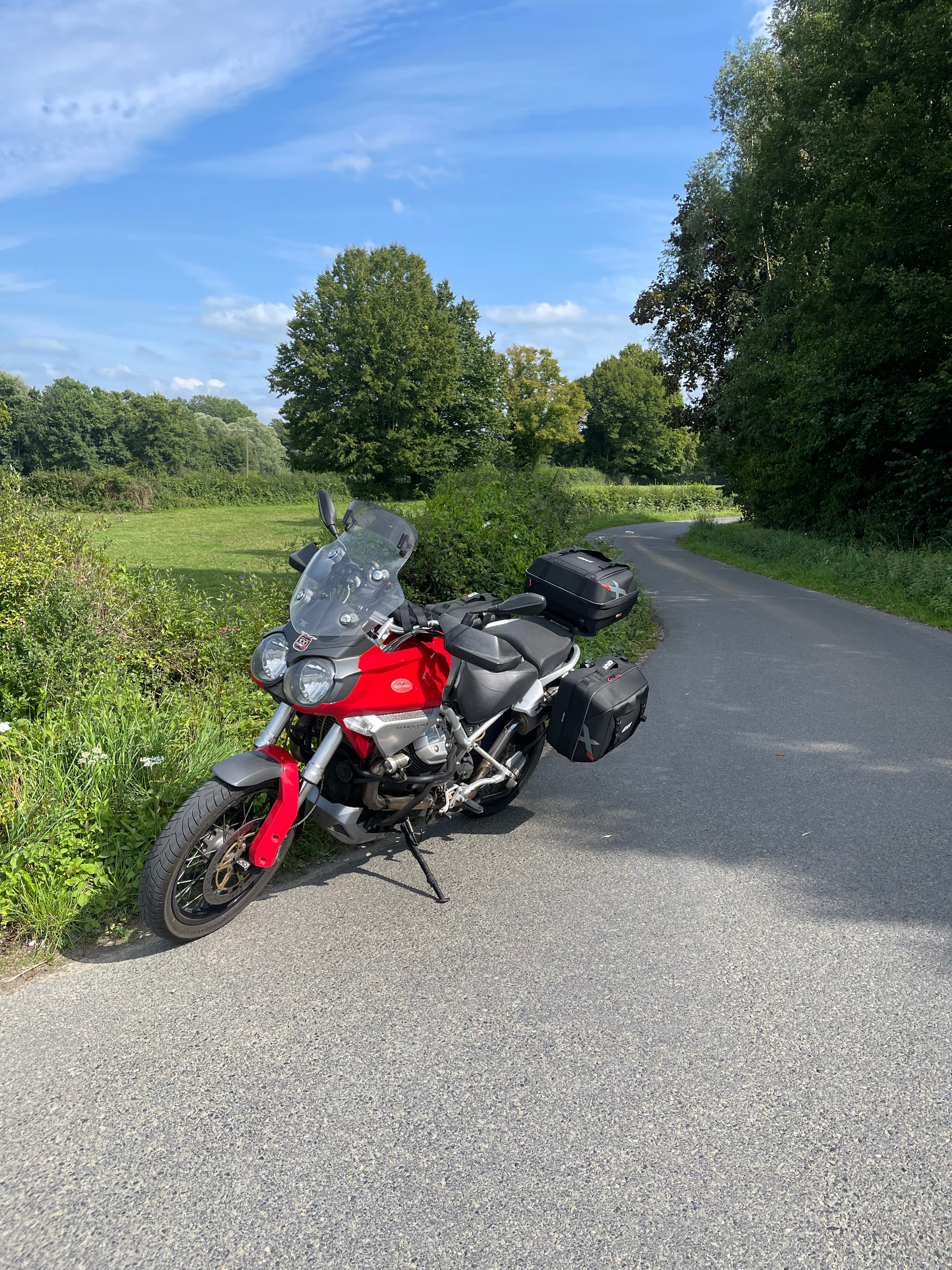

My “temporary” multiple dowty washer fix got me through the rest of the year with to no leaks, including a trip round France!

My leak free French trip

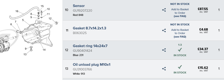

Next question…if this oversized sump plug is the right option to try, do you know the gearbox plug thread pitch by any chance? I would guess it’s M12 by 1.5?
Not off the top of my head, I’ll see if I can find out.

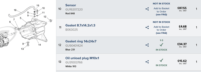

EDIT; M10 x 1.5mm
Oil Unload Plug, as they call it . . .
