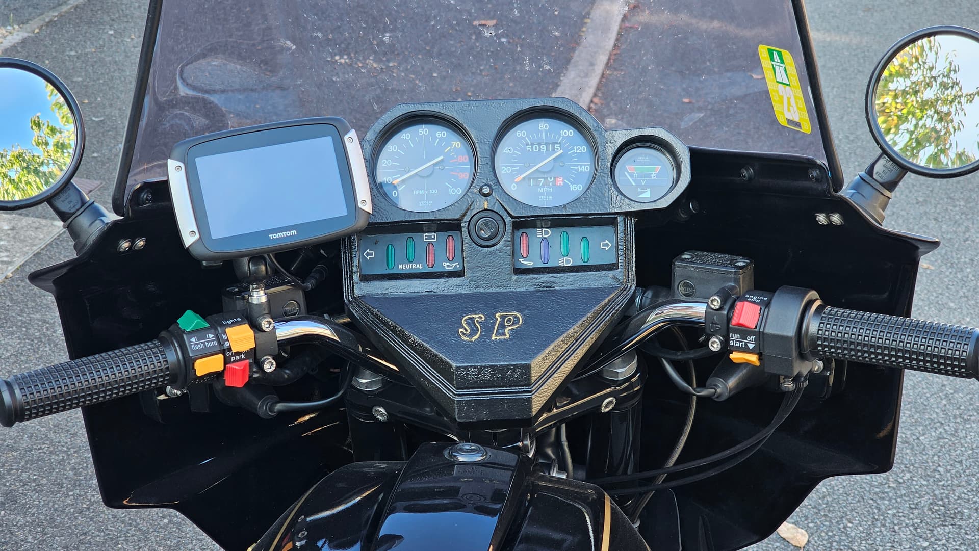

Hi all would like to alter riding position ie bars p o has fitted bar risers so not too bad and I appreciate the fairing can create a problem with some bars,any recommendations.
I have standard bars and there is no room between bars and fairing. In fact I picked up a pair of gloves with the raised knuckle protectors and I couldnt use them as I couldnt get my hands under the fairing.
Hi there yes you’re right it does reduce the gap between fairing and grip,I have some different bar raisers which set the bars further back,so give them a try.
Very interested to see how you get on. An extra 30mm would be very useful. PS Do you think that you can still use the same bolts that hold the dash?
Hi there just made up some new bolts for dash mounts have got to sort out a weird hazard warning light switch which is not wired correctly and then I csn remount the fairing.
