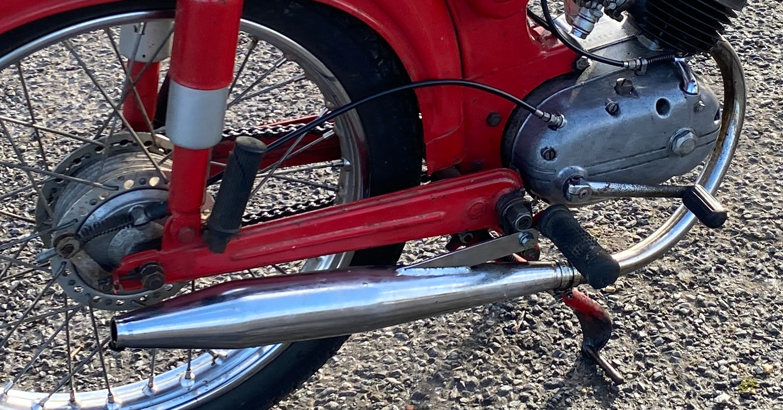

Hi Phil. Rereading these posts, I saw you mentioned fitting a brake system to the battery-less Guzzi moped, Cardellino etc. Is this something you managed to do? I ask as I’m working on a friend’s 1959 Bianchi Gardena 75 that he’s owned since 1961 (!), and I need to do the same thing. He’s decided at the age of 83 he wants to ride it again! Thanks, Adam.

Hi Adam, it took me a long while to get the solution to the problem on my Cardellino 73cc. As you probably know, the Italian Authorities made the fitting of brake lights mandatory in 1963 and the law was made retrospective, hence upgrade kits had to be developed for all the existing vehicles that did not have brake lights as standard. The clue to how this was achieved was in the Owners Manual that warned you not to operate the rear brake when stopping the motor by earthing the points. This told me that the brake light was being powered from the ignition coil and not the lighting coil. This had to be done because the lighting coil could not supply sufficient current to operate the headlight, rear light AND brake light. I eventually took the plunge and added a power feed wire from the ignition coil to the brake light switch and everything works fine. So this may be appropriate for friend’s motorcycle. Having said all of that, your original question got me thinking. What you could do is add a small 6 volt rechargeable battery to your friend’s motorcycle and just use it for the brake light. Obviously, he will have to charge the battery every now and then, but assuming the battery can be hidden away ( in the tool box ?) it would provide a quick and simple solution with no risk. The brake light will also be bright no matter what the engine revs are. Hope this helps. Phil
Hi Phil - I really appreciate the information, thank you. I think the small 6v battery may be the way to go, just a case of finding something on Ebay. Or, with a LED tail/stop bulb, it may also work well with a power feed from the coil. For clarification, do you mean the coil on the flywheel magneto or the actual coil with HT lead etc.?
Hi, in the case of the Moto Guzzi Cardelino 73 I took the power from the ignition coil under the flywheel. I was nervous about doing it as it involved disturbing the coil windings. However all went well. But, although it was the way the factory recommended it as the way to meet the stop light legal requirement it really was doing something a bit sketchy.
I really believe the Six volt battery idea is the safest and most reliable way of going. Cheers Phil

I spoke to my mate and we’re going to go the battery route. However we can’t work out how to fit a brake switch, I have fitted these before to my other old Guzzis and always used a universal switch with a spring. I bought one, and we tried to see how to fit it, but, this brake is enclosed in a cable all the way to the brake drum and lever. Other brakes I have fitted had a brake rod, so it was possible to attach the spring to the rod, so the rod then pulled/actuated the switch spring. We don’t have a rod in this case. Any ideas?
Could you fit it behind the rear shock and rear foot peg mounts and operate it from the lever or the end of the cable?
Or you could use a cable switch like this click here I had one of these on my Triumph front brake, you might have to alter the cable, but with an adjuster you could make it work and adjust the tension of the brake.

Similar on eBay with assembly picture click here
PS here is another one in the UK click here
Thanks Chris. I think currently running something to the actual brake lever itself is the only option, but would look messy, it’d have to run along and be attached to the back of the swing arm. The inline switch could work but then it means getting a new cable made, and then running the power to the switch. Basically, it’s a bike, 75cc, that was never meant to have a brake light, but having owned it since 1960, the owner, at 83 years old, has decided he wants to ride it on the road this year for the first time since 1961!
I was going to suggest a cable switch, Venhill sell them. Maybe get them to make a new cable made with one built in.
