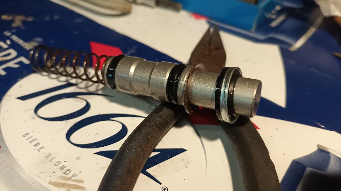

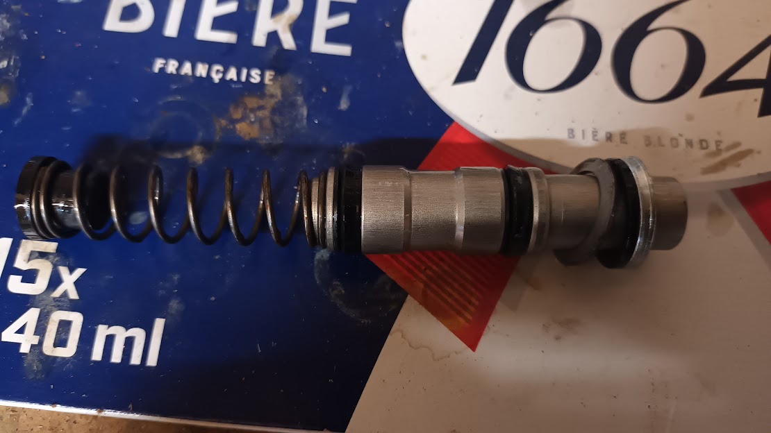

I can’t get the master cylinder to function. Have I got the piston seals etc. in the correct order?
That all looks good. The tricky bit is to get the retainer to lock in place A piece of 15mm copper pipe should slide down and push it into place.

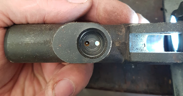

Firstly the 2 small holes in the base of the master cylinder need to be clean and clear so fluid can flow from the reservoir into the brake pipes.
Secondly the piston must be able to return fully to rest against the locking ring when you take your foot off the pedal. There should be a slight gap between the actuating arm and the end of the piston. You may need to adjust the lever pull rod to achieve this.

One thing which I cannot see clearly enough on this pic, the retainer washer, mind, it’s not flat, it’s slightly pressed like dish. If you fit it wrong way, the piston won’t reach the holes in relaxed position, thus won’t take new fluid to make work. The dish should face the piston with its bottom part, if only that sounds understandable:)
Off top of my head, what I see is correct, “dish” allows to push the piston deeper, past the small hole:
Thank you.
I have a dished “washer” then a dished washer with a seal built in.
Should I have both?
I’ll put up more pics tomorrow that show both, and also the master cylinder.
