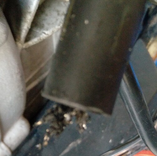

I traced the fault eventually to the rev sensor on the engine casing at the fly wheel. When I removed it, it was covered in crud and fragments of metal. Once cleaned off and put back in place the bike was running as it should again.

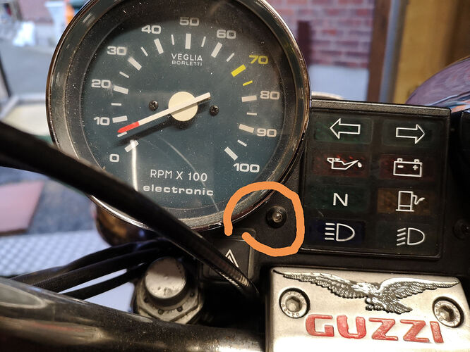

However, I now notice that the ECU lamp is constantly flickering very quickly, albeit very dimly almost in time with the ignition.
My question is, has it always done this and I never noticed it before, or is this something else I need to look in to?

So that’s what it is for :wink:
I haven’t checked the LED, but have a similar problem.
The crud is supposed to be collected by a magnet; cunningly placed so that it is either an engine out job or remove the starter (according to Guzziology). Not a frequent task.

OK. Too confident by a mile! Crank Position sensor was heavily “whiskered”.

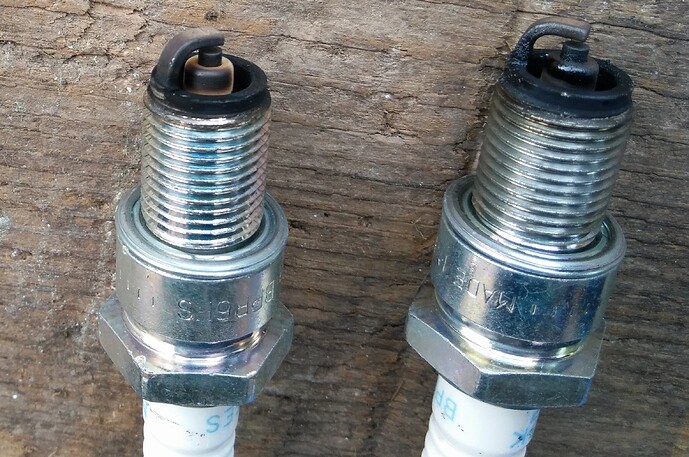

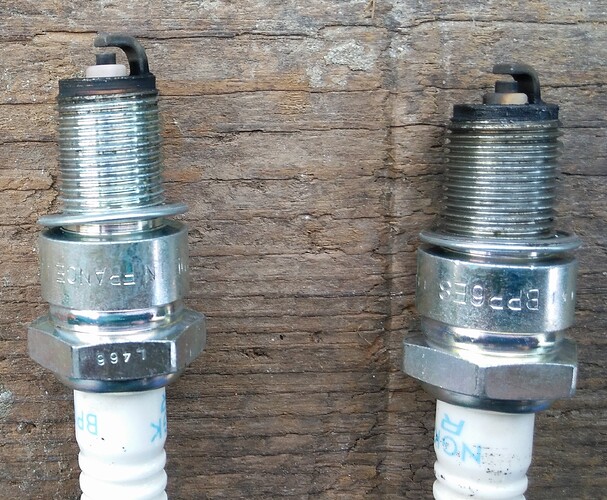

Look at the spark plugs - inlet valve side is black and glazed.
Exhaust side is fine.
Will do a fuel drain & refill and plug change and will report back.
