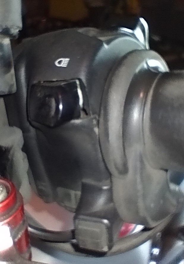

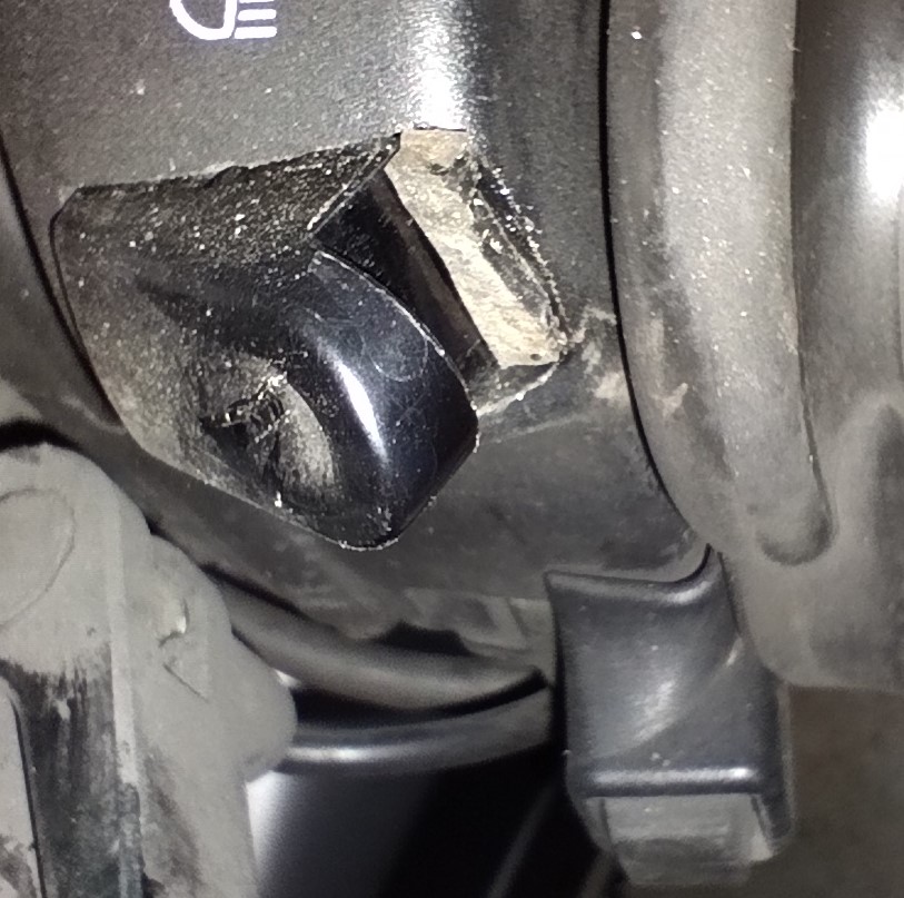

Has anyone got any suggestions how I can stop this button (located at the front of the switchgear) from getting loads of corrosion on the contacts which then stops it working; its the second time this year that I am going to have to clean up the contacts?
Hand guards, Moto-cross stylee?
Or make sure it can drain to the bottom and pack it with vaseline daily?
Not (yet) beena problem on my GRiSO
I have run with the stelvio hand guards for a number of winters and years, but found the hand protection for weather wasn’t good, I still had the pass button problem but not as frequently.
I think I had put vaseline in last time, but I am thinking of trying to make a small rubber shield to go around the button (a job to think about).
Will be looking while cleaning the contacts tomorrow.
Thanks for the suggestions.
Thanks for mentioning this, the new V7 850 has it too, I might look at getting some electrical grease into there. ![]()
