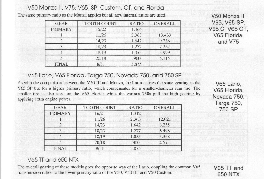

The book gives quite detailed information about gear ratios. Unfortunately my copy is old and so doesn’t cover the newer V7 models. This is an extract of the page on small block gearing to give you an idea of the information available.
I’m sold! The ratios and tooth counts for the primary and all five gears of your second table are the same as I have for the V7, only the final drive is different. I confess, I’m looking at using the engine from a salvage bike for a Pembleton style ‘old timer’ replica using a a 2CV or Alfa boxer (33/Sud/145) gearbox so the final drive ratio is not important but I’ll need to strike a compromise with gearing and wheel size since the idle speed of these V twins is necessarily quite high. Many thanks for your quick and informative responses!
