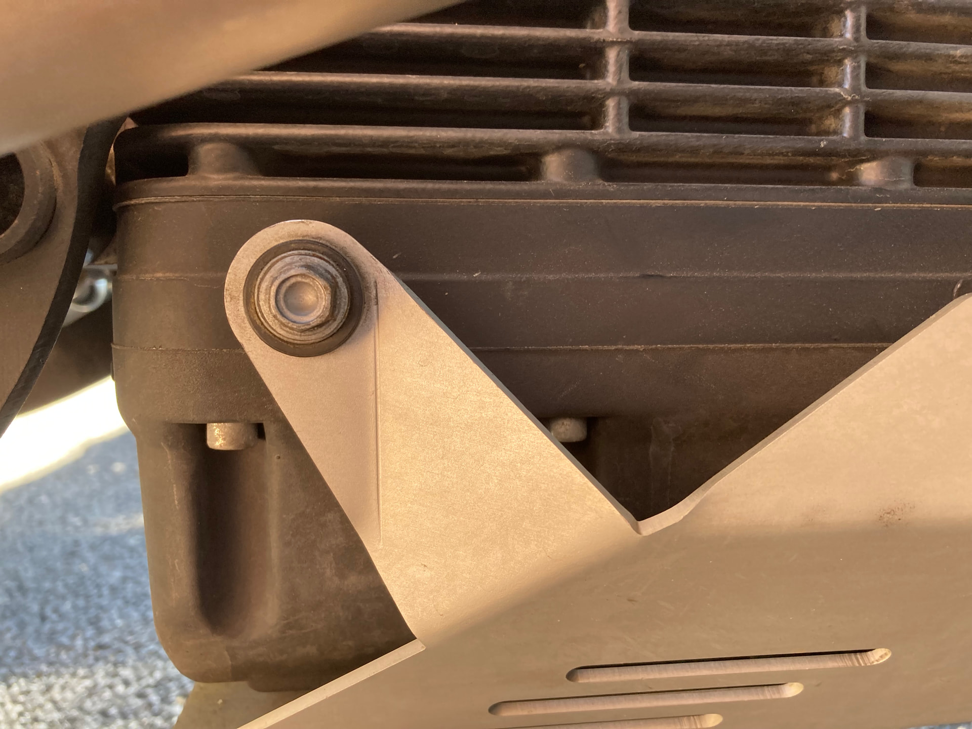

Hi all - Im wanting to order a service kit for my 2015 stelvio NTX 1200 but at gutsibits there are 2 different kits - early/mid 2015 with sump extension or later 2015 one piece deeper sump - photo included - I cant find a pic online of a one piece so cant compare ! Anyone tell by looking at this ? Interestingly if this is a 2 piece,the kit lists NGK PMR8B plugs but mine runs NGK CR8EKB plugs - :person_shrugging:CheersHugh
Hi, yes this is the 2 piece sump. Did this on my 15 model year norge, only recently. You need gaskets GU01003651 and GU05003630.
I also cleaned the strainers whilst in there and put a new stainless bolt kit in, courtesy of gutsibits.
A straightforward and satisfying little job!
