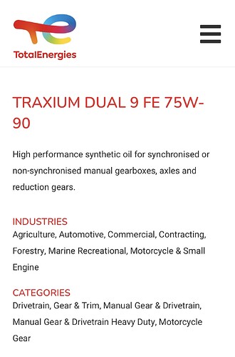

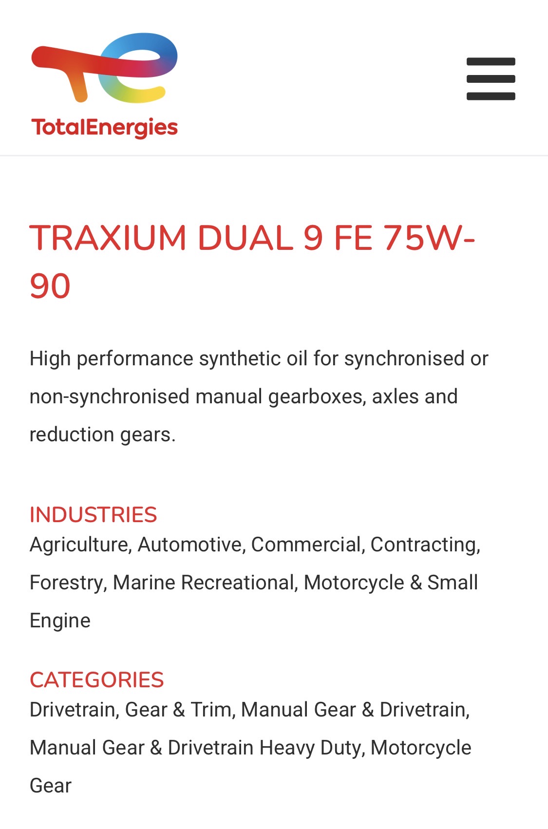

Before doing anything check the level in the box and consider an oil change using this as it’s perfect for v7 or v9 Guzzi boxes. It’s in my v9 and the gears are a lot smoother and predictable since the change.
It’s used in articulated lorry’s that are hauling big loads over long distances so you know it’s one of the best for a Guzzi tranny
Finding neutral easily on these bikes is a known challenging characteristic but since using the Total oil mine is behaving better also

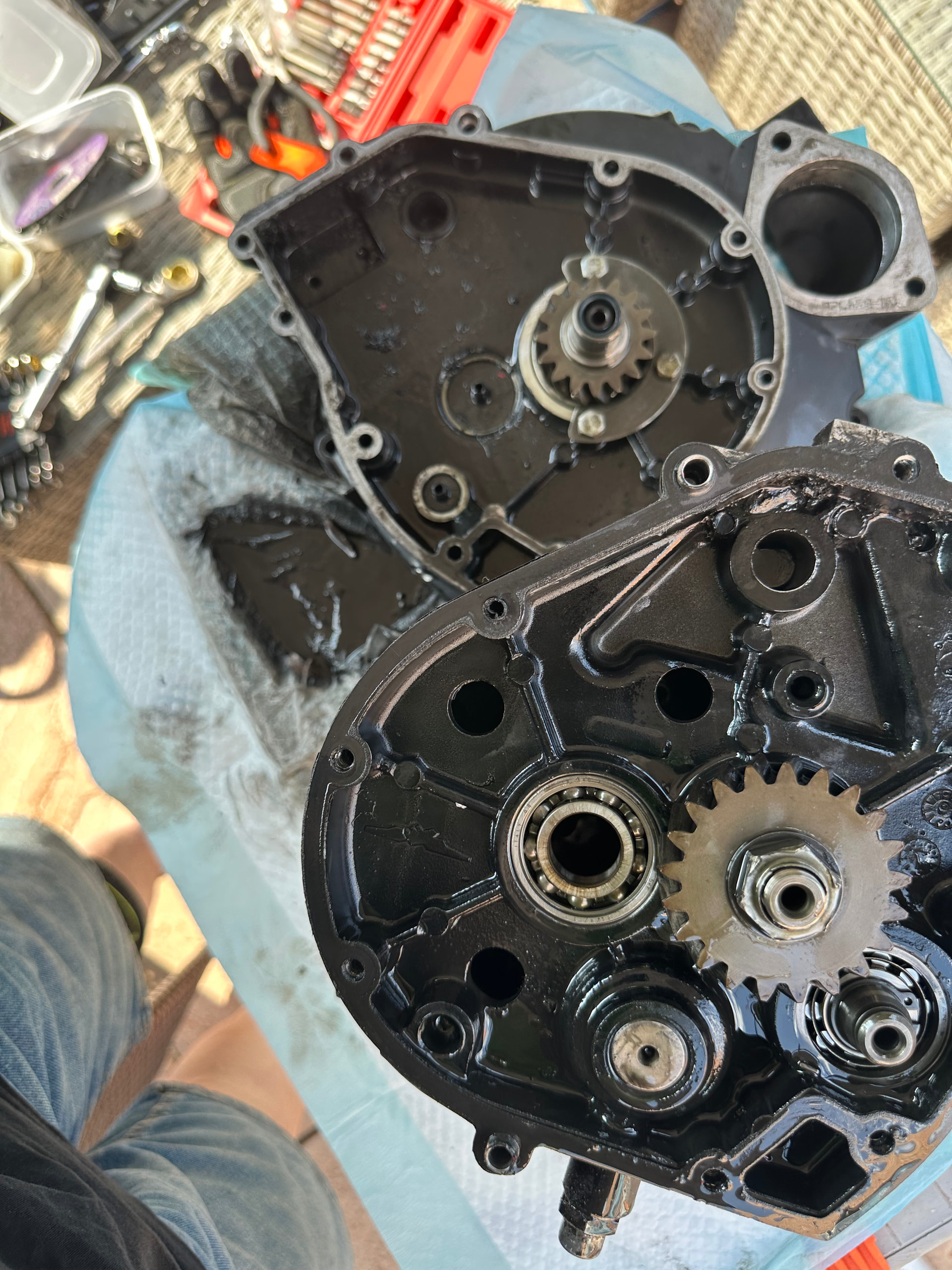

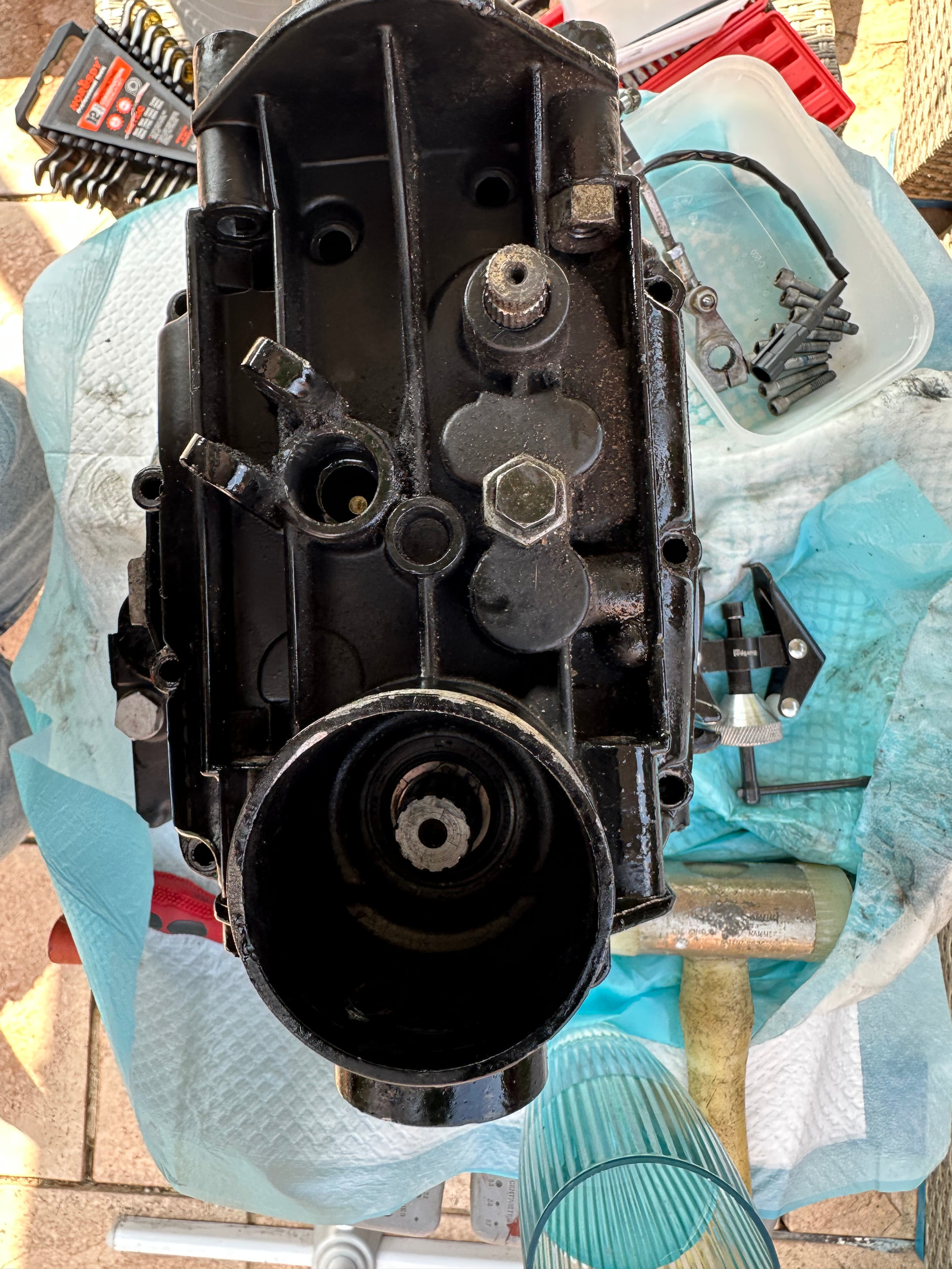

Upon checking the oil levels in the box I found a needle roller so after much ado and frustration ie swearing the box was removed from the bike
The bell housing w a s removed to reveal a thick layer ofswarf and more needle rollers. The input shaft feels notchy and makes a loud clicking sound when turned, I can’t remove the output end case to see exactly how much damage has been caused. The case seems to be stuck
On the output shaft, yes I have removed the
ctrclip from the oil seal, but it is stuck fast so any advice welcome as I have been unable to source a workshop manual, only service manuals.

have you tried some heat and gently tapping with a soft mallet? I seem to remember this working on a BMW airhead gearbox
