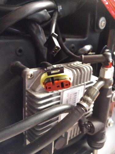

PS is this connector the same as yours? Lonelec asked me to confirm three or four pin.
That’s the one. Three wires feed it.
