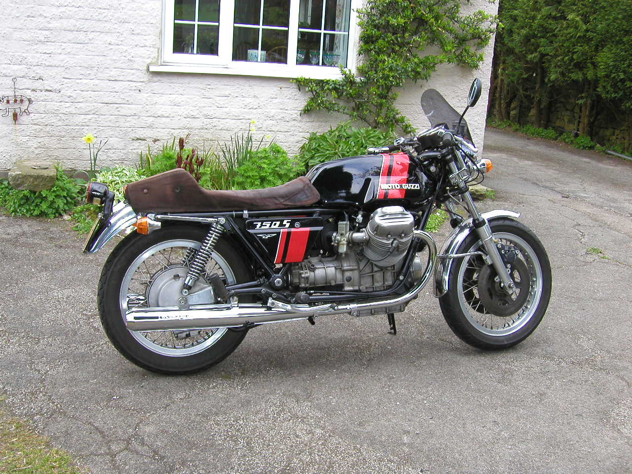

All sorted, a (new old stock) Battlax BT45 100/90-18 fitted yesterday which rides extremely well.
Thanks due to Guy Allott in Buxton who did the fitting - super service and very friendly with it.
Many thanks to all for the comments + recommendations. I took the opportunity to rebuild calipers + replace wheel bearings at the same time. A careful ride out yesterday afternoon reminded me just how good (and how much fun) this bike is to ride. A slow bike by today’s standards but, 100% fun with decent torque, brilliant steering, no twitchiness or vices and outstanding brakes (never mind about things like over-strong throttle springs). And it looks nice too…
