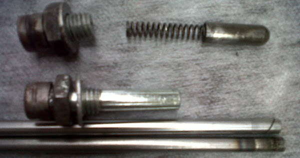

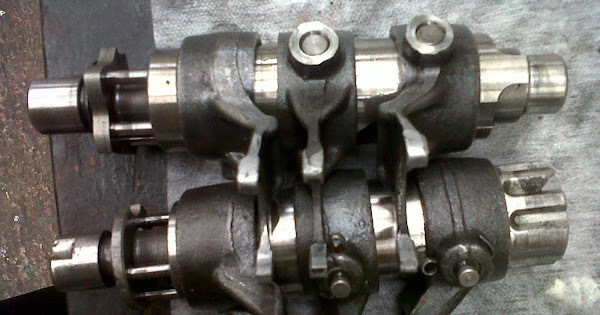

I don’t think swap is that straightforward. Above mentioned pawl is quite a major change, and although - see pic - it seems to be of the same diameters, please note, and judge for yourself, older gearboxes have bullet-shaped “gear stabiliser” hidden under gearbox vent, (bottom right on the pic), while Breva-on generation has this element transferred to the other end of the shaft (top left on the pic). Very old pic and I can’t remember much more. Just be aware of it. And why won’t you just weld that alloy thing?

Thanks for your message. I can see the differences between to and bottom but not the bullet shaped things.
I’ll find out once both in bits.

Here is what will you find under vent screw, at the top of the gearbox. Older one - gear “latch”. Newer one - it’s gone.
It is important to note that the bullet shaped pawl needs to freely move within its orifice to aid easier changes. These gearboxes have straight cut gears and so do whine a lot

This is how the internals are. Original had the 6 bullet shaped indents and the spring loaded plunger.
The replacement had the normal breather with a long pipe. No bullet shapes, instead a separate spring loaded thing operating on the rear end of the selector shaft.
I’ve ended up with the original gearbox casing with bullet indents and replacement input and output shafts.
With the replacement the gearchange was noticeably better with no false neutrals between gears. Now I’m using the original selector shaft the neutrals are there again if I dont select gear hard enough.
