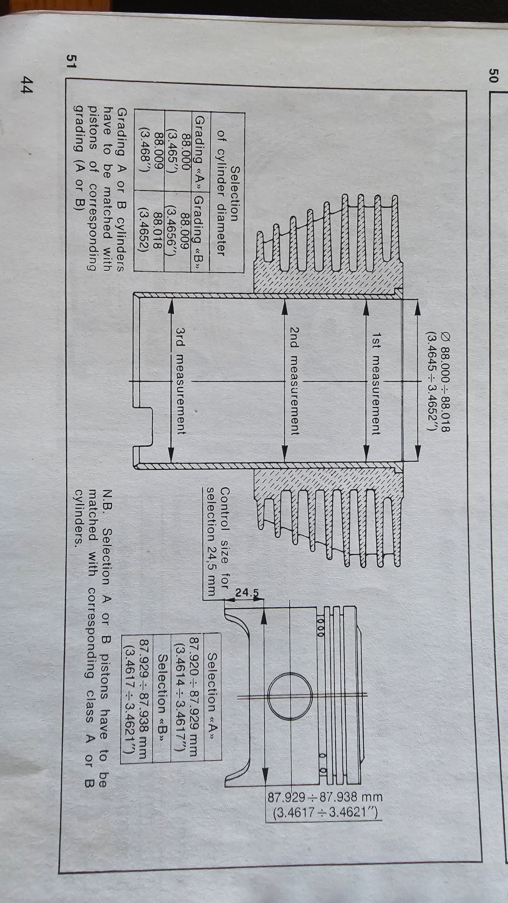

The barrels were second hand, and I had them honed before I fitted them. i’m going to do a compression test and see what the cylinder pressures are like, before I do anything else. I can get new pistons (88 type B) but can find no information about whether Type B is a 88mm + size.
The letters are tolerance grades within original bore sizes, which were used to match up barrels and pistons in the factory. If you have a Guzzi workshop manual the dimensions are in there.
