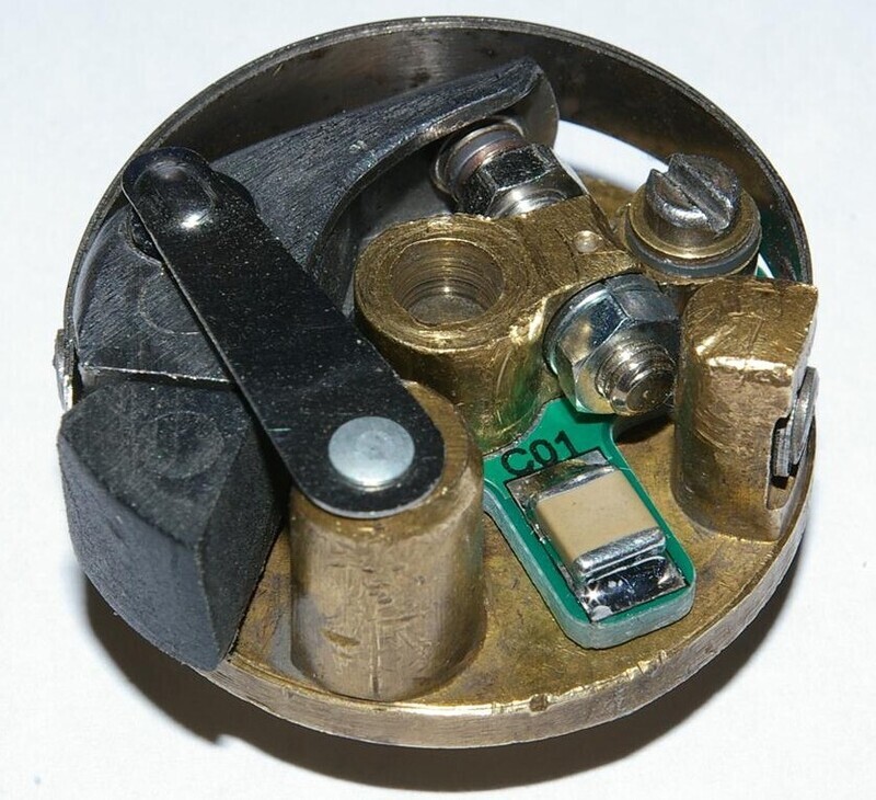

Someone did suggest using a Thor Brightspark unit that is tiny little thing
or mounting the condensor externally like this.

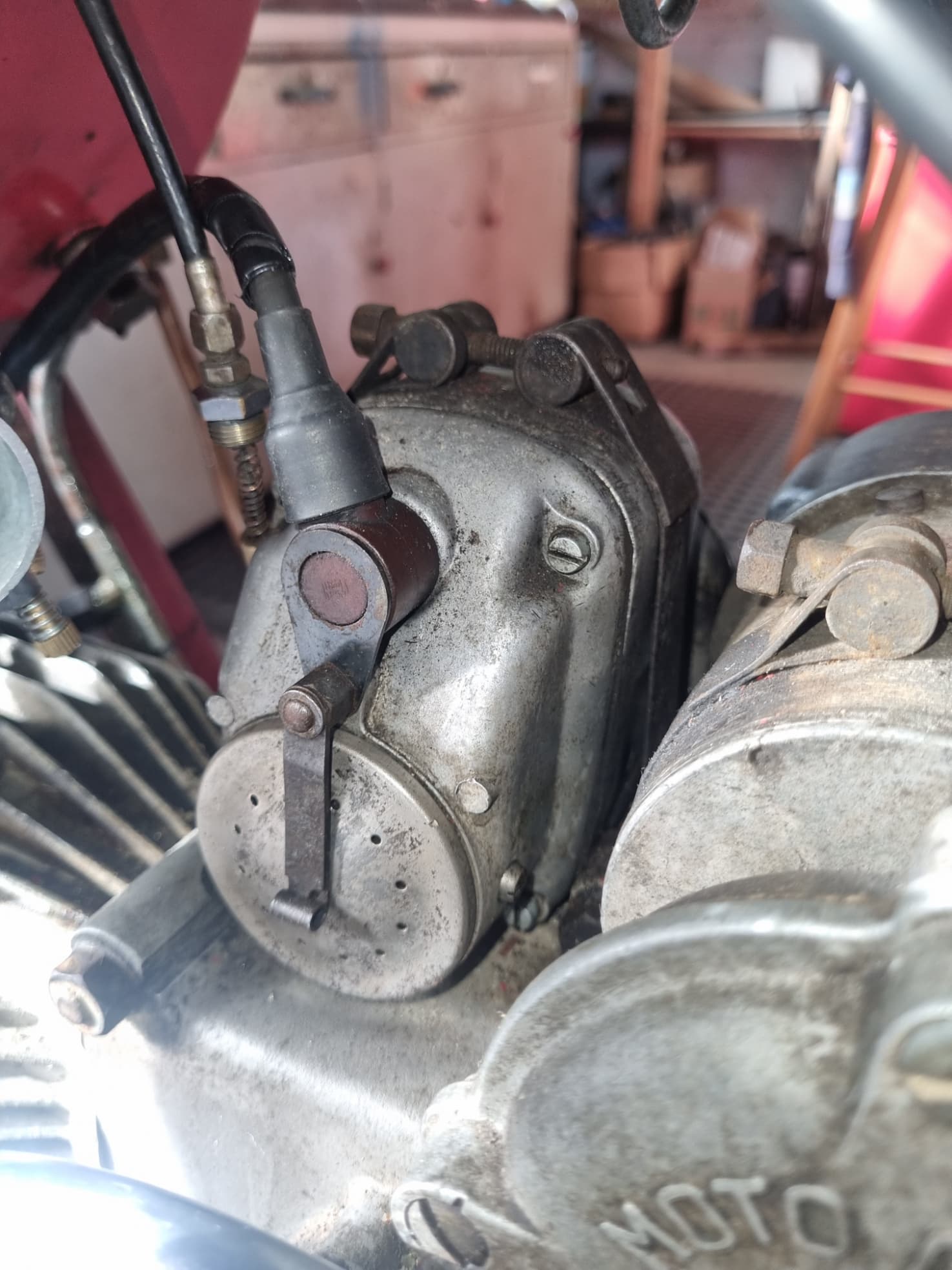

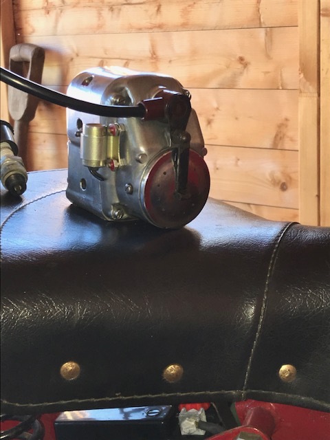

I stripped the mag off the bike today and took it round to my mates who knows a lot more about these things than me. New points and condensor fitted, I just need to refit it back on the bike and give it another try.
It sounds like you have a different mag set up as mine was easy to find under the front cover. Does yours have the manual advance / retard?
Hi Don, yes mine has the advance and retard and is a Marelli magneto.
