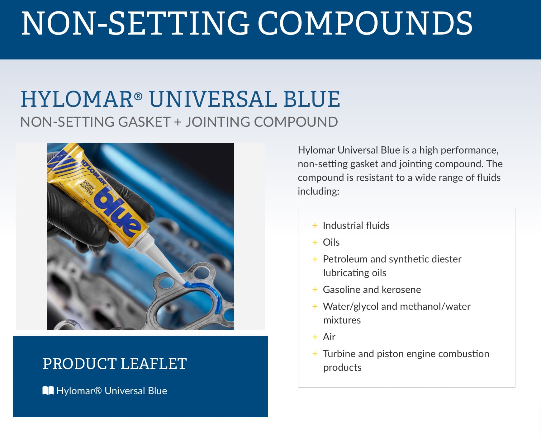

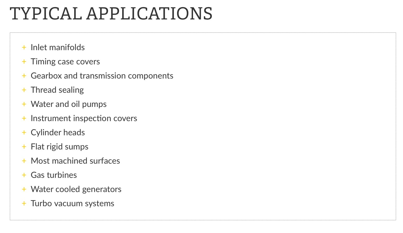

I’ve used Hylomar Blue on low pressure applications, always found it very good, but not sure what’s recommended by ‘hexspurts’.
Their website suggests it’s suitable for various applications including cylinder heads though.
