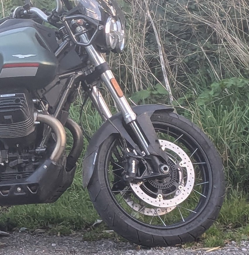

Morning all. I have seen a few people mention fitting an Aprilia front mudguard to keep filth off the front of the engine. (Winter roads :face_with_symbols_over_mouth:), Is there a specific model/year that fits best and can anyone advise me as to how much clearance there is between the tyre and the mudguard ? Thanks in advance.
Mick it is this mudguard
Caponord Mudguard FP2250494 £62.23.pdf (73.0 KB)
And about 15-20mm clearance
Also recommend the Pyramid fender-extenda
Nice one. Thanks.:pray:
Johhny do you know if this is OK for2025 Euro5+ TT model?
A genuine one is available for the 5+ : Front wheel cover for Moto Guzzi V85 TT (24-) - 2S002236 | Moto Guzzi Online Store
Sorry no i don’t but if you are around Bristol you are welcome to come and measure mine
Thank you for the kind offer but I have been told there is an OEM version for my bike.
Thanks Steve. With all the chat about the Caponard one I didnt think to check.
