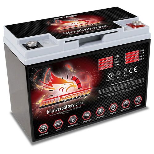

We’ve had great success using the Full Throttle batteries. I’ve been running the FT185 in my LM for over three years now and one of our chaps has a FT230 in his 1100i Cali that survived serious abuse. The rectifier diodes gave out, the battery was shorted to ground for 5 hours, causing a fire, but the battery came back to life and is still starting and running the machine fine, a year later.
I should say, though, that these are AGM batteries, which is why they can crank these engines with significantly lower Ah and smaller packages. But that does mean that they have different charging requirements. They need 14.8v to get to 100%, rather than a conventional 14.4v. They also degrade quite quickly if left at anything less than 100% charge. The safest thing to do is to occasionally plug them into a charger with an AGM setting to boost them to 100% charge. In practice, I find my Bosch alternator seems to be keeping it topped up, perhaps because the regulation is sufficiently rough that it gets voltage spikes which lift it to the AGM charge requirements.
