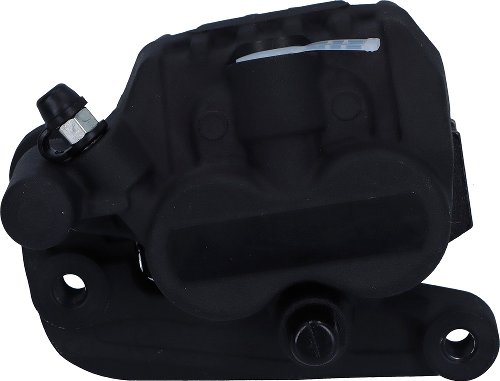

Hi I bought a V85TT in Rosso 1 month ago and love it.
The rear bake was terrible so I investigated and it turns out the slide pins on the caliper are seized solid :frowning:
Looks like a new caliper is required (2B000525)
Any recommendations on the best place to purchase it from
Cheers
Stu

Can the caliper not be stripped, cleaned and rebuilt?
Not sure yet my friend is going to try
Separating the 2 parts of the calipern
Tomorrow with a hydraulic press.
If it comes apart hopefully I can clean
it up and put it back together
Thanks for the advice :+1:t2:
My friend is going to try and separate the 2 parts of the caliper tomorrow with a hydraulic press so it just depends if he can get them separated without destroying the caliper.

Hi, just read this and I’d be careful with that hydraulic press? If not in a hurry I’d suggest remove all the calipers intact and leave them to soak in a basin of petrol or at least a good spray down with penetrating fluid left for a day or more then try tap, tap, tap around with a ‘light’ ball peen hammer and see what loosens up? A refurb kit if you can find one will be way cheaper than new calipers? Prolly get one for less than a tenner. Excellent time to blow the pistons out and a thorough clean, new seals etc. The pins are not a precision part really and might get away with some emery work but some refurb kits include new ones. Plenty good youtube vids out there on how to. It’s a really satisfying job to do but maybe you are happy starting with new?
Soaking in petrol is not recommended. The piston seals and the bellows seals around the pins are unlikely to be happy. Gentle compression in a vice or press with plenty of wooden packing would be my choice. 40 tonnes in a hydraulic press from the word go will be catastrophic. As soon as you have some movement it will go eventually and then you probably could do with new pins.
I have bit the bullet and I’m going to have a new caliper fitted and the rear brake bled as I’ve tried everything to bleed the brake with no success.
£320 plus vat from a main dealer which I feel is worth paying to get it right
Just had a silly thought! (I do that a lot!!) I don’t know how old the bike in question is and I am new to Guzzidom but, I hope these are not monobloc M4’s? :disguised_face:
A lot of my experience of bike refurbs has been on Nissin types for which you can replace all the seals and pins. On checking today I see that Brembo do not even give an option for refurb kits for the V85?? No option but replace the complete caliper? Jeez! I’ll be giving mine some serious TLC!
£85 for a 2022 caliper on your favourite auction site. But I am a cheapskate ( if the gentle application of a vice hadn’t worked on the bloody thing ).
I read somewhere on this forum brembo no longer do refurb kits, due to some incident that happened, can’t remeber details.
I had the same problem when I was restoring a Ducati earlier this year. I couldn’t get refurb kits for master cylinders. There are some kits about, but not for modern stuff.
