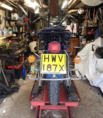

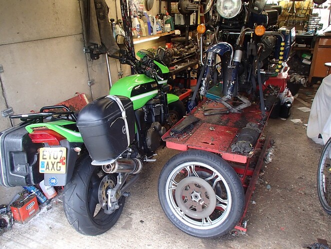

I can’t advise on the make of mine as I’ve lost sight of that. I can say that it is a heavyweight model, has good width with turned up edges. There is a wheel clamp at one end and a sliding removable hatch at the other to aid wheel removal. I think these features are both worth looking out for. The ramp is removable for when I raise the table which gives me better room to get round it in my garage. Also, mine is a scissor action so it raises within its own footprint.
Whilst some of my bikes do feel heavy to me now when wheeling them around the yard, with a short straight run up to the table I find no problem wheeling them up the table and onto the ramp. Once on, if the bike has a centre stand then that and the wheel clamp are good enough to hold it. For prop stands only then I have a couple of straps that hook into holes in the table.
I keep a bike parked on it ordinarily, and having a number of bikes on the fleet there is often one going on for work. It felt like a bit of a luxury when I bought it but it is a real game changer for service work – I cannot stress that enough. Changing that spin off oil filter that Guzzi cunningly hid inside the sump? An absolute pleasure. Seriously.
The main issue for me has been if I want to put a bike up on the table backwards, for when I want to drop the front wheel for instance. That is a lot more precarious when I’m on my own. To assist that I bought a 240v supply cable winch with remote operation – so obviously needs a power supply. I mount that up in the bench vice that lines up with the end of the table then use that to pull the bike up whilst I guide it.
Pics attached of some works in progress. One with Blue reversed on clearly shows the removeable hatch. The ramp also clips on at that end, you can see it leant against the wall behind my Rexxer in one of the shots.
