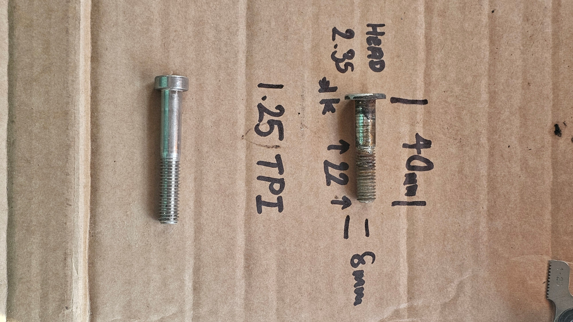

My Cali has wobbly MudGuard and I have tried a number of options to hold the thing down, but I am at a loss???
the outside has a bolt and this is roughly about an inch long and hold the plastic part on, I got a much longer bolt in the hope that it can go through, but it only goes in so far.
I have tried coming from the inside bu it does not seem to want to go in?
I have tried a num,ber of various bolts, but I just dont seem to be able to find the right parts.
Does anyone know what is needed to fix the rear mudguard properly?
This is the correct bolt for the rear mudguard and go in from the inside.

The pic of the bolt… ok thanks of course, but what size is it? I will keep on trying LOL

As it happens, I decided to take my mudguard off today to treat the rust. Until I saw Niks post I thought that the head of the bolt was a weld nut and I was convinced the was a bolt under the relflector , which I was about to pointlessly rip off. Thanks Nik.
Note this is not a standard bolt, it has very thin head. I show a ‘standard’ shallow head bolt for comparison. Westfield Fasteners stock these.
