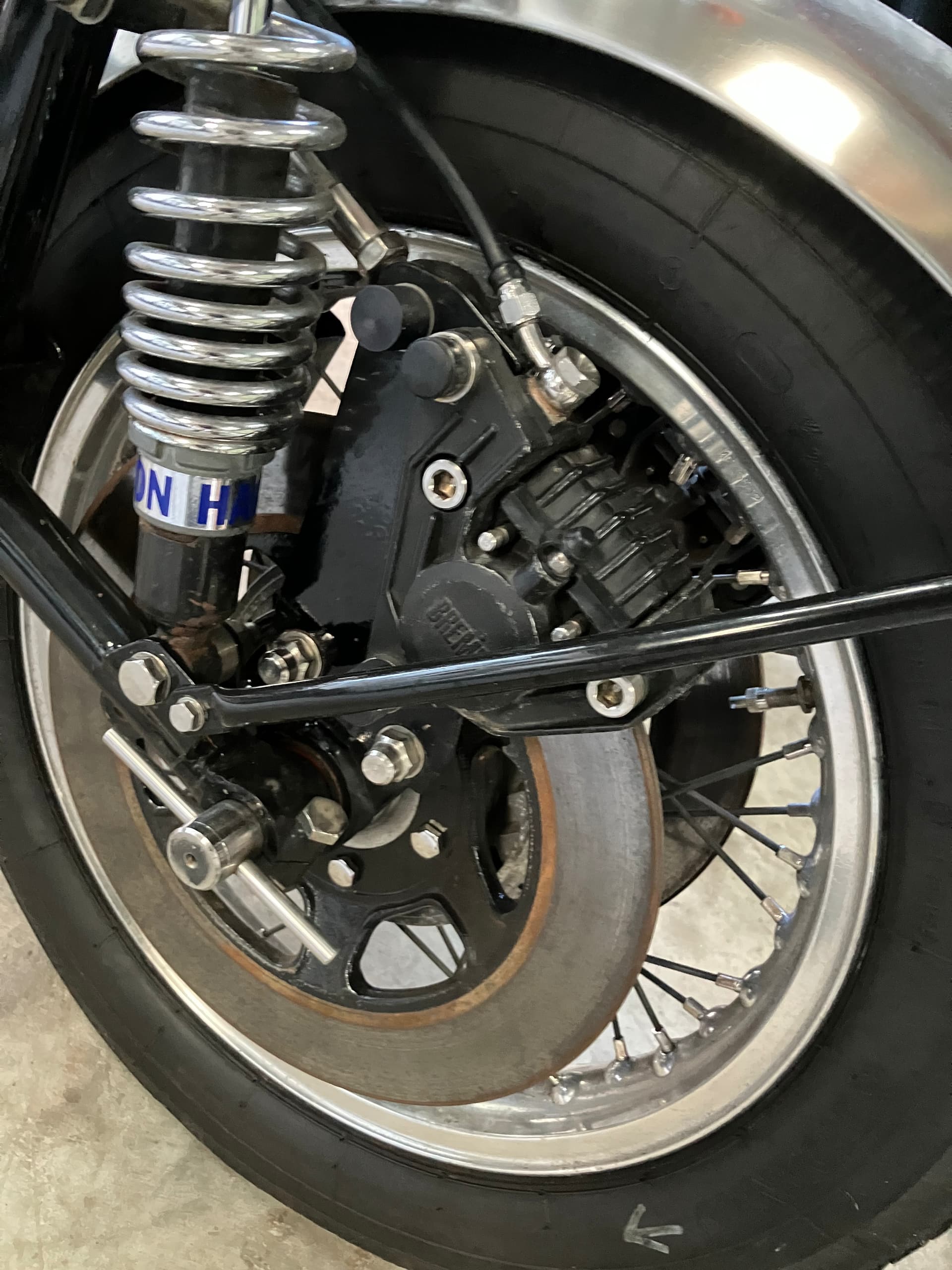

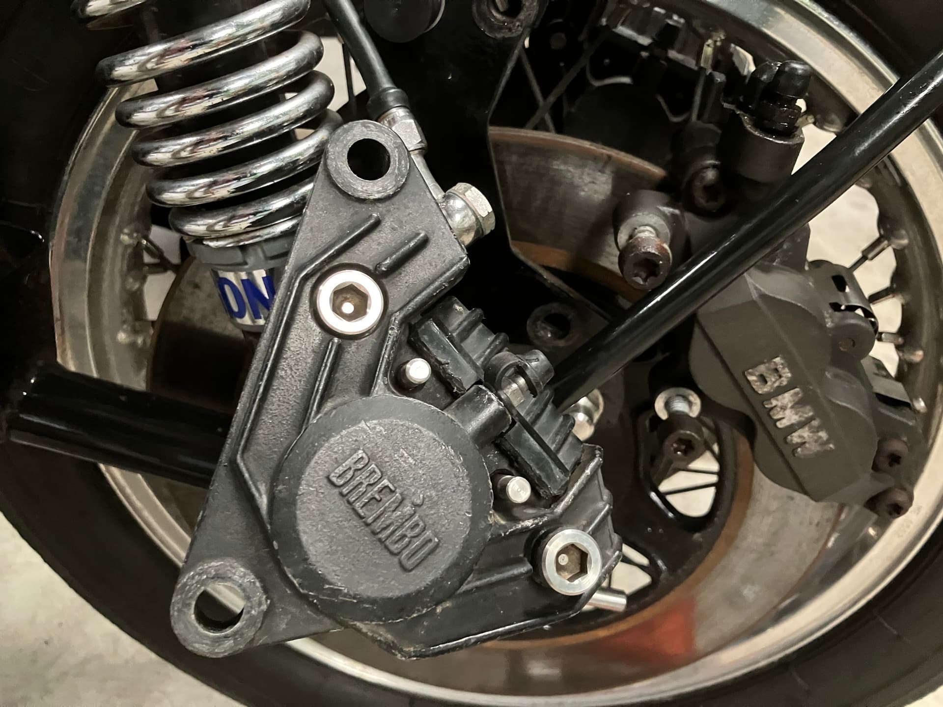

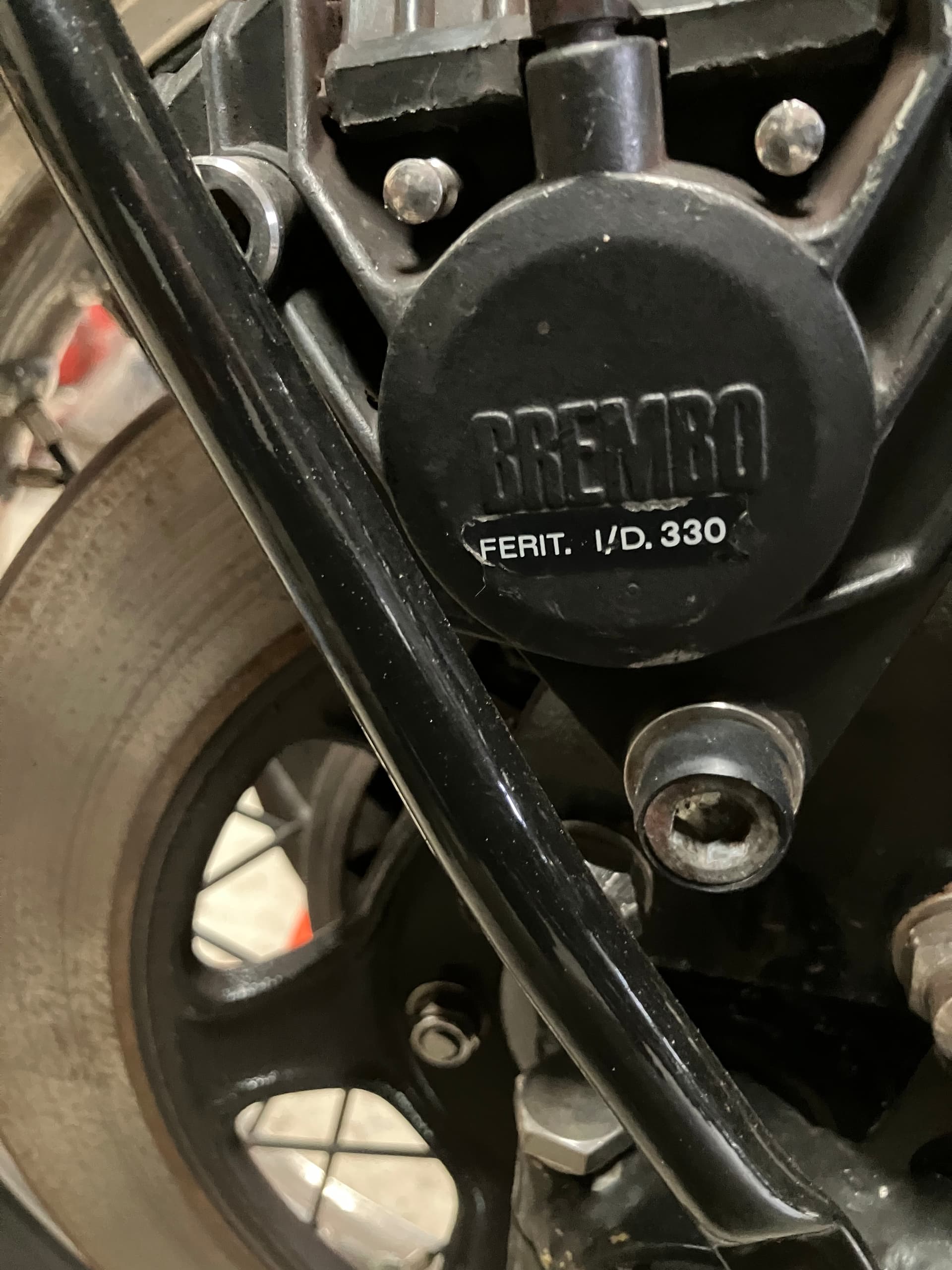

Been slowly improving bits on this sidecar combination but need better brakes. The linked foot brake working the near side front and rear discs is good, but the offside front brake is wooden and inefficient. I like the look of the Nissin front master cylinder that was fitted by the previous owner but have been told that it’s 14mm barrel is unsuitable for operating one brake calliper, and that I’d be better with an 11mm brake master cylinder. my question is whether I’d be better delinking the brakes to have the current Nissin operate both front brake discs (if that’s viable) or, source a smaller 11mm brake master cylinder; which I’m struggling to find. Anyone got experience of an upgrade or solution?

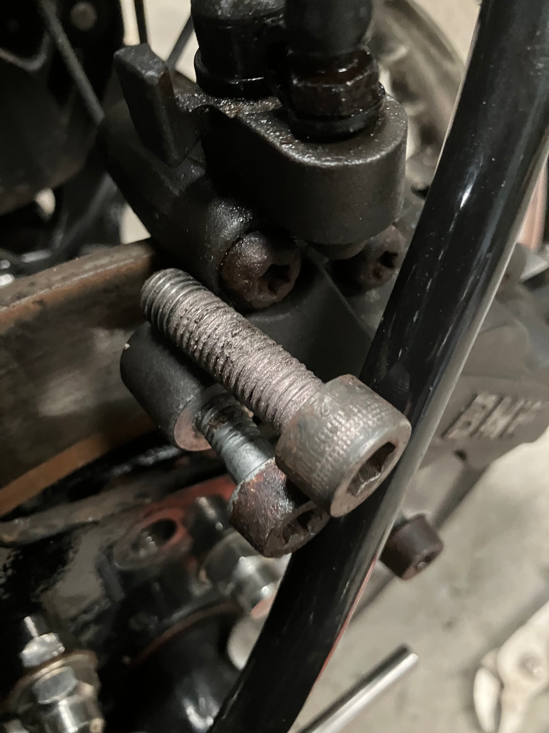

The second hand calipers from an R1150 came today.
Unfortunately the mounting bolts widths are way out from the ones on my Guzzi. 66 mm apart for the BMW as against 110 mm for the ones on my T3 derived Moto Guzzi. The other issue is that to bore out the BMW threaded mounting holes to accommodate the Guzzi mounting bolts, I would be dubious over it having adequate remaining material to take the braking forces.
Either I have different brake calipers to the standard T3 (P8?) Guzzi ones or it’s a different BMW brake caliper that I require.

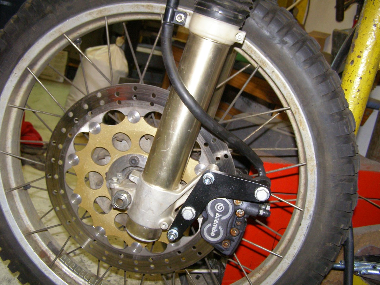

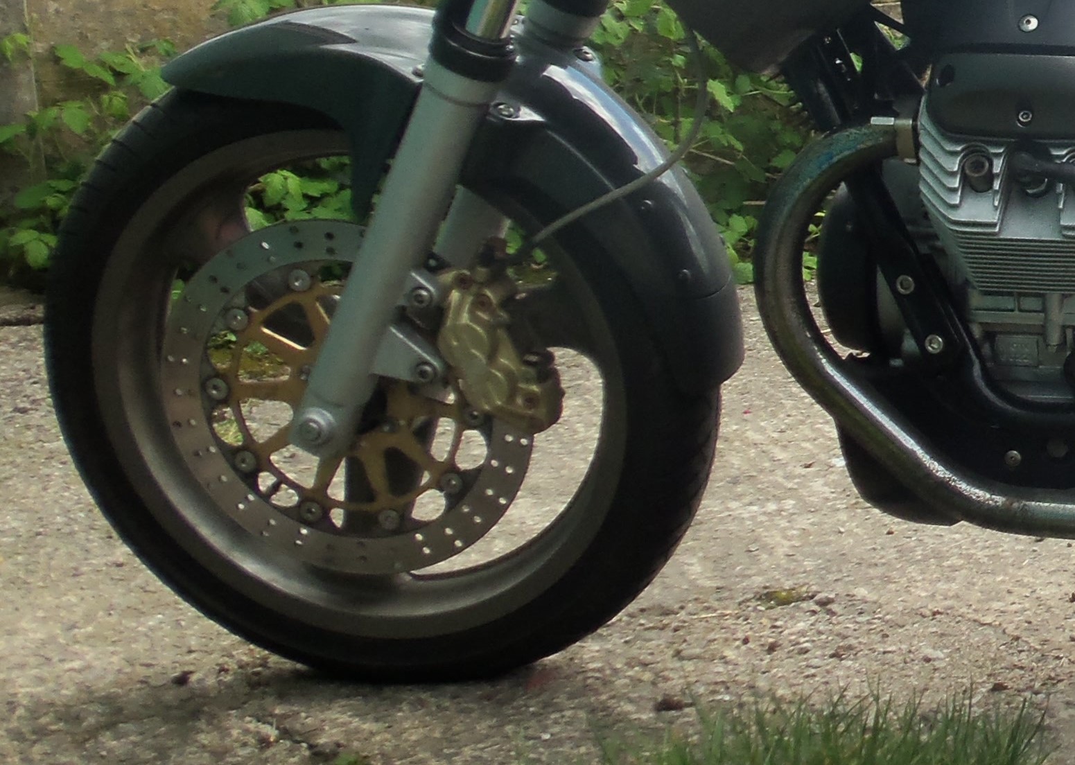

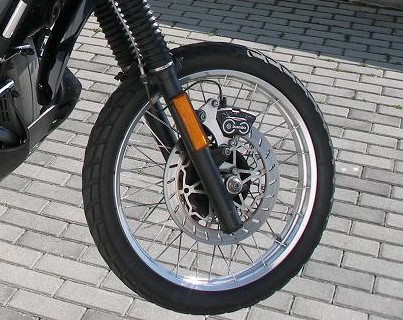

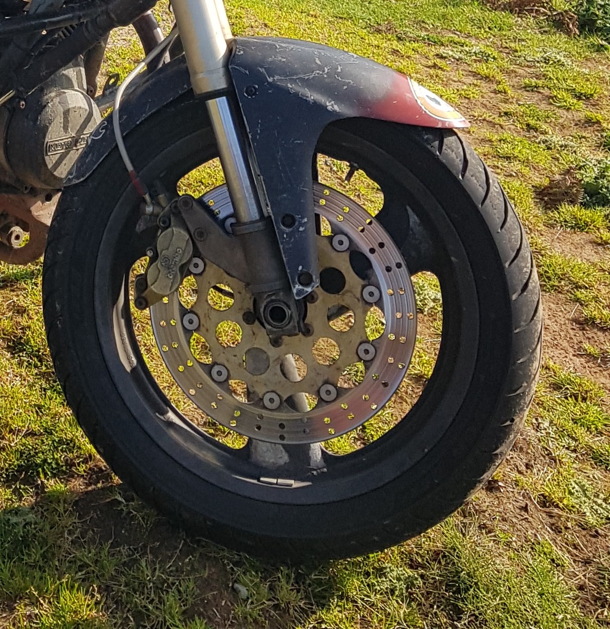

Don’t loose hope. You’re already away from original with that sort of forks; here is the picture of my R100GS, where I decided to use factory wheel, but with much bigger disc - and all is hanging on entirely different fork from DR-Z 400. Yet the outcome is to say least - satisfactory! Also other pic of my mate’s GS with factory fork, hence o/s disc layout. As you can see, a bit of cardboard design job and all can be sorted.
Thats the wrong Caliper! I guess i should have been more specific. The Caliper shown in ‘adamigo’ picture is the correct one!

Are those brake calipers in your pictures off an 1100 BMW rather than the later R1150r BMW?
Are they front brake calipers from a K 1100 BMW or an R or GS?
Do you reckon that the original brake discs could be used rather than upgrading to thinner stainless discs?
Are these the ones in your pictures that share the same mounting spacing as the Tonti front calipers?
just asked a friend with an R850 (that appears to share the same calipers as the R1100) if these are what I’m after regarding the mount spacing to which he’s replied in the affirmative, so will chase one down.
I do my questioning too, so hopefully will come back here tomorrow as well. Calipers are defo R1100GS, possibly others too.
The one i used were from a BMW R1150 GS

Good news and bad news. 1100GS caliper shares same holes spacing, but watch out: my biking friend who is an engineer with degree in hydraulics says, those 4-pot ones are 5 percent weaker due to total piston area, than P-08, standard ones. He says there’s no point what-so-ever to do such conversion! It all only looks better… You may turn your eye to Ducati/Cagiva/anything modern-ish Italian calipers, which I find extremely efficient, and with some abovementioned carboard design work you can get where you want. There are two types on,say, older Ducatis: one of them with 65 mm space between the holes, other one with 40, I can’t remember more but you’ll find them cheap on eBay, all golden ones. Not sure if Breva 750 uses something similar?

Calipers arrived so did some measurements this morning. Mounting spacing is good, but with the leading link forks the carrier plate needed a bit filed off. I will also need to centralise the caliper by removing or reducing a spacer on the carrier plate.
I now understand the maths and ratios relating to the master cylinder and the brake caliper to acquire decent feel and better brakes. I’m told the necessary ratios are between 20/1 (hard lever) and 30/1 (softer/more progressive) but still usable and workable. Anything below 20/1 being too wooden and unusable, and anything higher resulting in the lever being too soft, having too much travel or having no brakes.
My present 2 pot caliper has X 2 33mm diameter pistons with a combined swept area of 1710 mm. The master cylinder’s 14 mm bore gives a swept area of 154 mm.
Dividing 1710 by 154 gives a ratio of 11.10/1, so is practically unusable and explains my desire for improvement. I struggled to lock up the wheel on gravel using the hand lever.
The master cylinder is newish and the cost of upgrading the calipers with the larger pistoned traditional looking ones is high, so the £80 for two uncorroded and good looking 4 pot Brembos seemed a better option.
Using the new to me 4 pot Brembo with it’s total swept area of 3424 divided by the same 14mm Nissin master cylinder’s swept area of 154 will give me a vastly improved ratio of 22.23/1
