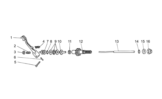

Just found this - 2 and 3 are the adjuster but probably best left alone.
http://sparts.aprilia.it/Marche/guz/Cataloghi/GU07503/GU07503_13.gif
eyebem2014-01-07 21:37:06
Look at the parts list here, and scroll down to the clutch lever diagram. The adjuster is clearly labelled. The other thing to check is that the pivot on that lever behind the gearbox - which gets all the crud from the back wheel thrown over it - is free to pivot and has not seized up.
So it is, virtually identical to the Tonti version.
