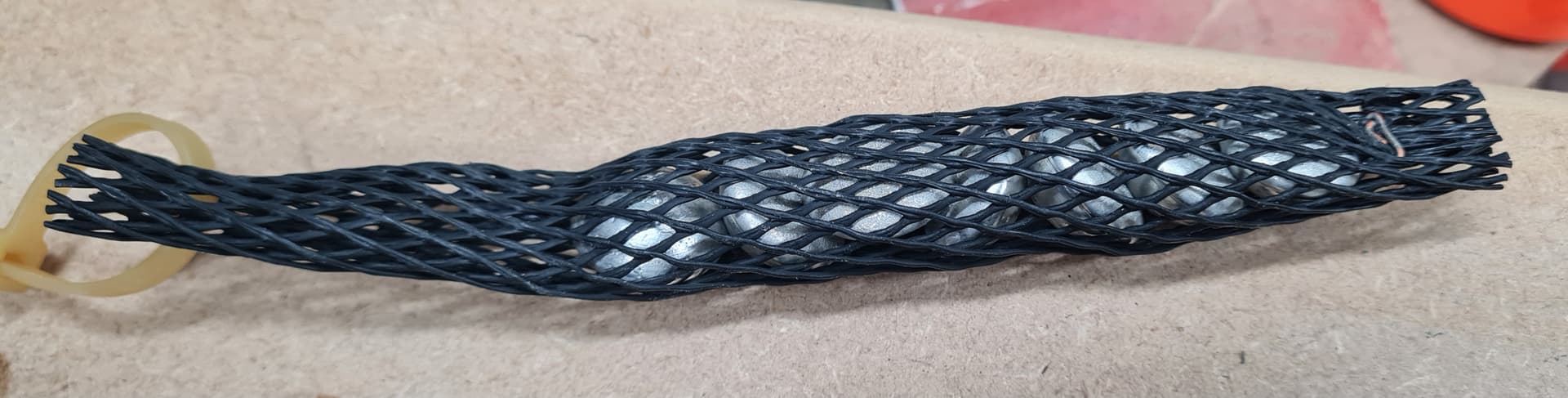

Found this in my fuel tank, any guesses?
Yes its utter rubbish
that fat cockney bloke of wheeler dealers is always punting them for classic cars as a lead replacement substitute !!
modern Guzzis do not need lead replacement fuel
chuck it away
I wont use them in my classic car, because they dont work, something to do with low octane fuel supplied by the russians in WW2 causing the Merlin engines of the Hurricanes to run badly and eat valve seats, to be honest anyhting Russian is rubbish anyway ( My Uncle Sid did the Murmansk Convoys there and hated the place , tetra ethly lead was a 1920s invention to boost the octane rating of fuel and to prevent knocking ( pre ignnition)
Japan has never used lead in the fuel, so all japanese engines will run without it
most modern motorcycles will run without it
however, I have found that due to the government morons messing about with our fuel, modern fuels do not provide enough power, so I avoid E10 at all costs as it damages the fuel system and makes the bike run like a sack of bolts ( got caught out in Flanders once and I though I had wrecked the engine)
so only use E5 or the high octane stuff
and avoid supermarket fuel
i use either Shell or BP
my works vehicle is a very very high mileage ex police vehicle, always run on shell
emissions are perfect and economy is excellent
