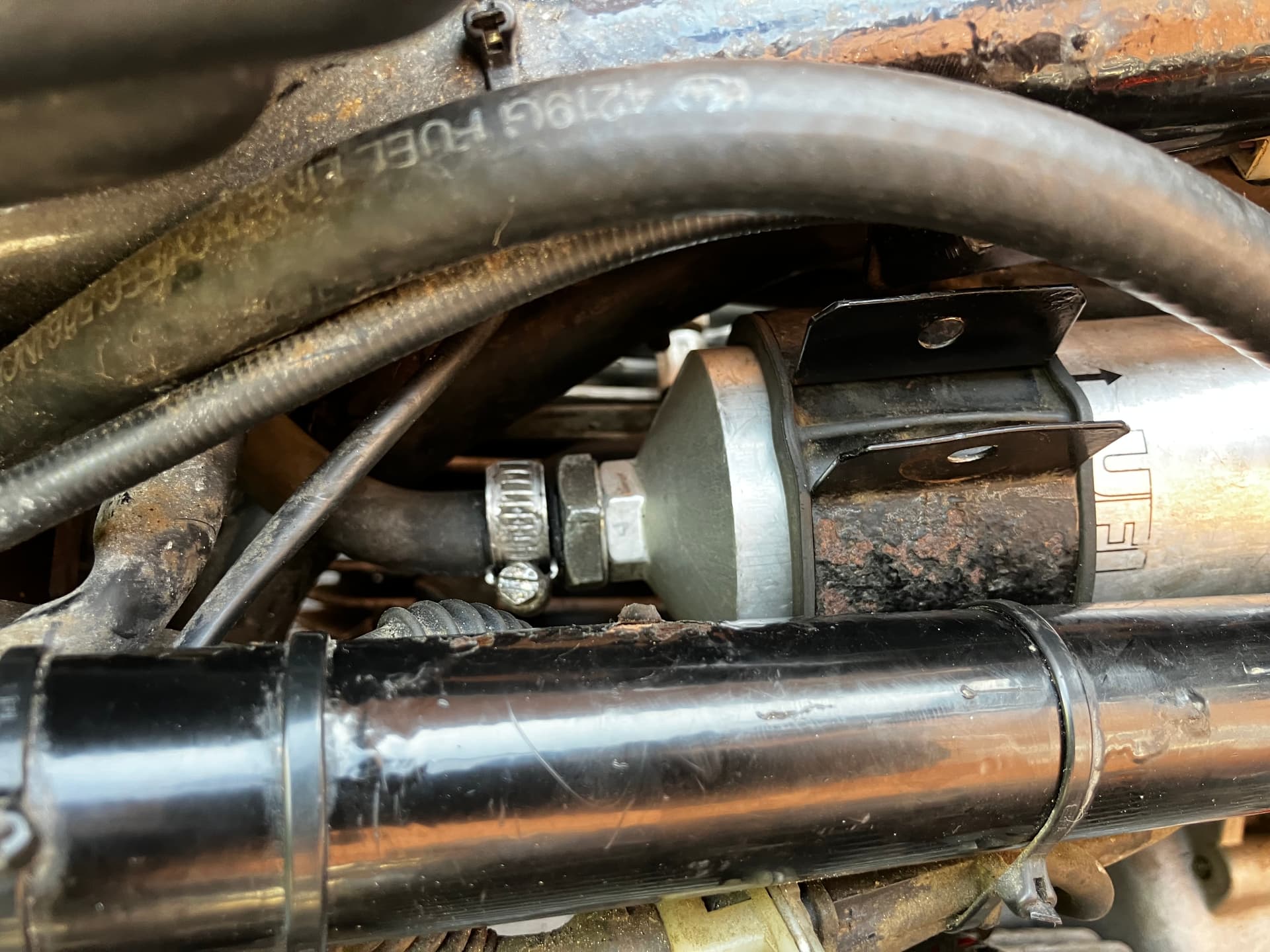

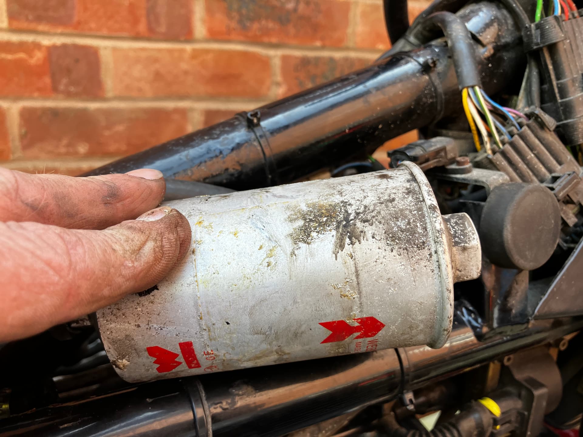

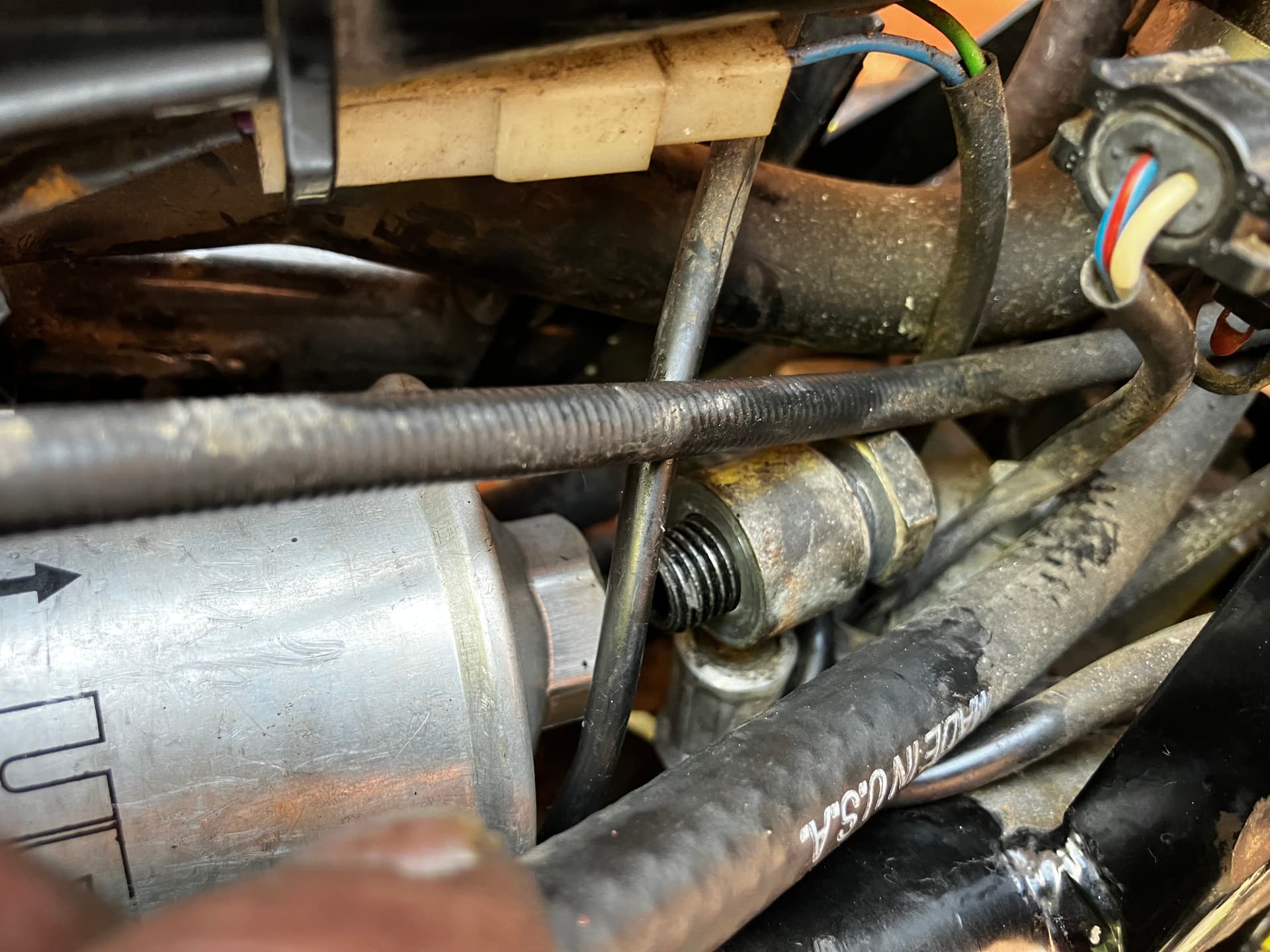

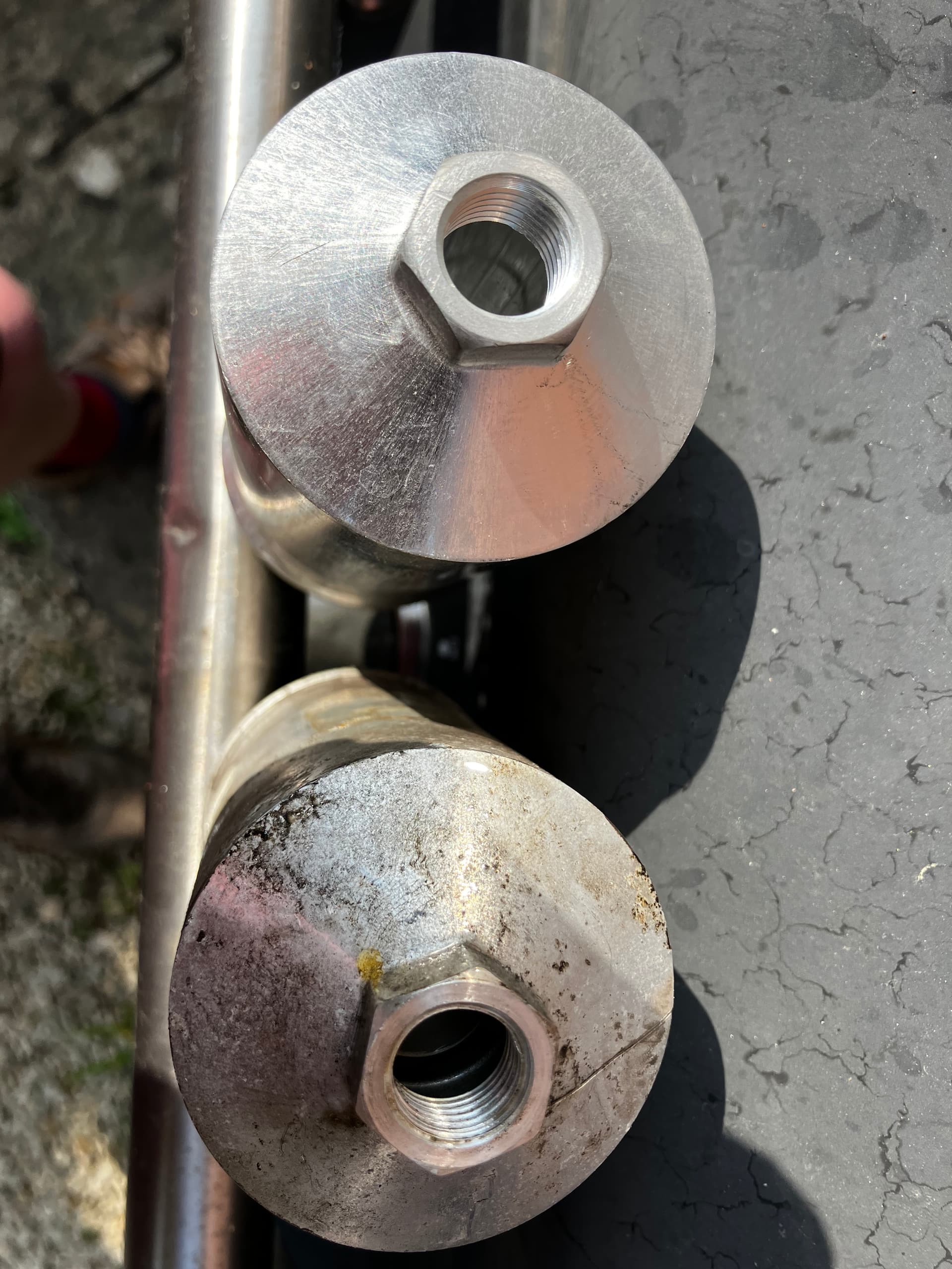

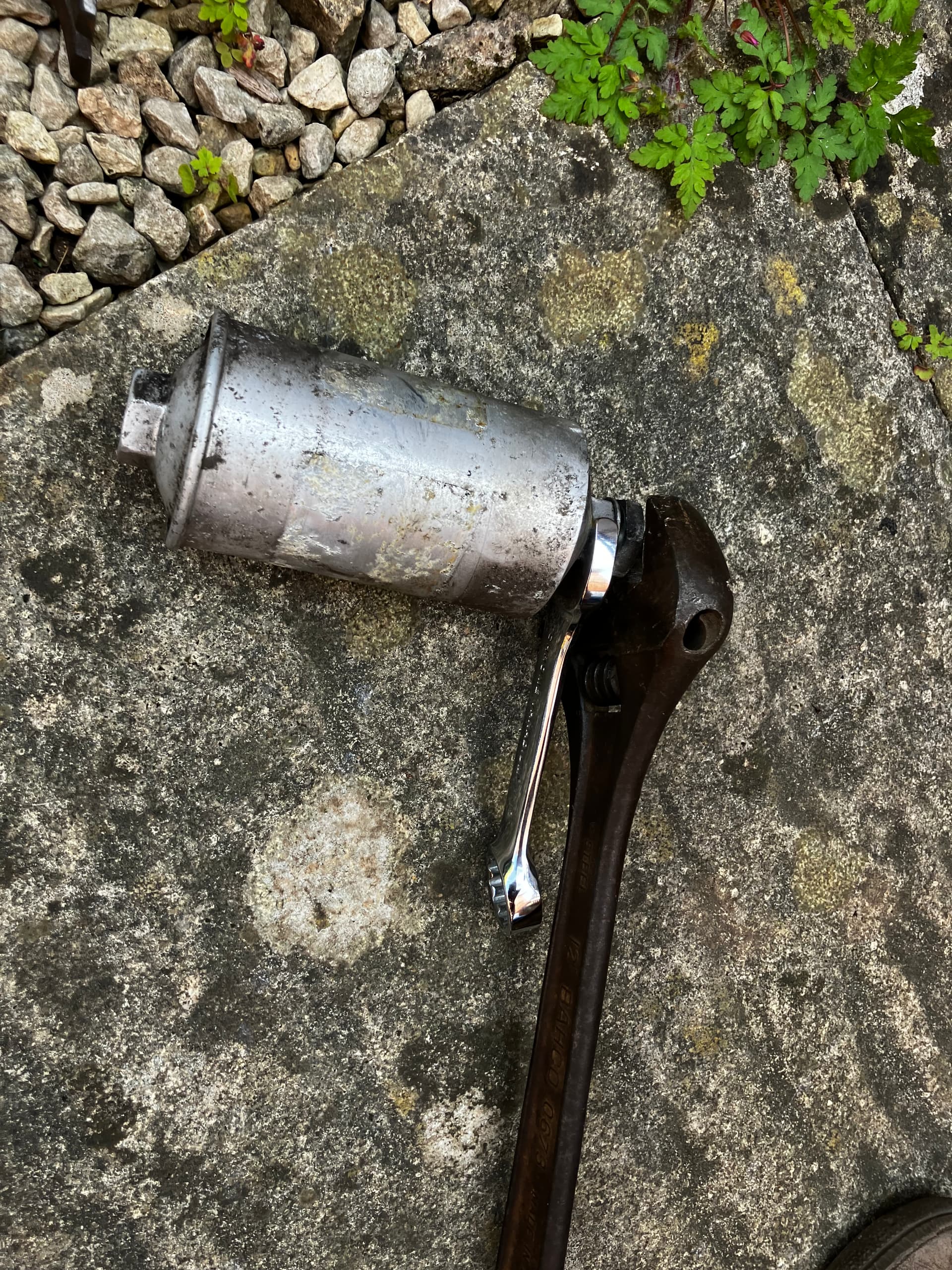

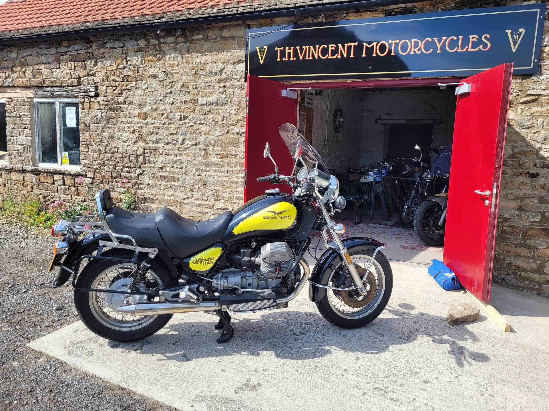

The sun shone Friday afternoon so got the tools out and sorted out the fuel filter and replaced the checked relays - few photos - the guide / forum on how to sort it helped loads - there’s not a lot of wriggle room but I found offering the end of the filter towards the opposite cylinder head and then twising through 90 degs does the trick - the same with the filter clip - the pattern part has a different format to its internal layout - but when back on the bike the fuel flowed as expected - i took off the rear connector on the floor as it woulnt budge on the bike - you need a 22 /19 mm spanner and a hammer if its been on a while , I reckon this Webber item is the original filter
Did it cure the fault?? - NOOOOH ! - the bike idles lovely abut wont take any throttle whatsoever - at least its here permanently now and not intermittent - the relays open the circuits to the fuel pump and ECU - so to have an idle they must be operating correctly to open the circuit as desired .. so - where to next ?
Hello Paul, yes that filter is exactly the wrong size for the slot isn’t it!

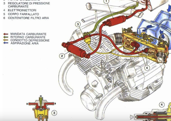

Bike has gone to steffords at Worcester - their older boys are Guzzi trained from when they were a dealer - its the fuel pressure regulator thats failed and I’m informed its now out of stock as a part and I need one urgently - can any members out there offer words of wisdom or help finding a solution ?

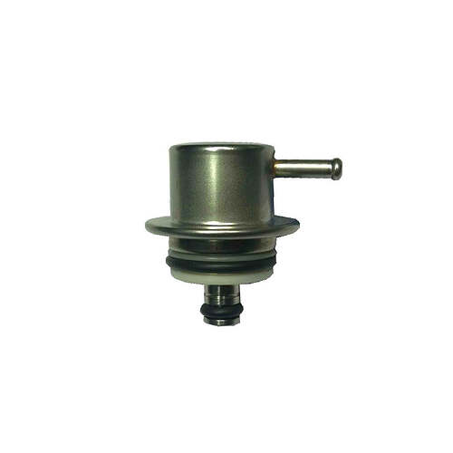

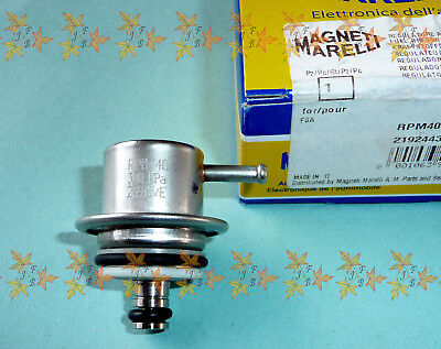

There’s a few on ebay, such as this one
It comes up as a Magneti Marelli RPM40, but Google doesn’t come up with many better suggestions. Here’s another

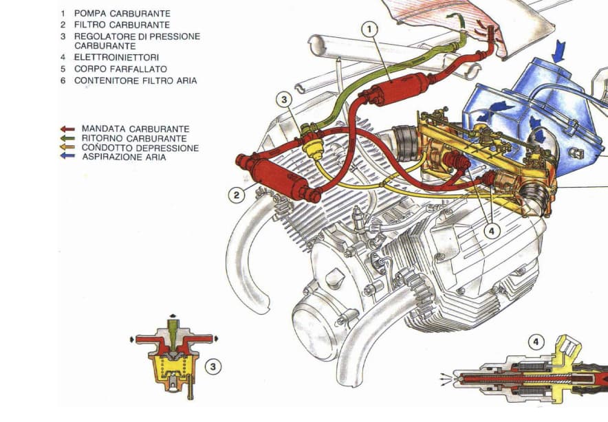

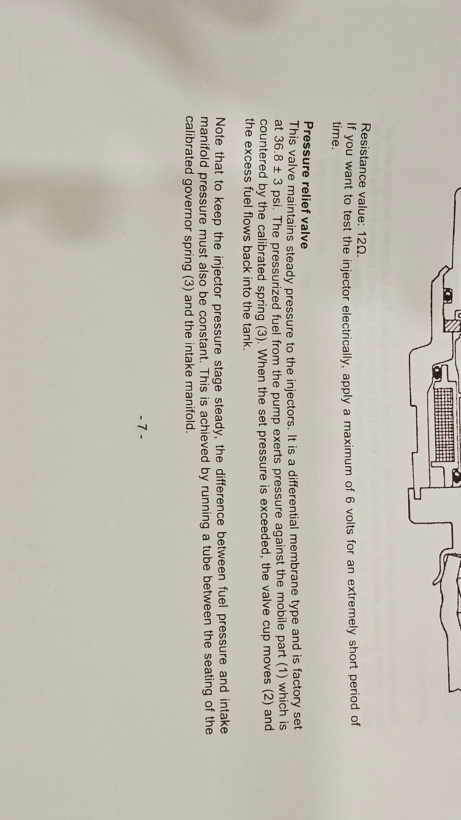

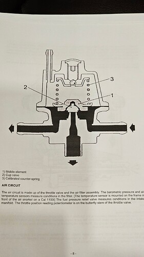

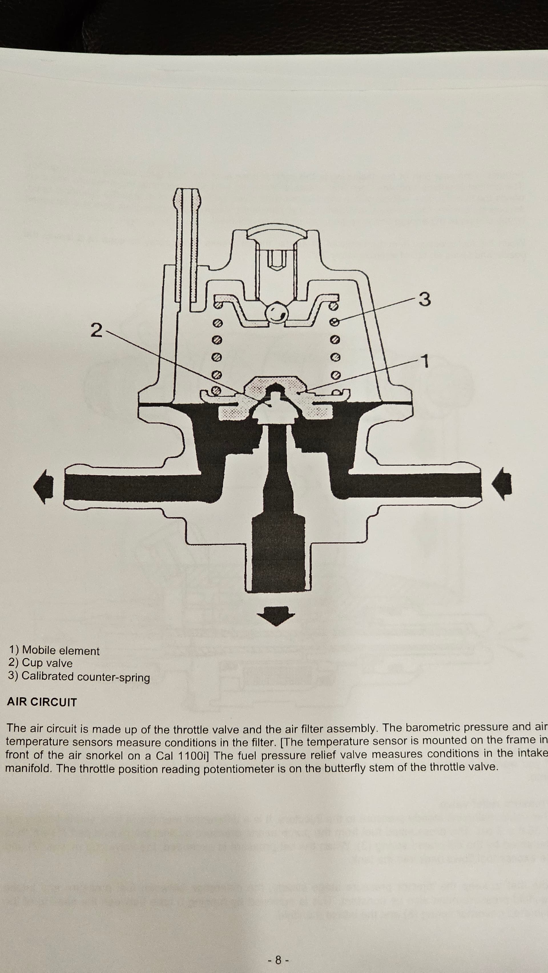

Ii guess this fits in the bottom of the pressure relief valve block or Manifold - the yellow bit in the diagram of item 3 ?
I had a chat with Mike Rdec today for some advice on sourcing a part, its a rare failure if its this part was his guidance, not impossible if crud has got in this valve , his thoughts are based around the TPS setting as he;s experienced similar issues before … lets see if it is this valve then move forward …all i can do is take it step by step …

If the diagram in the manual is vaguely accurateI wondered if you had an air line you could test the pressure yourself and back flush the vale with a paraffin gun in case it is just a bit of crud holding it pen.
Well , getting there slowly, Nik Walsh who Mike Rdec recommended had one available from his limited stock of old parts which has now been delivered for fitting to the bike - Stein Dinse need a few weeks to get one as they are out of stock… 29112760 -Z is the part , looks a little different the original but I am assured it does same job…

The yellow pipes from the regulator that pull the vacuum behind the spring could be suspect i suppose - I have to remind myself everything made of rubber or synthetic compounds decays with time… The pressure regulator identified by Mr P looks a possibility if the one I sourced is kaput - thanks for searching and advising everyone, its appreciated :slight_smile:
