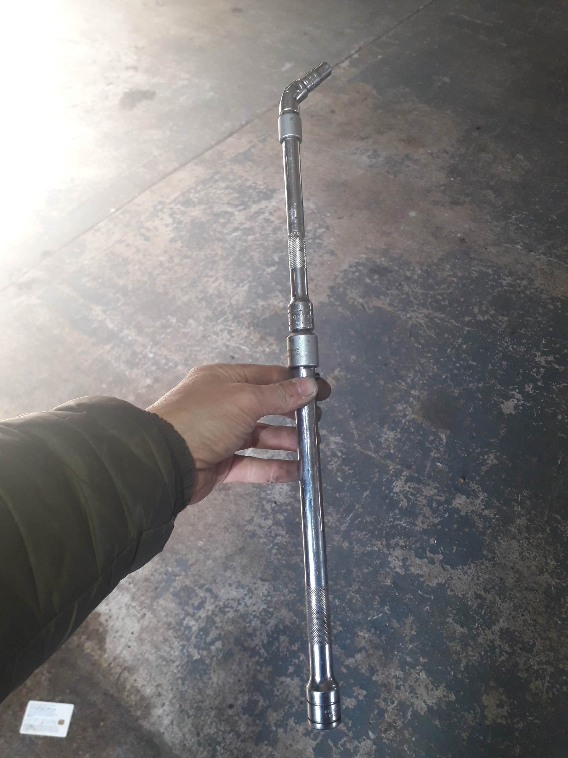

I’m not sure what you call this, but whatever it is, it’s what you need to undo the jubilee clip on the front of the fuel filter! That and eyes on the end of your fingers
That’s good! :grin:

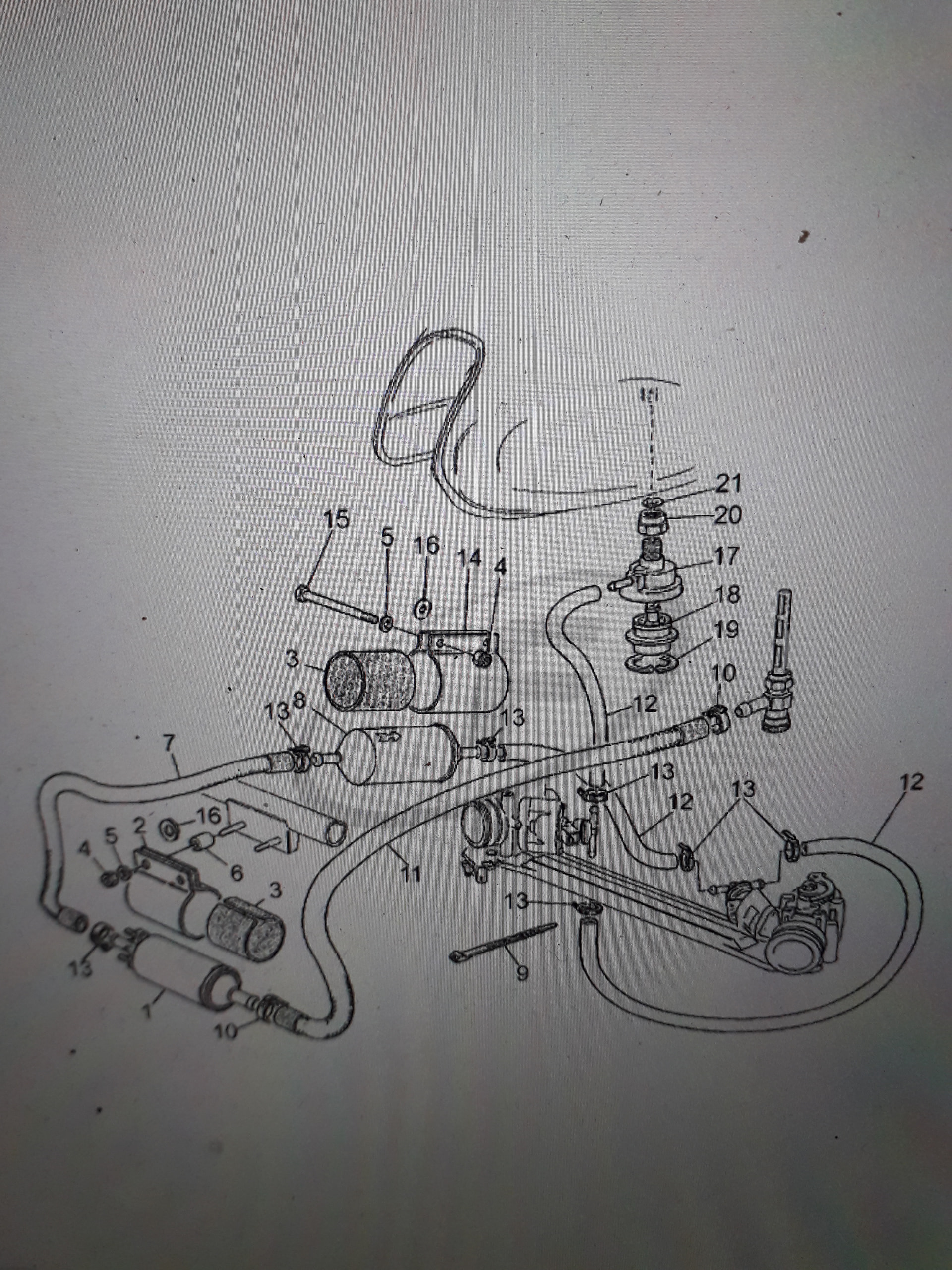

Hi Blubbles your throttle cable outers should not move in and out. Is you fuel pump in the tank with the filter if so you will not have an external one. Regarding the FPR (Fuel Pressure Regulator) located in the front and under the tank this item has a two way thread left hand and right hand and is a pain in the butt to get right.
Hi Richard, my system has the fuel pump outside the tank on the left side of the frame.I was about to try and undo the fpr housing and thinking it looked awkward but i noticed a circlip at the bottom of the housing. Removing that allows you to remove the fpr without having to remove the housing.
That’s certainly a different setup to my earlier model, the fpr is one-piece and discontinued, with a return line to a spigot at the front underside of the tank. At least with yours there’s the ease of undoing a clip and popping a fresh fpr into the housing, far better idea :+1:
Hope it all goes well for you and is the answer.

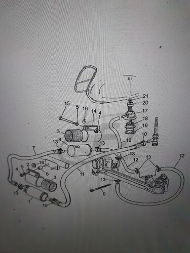

Hi mate it is different to my 2005 model. What is no.1 (the fuel pump ?) - no. 8 is the fuel filter. no. 14 and no. 3 ? The under side of my fuel tank (behind the FPR) has an extra thin pipe push fit attached to the tank and runs all the way down to were the main stand is and probably an overflow pipe or breather ? I wonder if your injectors are semi-blocked.
1 is the fuel pump. You may well be right about the injectors. But the fpr for sure wasn’t right. So I’ll replace that, the fuel lines and the filter and see how it goes from there.
14+3 in the image are just the clamps to hold fuel filter + pump.
