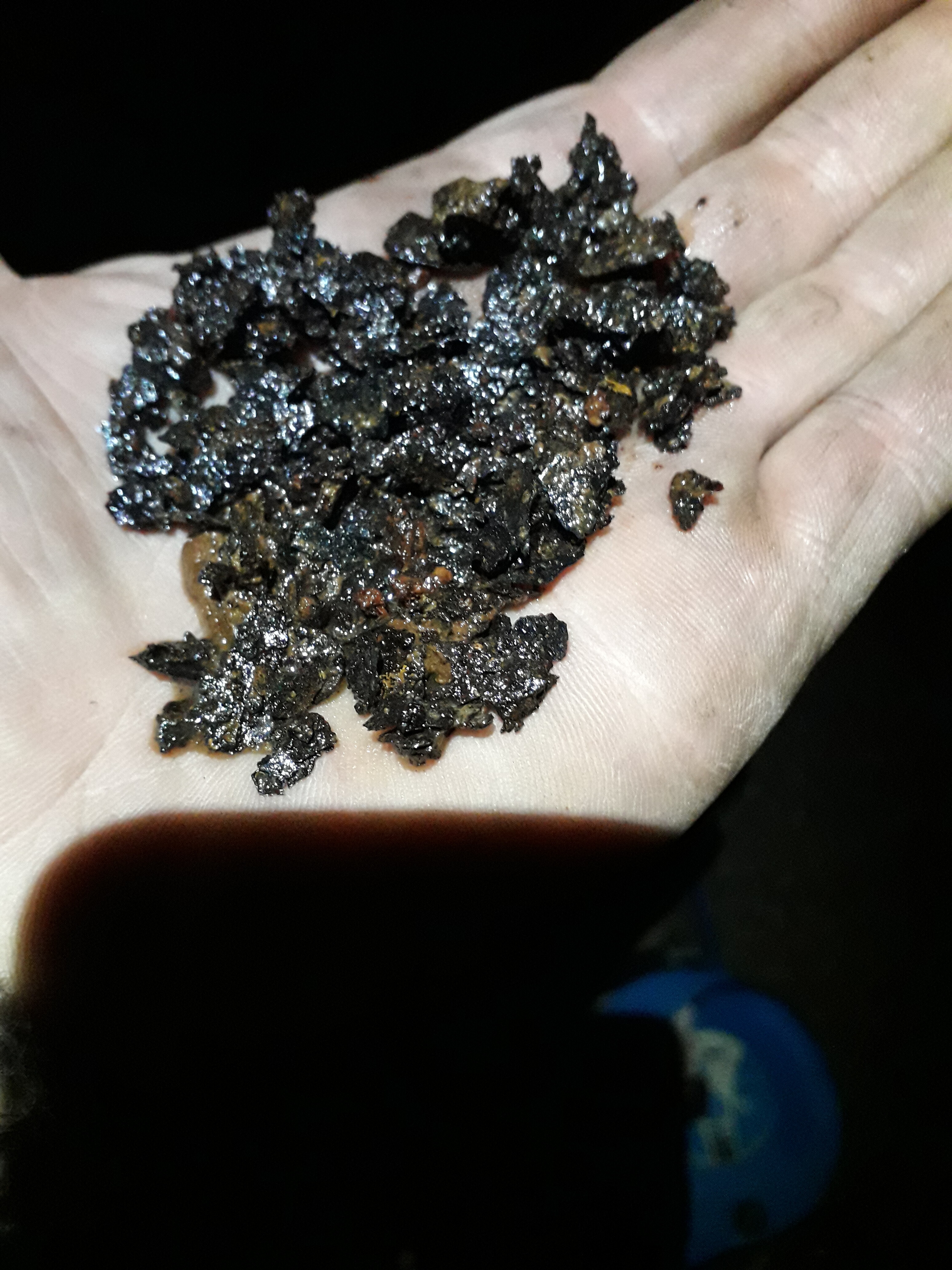

I have now got all the bits to replace the fuel lines and the fpr. I haven’t taken the injectors out yet but that is next on the list. Whilst I’ve been waiting for random deliveries and the fpr to wind a route around varies countries I have been cleaning the tank out… got a good handful of rust flakes out. Also some strange white chalky / sandy substance, I haver no idea what that is!?! Currently the tank is sitting full of vinegar for a few days. Once that is drained/ rinsed it will all be going back together. Fingers crossed that’s as far as I need to go but I’m not ruling out a pump issue or the tps..

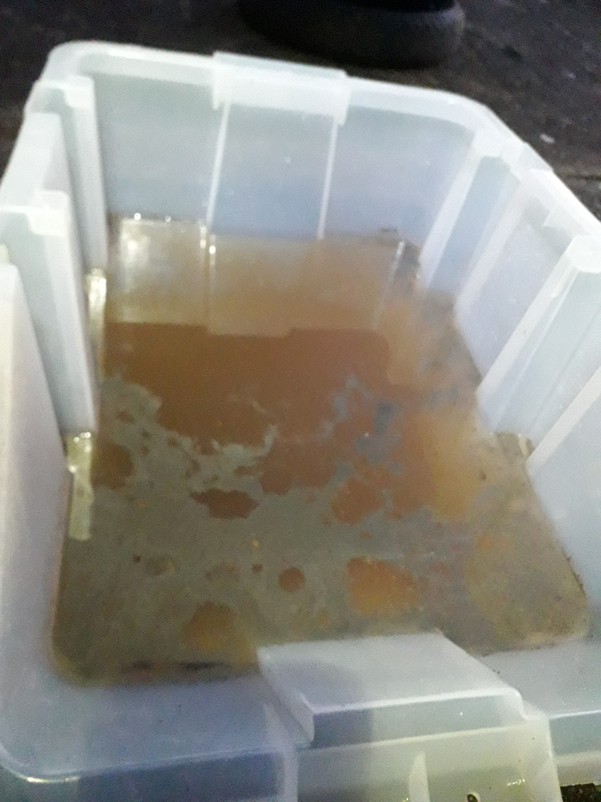

This is the Vinegar and strainings after 48 hours in the tank! Glad I did that!!

Aye, that’s nicely contaminated!
Your chalky/sandy substance is E10 breakdown products. I (and a lot of other BMW K-series owners) have seen that in our fuel tanks.

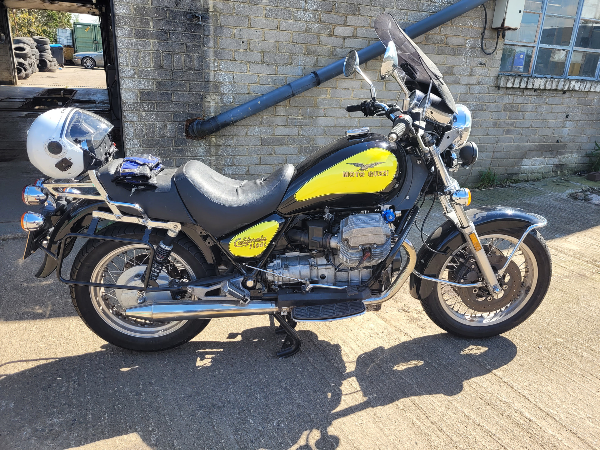

So, it’s all back together. Injectors cleaned and refurbished, tank cleaned, fuel pipes changed, filters changed, fuel pressure regulator changed. Started her up…. Still running weird and the pump still squealing away. Found a new pump cheap on Amazon. Changed that no bad noises, idling much better but still not quite right. Changed the relays but that made no difference. So I guess the last thing to do is balance the throttle bodies and check the tps. It’s not ideal but at least now I can go out for a ride in the sun buy tightening the throttle pull cable a bit! The throttle body itself is very tacky, as in sticky. The throttle Def does not snap back the way I would expect it too… have to say I have never learnt so much so quickly about a bike I have just bought!

Alive! Alive! It’s alive! :joy:
Variable £25 fuel pressure regulator has done the trick… for now…
