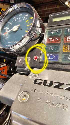

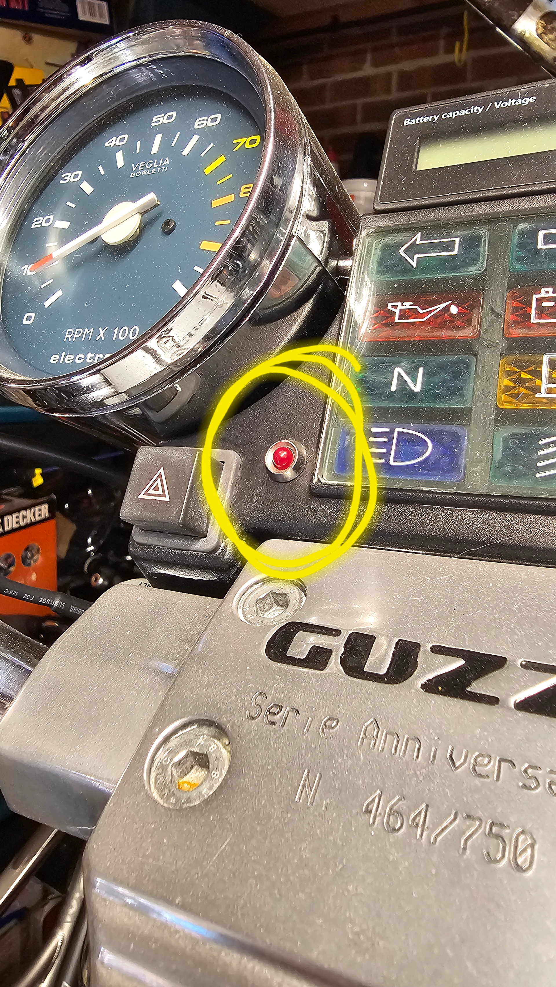

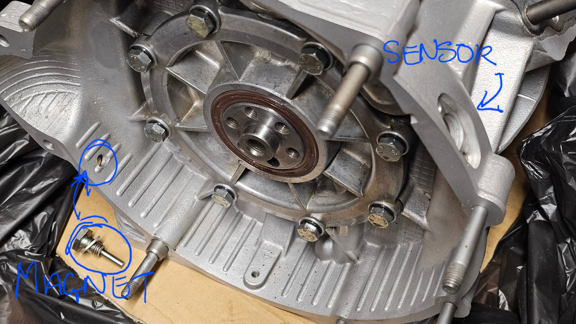

What you have to remember is that the ECU uses ghat relay to control the pump. It will only trigger it when happy. So initial checks you should make will be the ignition switch circuit so the ECU knows it should start. After this one needs to look at what conditions could stop the ECU from starting. The early 1100i have a light on the dash which can give a morse code type read out of the fault. For example I had a similar problem but the cause was dirt on the sensor and magnet in the bell housing, the read out said the gap was too small. What the manual doesn’t tell you is that you need to plug a jumper into the diagnostic socket to enable the lamp on the dash to work. My jumper was cable tied to socket.
I have recentlly posted pictures of the bell housing and flywheel if you want to check. I can post again if needs be.

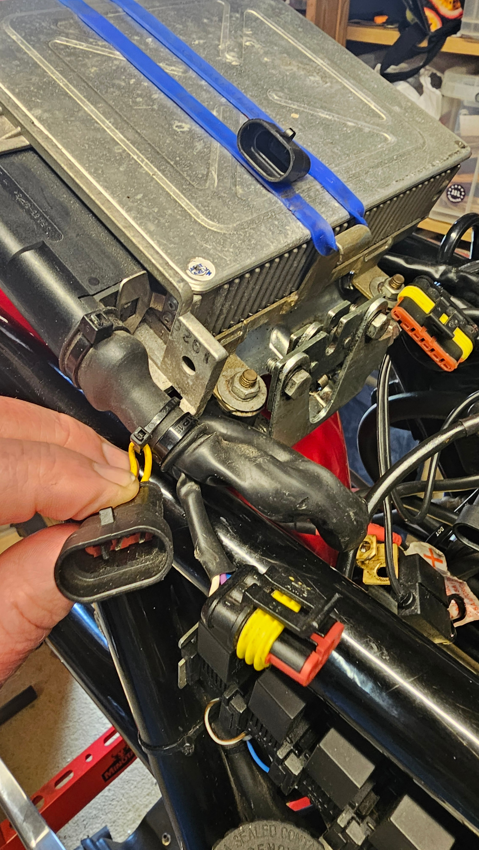

Thanks again Andrew - where is the diagnostic socket if there is one. Can you clarify what you mean by a jumper? Do you mean a piece of wire?
Here is the lamp

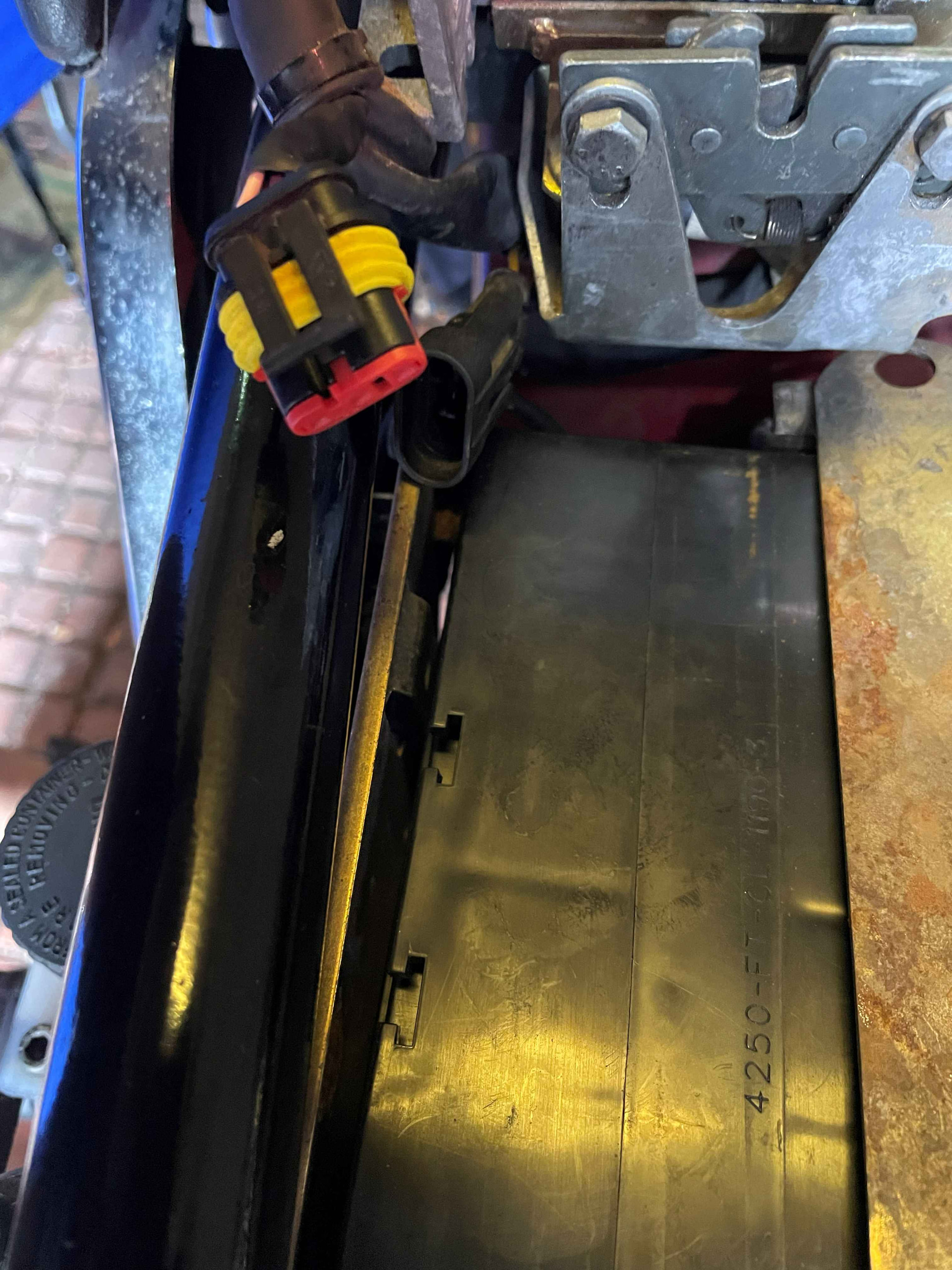

And here is the socket and jumper

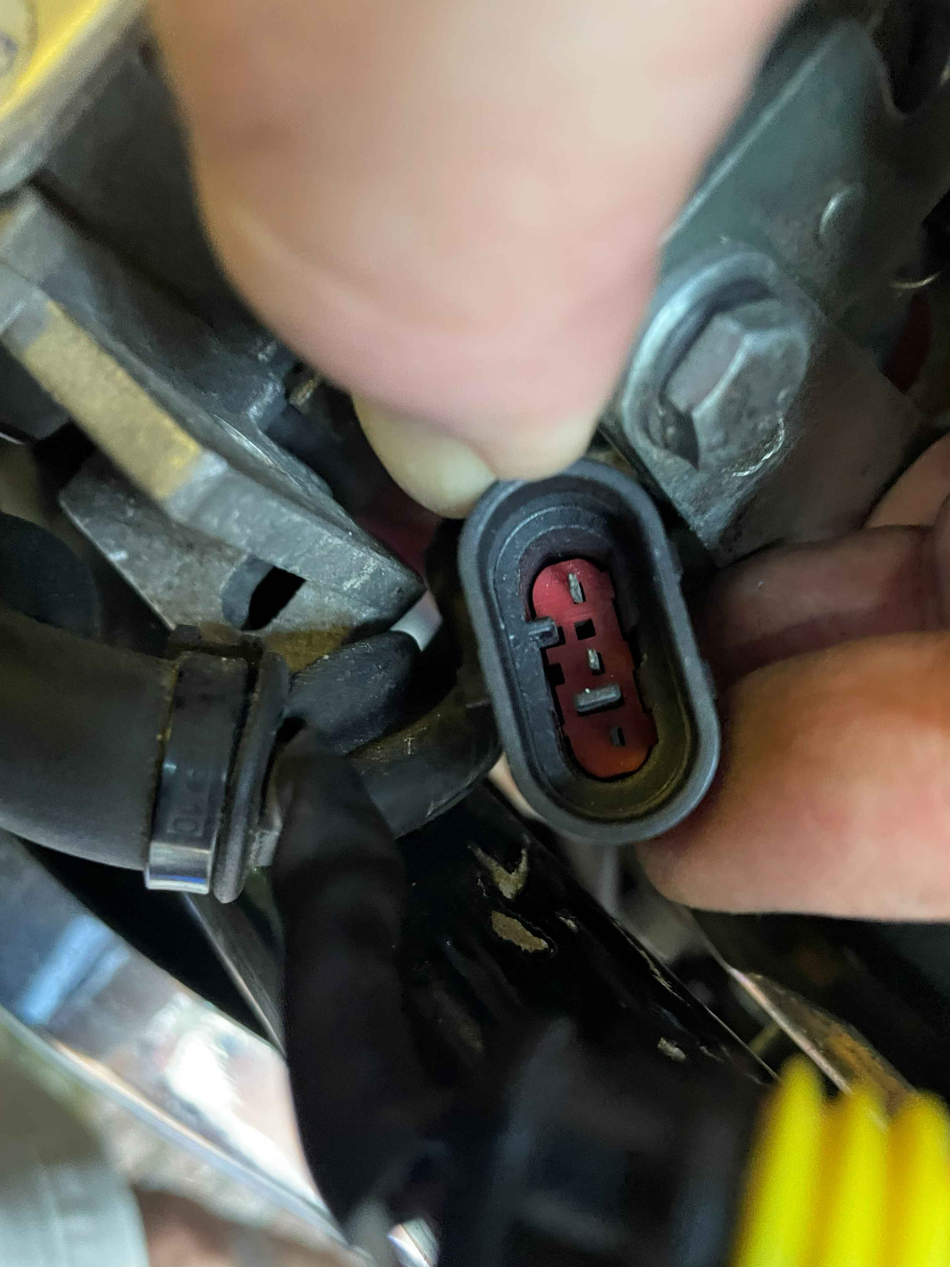

Thanks again - I have found the plug and where to plug it into (see attached pic) but I don’t get anything on the dashboard red light with or without the ignition on. Is there any other procedure I should be doing?
If you look at this pic there are only 2 pins there - the lowest one appears to be missing - should there be 3?
No just two.
The procedure is in the manual I sent you a link to.
Just ignore plugging in the test lamp use your jumper instead.
Could be that someone has removed the wiring. I admit when I bought my bike (preloved) I thought the lamp was for a theft alarm that had been removed.

Can you let me know where to find the pictures you posted of the bellhousing and flywheel?
Martin
Easier to post them again
And showing the bumps on the flywheel
