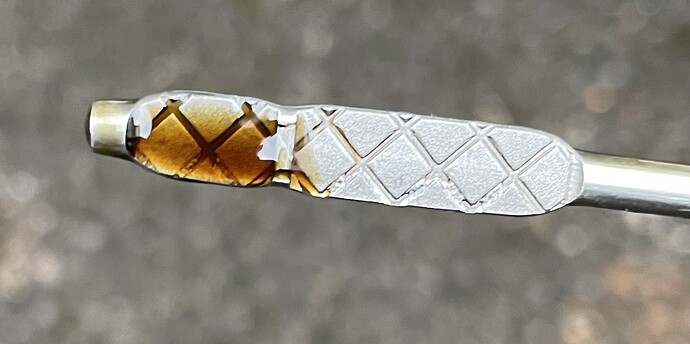

I wanted to check the oil today on a new (old) Breva 750 I’ve bought (2009 edition). The manual has a drawing showing the dipstick but when I pulled the dipstick out of mine it didn’t look the same! No min or max engraved only a line and cross hatching.
The photos show what I saw when I’d stopped the bike after 30 miles or so. I’d appreciate it if anyone can tell me if it’s only just reached the MIN mark :frowning: so thanks in advance for any help.

I’m only guessing but that could be ‘min’, and the top of the cross hatch is ‘max’.
I suppose you could drain the oil, refill with the correct amount and see where the level is.
I think that you’re probably right, but I was hoping from someone who could give a definitive answer. If that MIN it’s actually a max I would have one stuffed Guzzi! :frowning:
You said you stopped the bike after 30 miles. Did you check the level immediately? I ask because if that’s you did, oil will need to drain back into the sump and thus raise the level.
Thanks Mike - no, it was about 10 minutes later after I’d taken me clobber off and let it cool a little, still definitely warm though.
I’ve looked online and found this query to be asked in other places. I found a Guzzi technical note on oil levels for the Breva 750 IE and shows where to fill the dipstick but in true Italian fashion, their photo doesn’t match my dipstick either! However, I’ve concluded that mine is just over the minimum so will be adding more and assuming that the top of the hatching is the MAX. How something so important and yet so simple should become so muddy is a bit of a mystery…

Thinking back to my ownership of a Breva 750, you are correct in thinking that your oil level is at the minimum level and the top of the hatching is the maximum level.
They did change the design of the dipsticks at one point, so presumably the drawing was not updated

I measured from the dipstick flange that seats on the gearbox to the min & max marks. 102mm to the max and 130mm to the min.

If it’s the same as the V7s (I have a V7ii Special) That is the ideal Oil level. I understand that if you fill to the max level it will chuck Oil and possibly other stuff into the airbox, possibly contaminating the air filter. I found about 300ml or half a pint in the airbox of a nasty mayonnaise type mixture when I changed my Oil.
