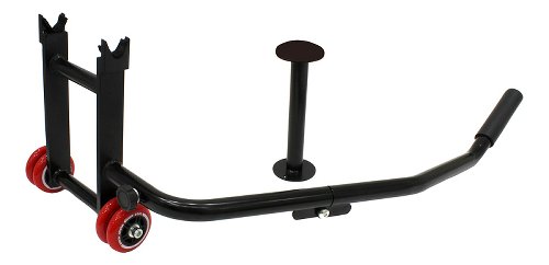

My main concern atm is how to get her off the ground. I have an Americana lift for the Harley’s as both have bottom frame rails that are lowest point on bike & a small flat top scissor Jack that does the same. However can’t use those as the exhaust header pipes are the lowest point on the V7. Don’t fancy lifting the bike on those.
Maybe the small flat bed scissor Jack with a couple of bit of wood under the sump? Be a bit unstable as the sump is curved lol. Don’t make it easy do they!!
What do you guys use? Apart from a center stand.
One of these
