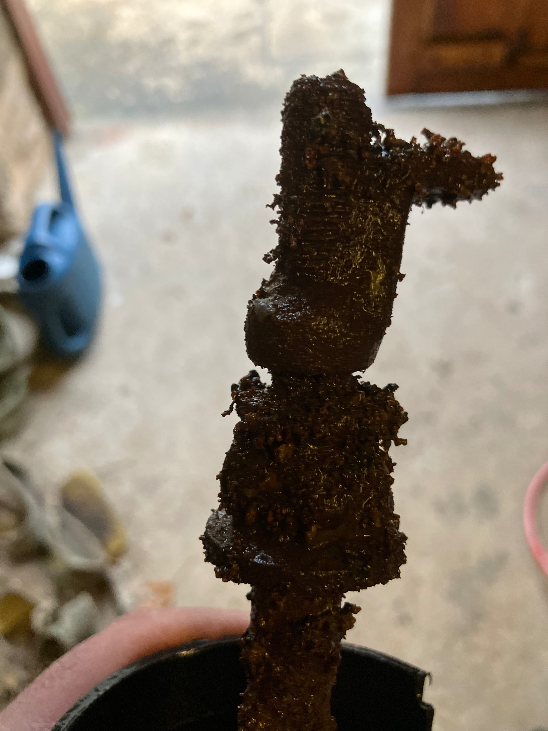

Bought a spare petrol tank for my T3 off EBay and wanted to ensure it was clean and then sealed before painting and future use. Looked at options over the cleaning issue and decided on trying electrolysis.

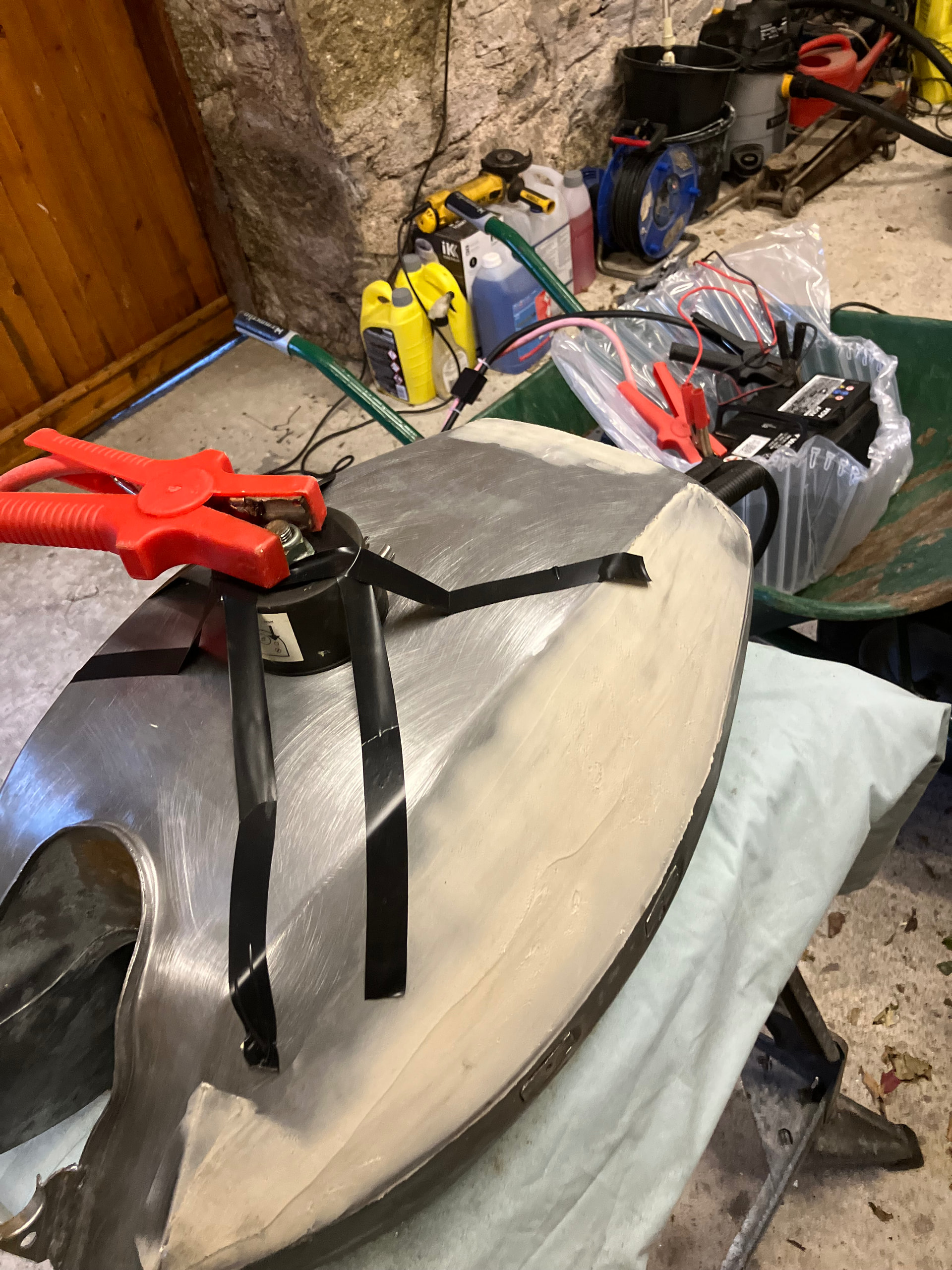

Picture is of the second day’s rust collection. The first day was considerably worse, but I didn’t have a camera to hand. The anode is two bolts welded head to head together along with a bit of a ring spanner end to enlarge the area. The anode extends 12 cm into the full tank of water/sodium carbonate mixture. The cap is an old water thermostat cap that snugly fits over the petrol cap orifice and even has the correct sized cut away to fit over the fuel cap mounting.

Plugged it in for a third day as anode still collecting rust and material. However, the raised section of the inner tank immediately under where the anode sits looks rust free and shiny so happy with the results so far.

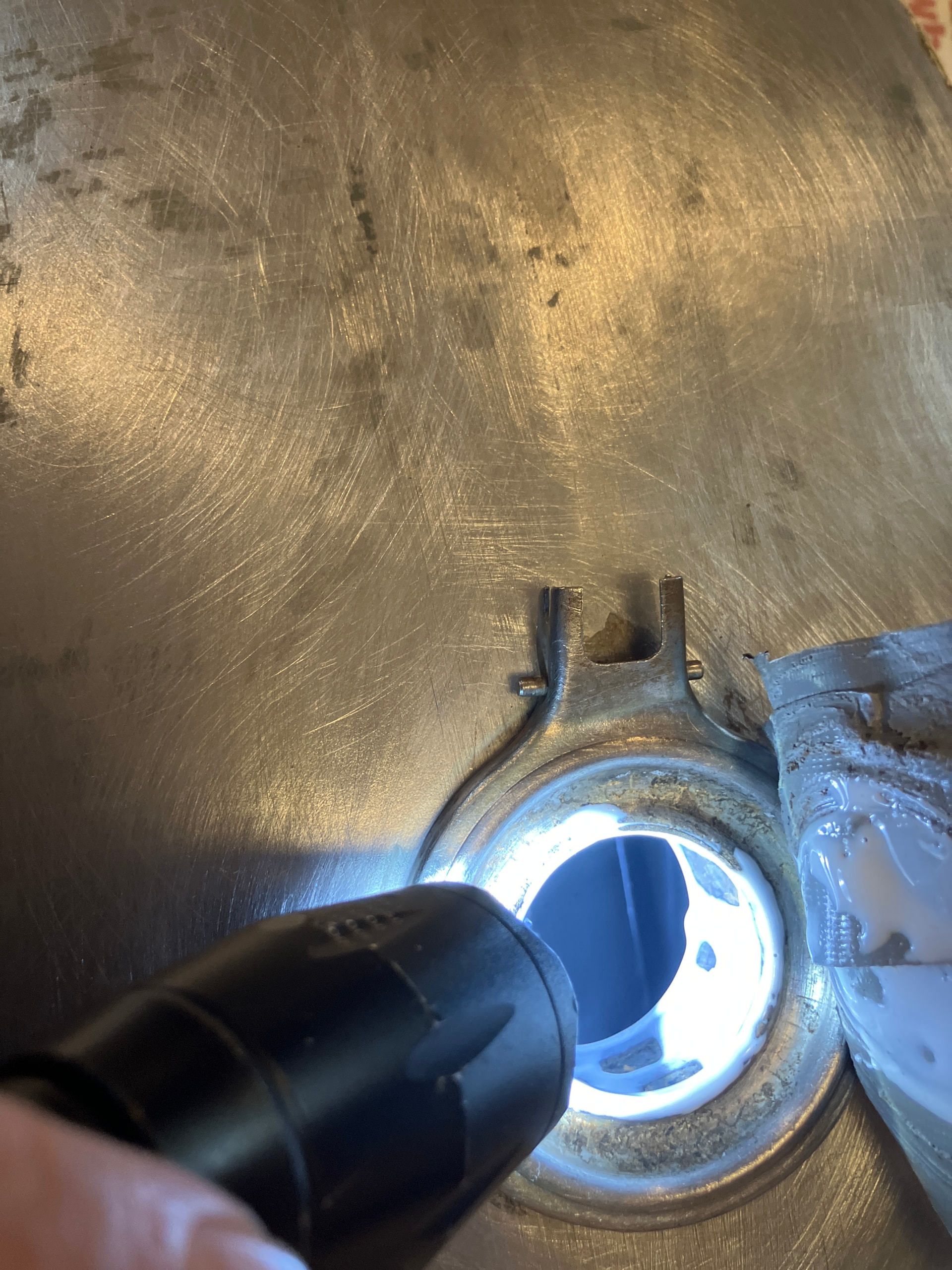

Just doing the ‘Flowliner’ sealant now.
Seems to work ok
I spent ages rolling the liquid around the tank and propping it up at all sorts of strange angles to ensure every surface was coated, finally propping the tank upside down on trestles to let the surplus drain into a waste container. The final finish was excellent - like gloss white enamel. I let it cure for a week before adding fuel. Had a good look inside with a dentists mirror and seemed to have covered 100%
