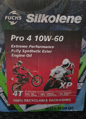

i use this, which is red as well
The colour reminds me of ice cream raspberry sauce but don’t put that in yer engine…
