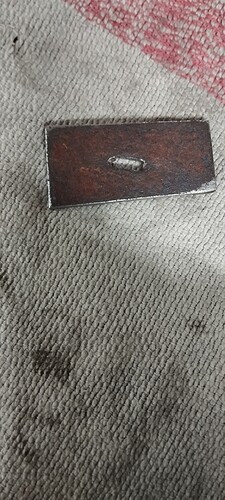

Just adjusted the clutch on my v85tt. It was nearly fully out at the lever and has I had the air filter out I noticed the adjuster underneath at the back of the gearbox and thought let’s give it a go. What a pain in the backside. Undid the locknut and then you have to turn a rod in, had read a while back that it was a flathead screwdriver on older guzzis but on my 2019 v85 it is an oblong piece sticking out. Going in from the air box sidei could get a small movable spanner on but would only turn so far then there is no more room. So I ended up making something as hopefully the photo will show. It would have been better a little longer but it worked. Hope this helps other people out who do their own maintenance
