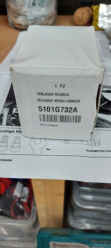

The OBD plug will normally support a battery charger. You need an appropriate adapter. This is because the OBD has to provide 12V to power whatever device is connected to it. This is taken direct from the battery, so can be used to connect a battery charger.
This is what I use on my V100.
Its originally a Ducati part but as long as the OBD connector is the same, it will work.
ETA: £11 - 16 off ebay. Just google the part number you can see.
It’s got an SAE connector on the other end.
https://www.mandp.co.uk/products/ducati-charger-euro-5-dda-connector-wiring-adaptor-cable-5101g732a-dca000269
it’s for this:
I have one, very easy to fit and handy for charging your phone on long trips if it’s raining as the one on the dash isn’t waterproof
