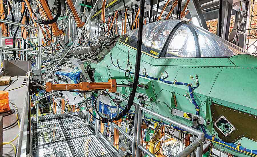

I always crimp with none insulated terminals and good quality tools. There was an argument, sorry discussion about this elsewhere recently. Some folk advocate soldering but as I discovered after some research, the wiring looms made for front line fighter aircraft are crimped. If it’s good enough for a Tornado it’s good enough for a Guzzi. Just avoid the pre-insulated red, blue and yellow crap.
Just my opinion, and that of the aerospace industry.
