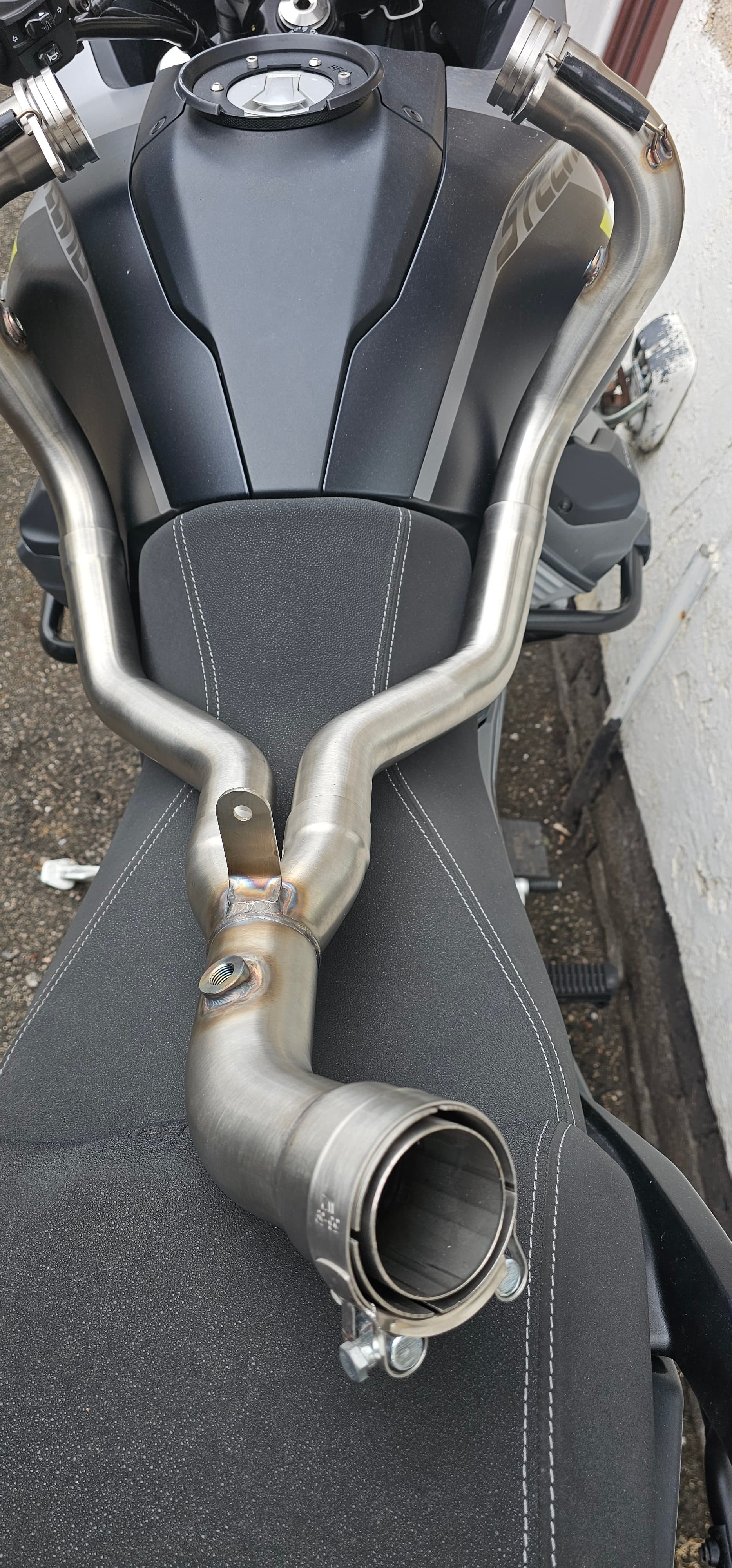

So, we bit the bullet and got one off Agostini themselves along with a cardan shaft protector. All told it was the same price as Stein Dense if not slightly cheaper.

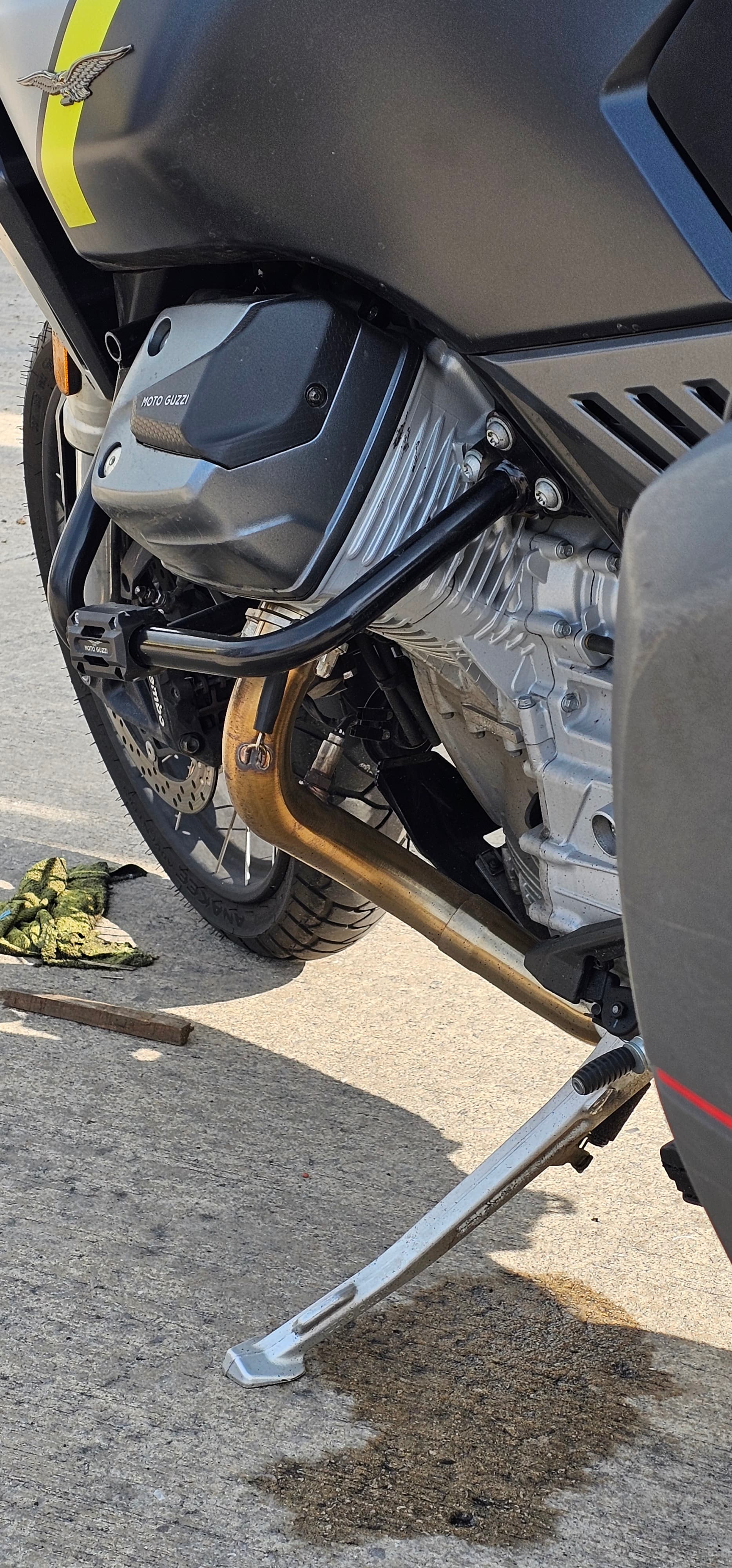

Update…

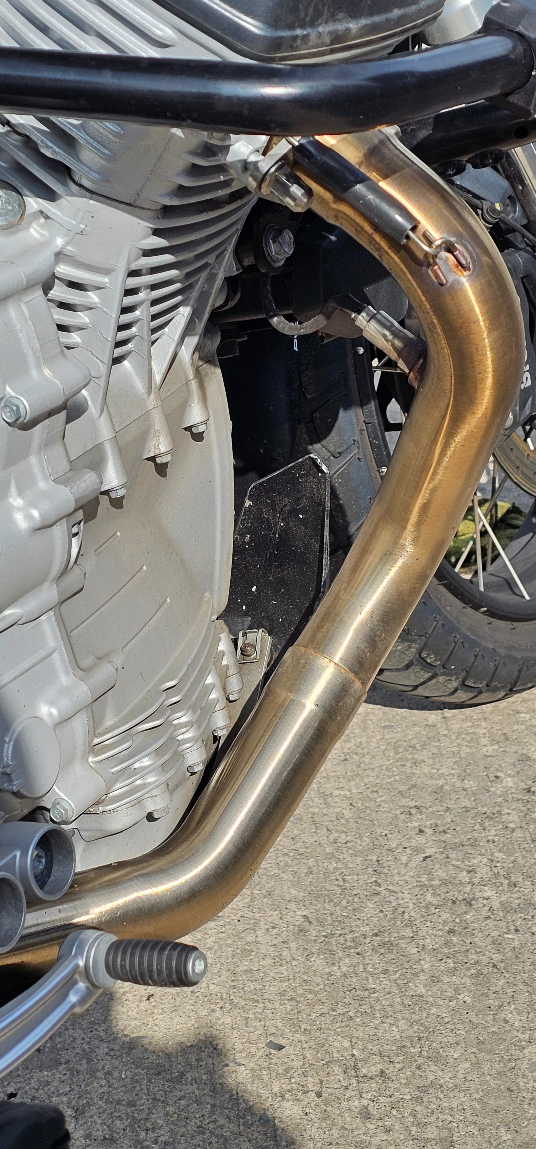

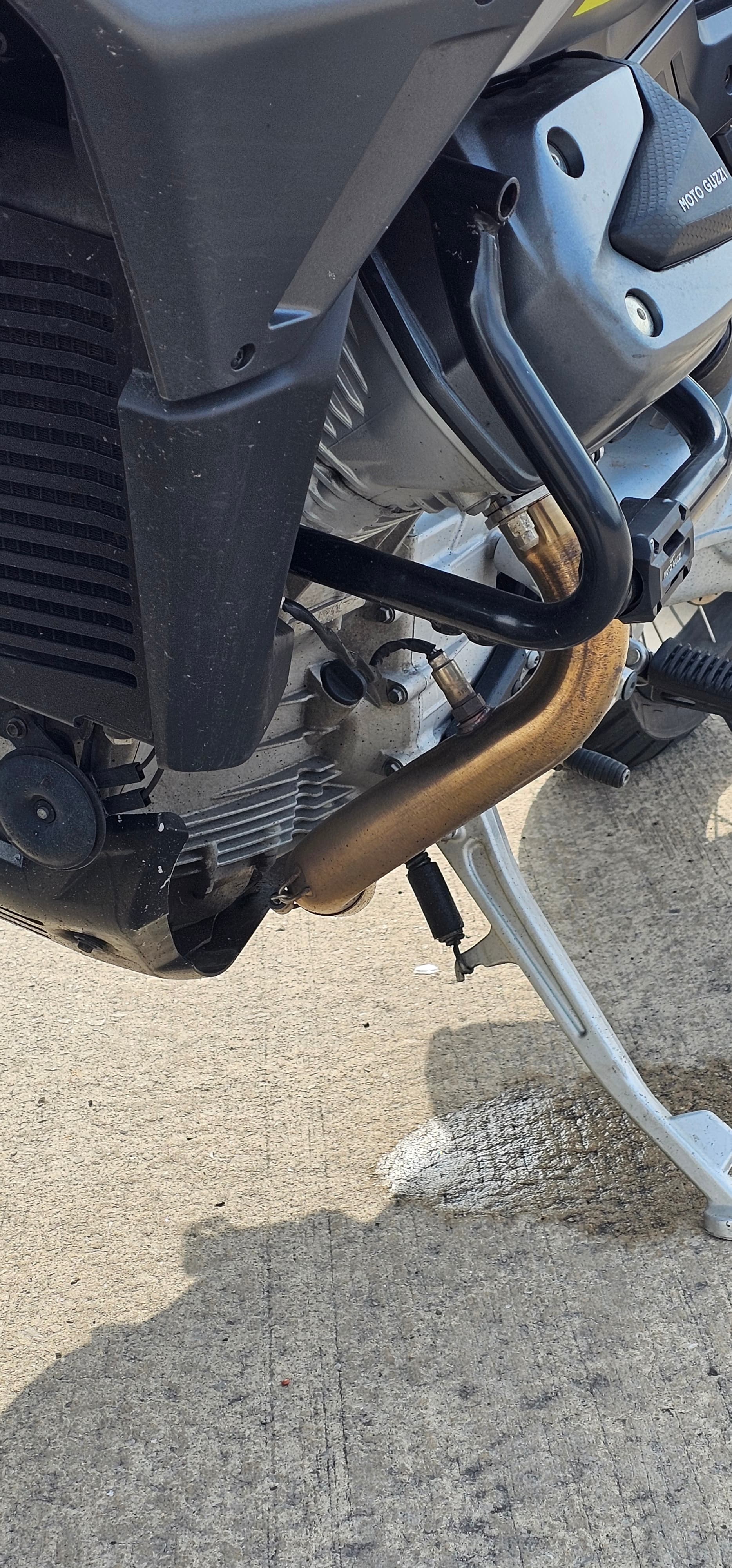

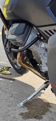

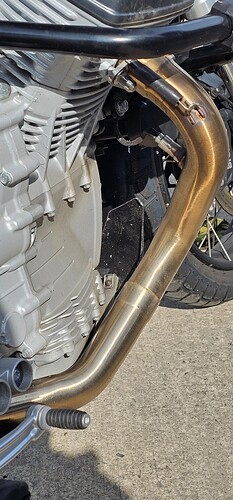

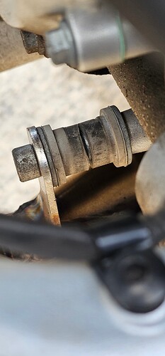

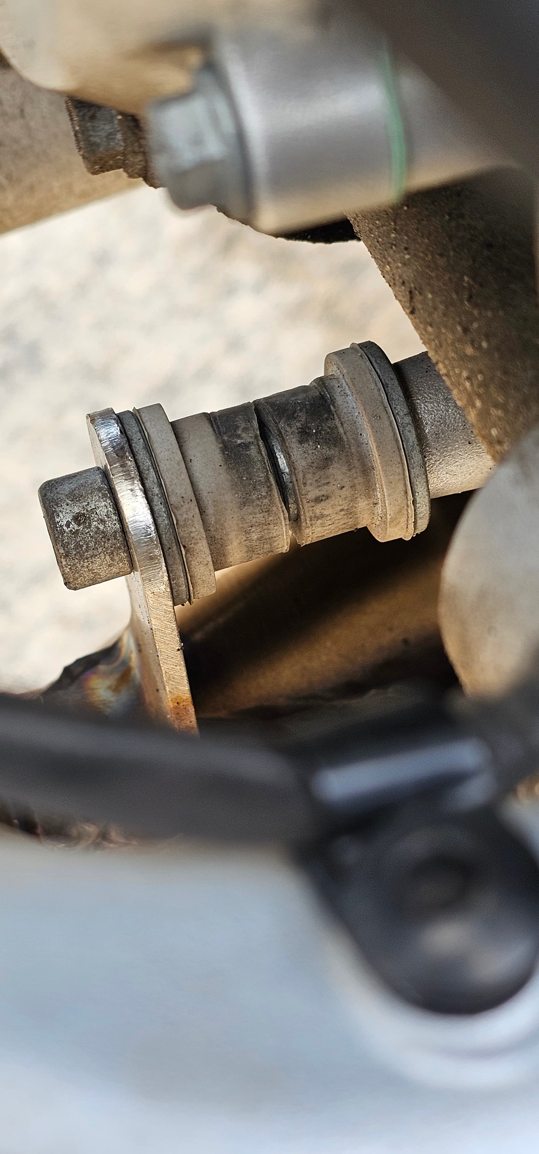

So she’s had the new exhaust fitted now which was relatively straightforward even on the sidestand. Two areas that required thought were

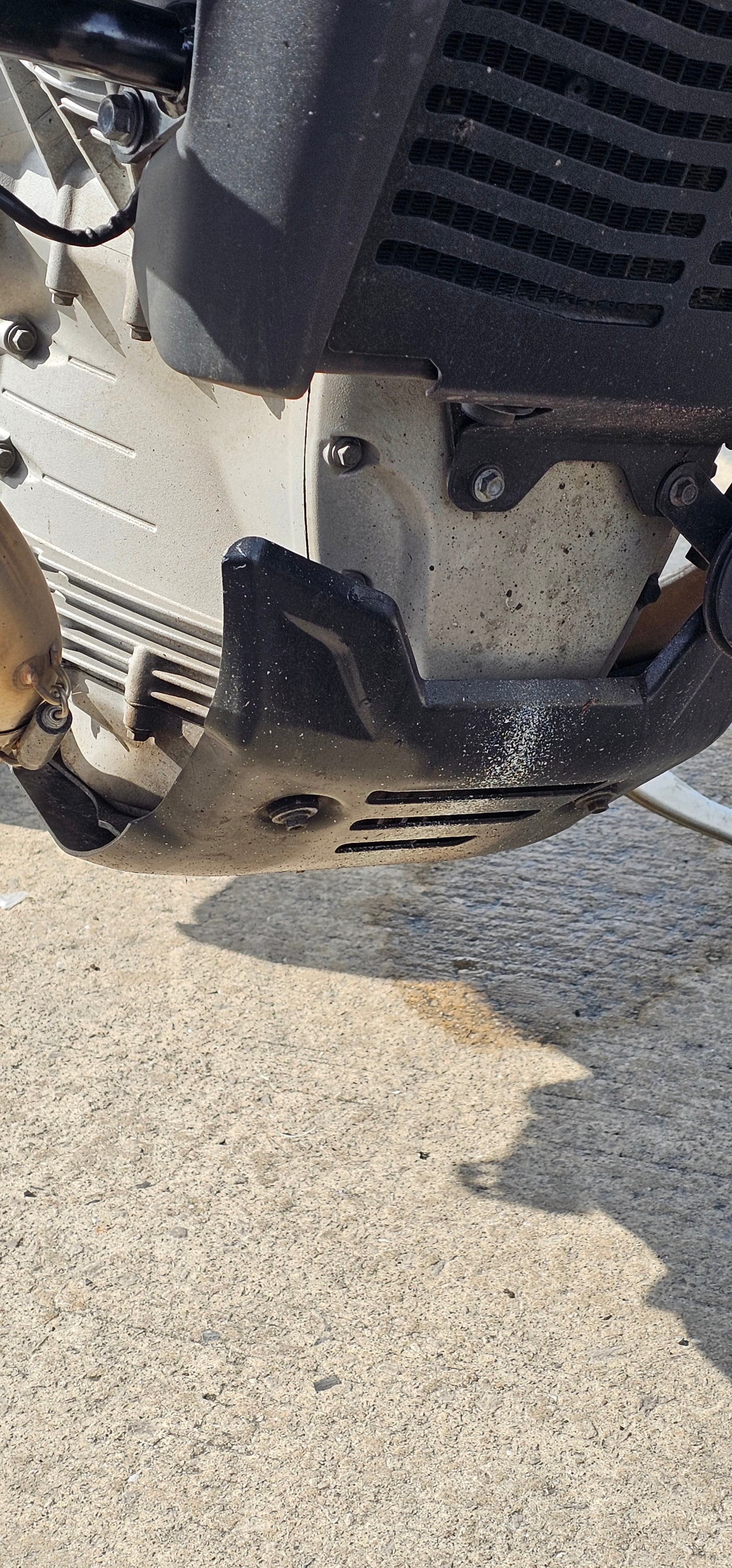

  1. The sump guard required the rear ‘ears’ bending out to clear the pipes.
  2. The rear mounting tab is in the same place as the stock one, but the cat has a tube, and this is flat. The provided spacer didn’t even come close. So, the original bushes were refitted and I’ll get a stainless tube made to cover them.
Without the silencer, boy did she sound good. With it, she’s throatier and nice.
As an aside the fuel economy seems to have increased by about 15 miles a tank. If this continues she will have paid for herself
