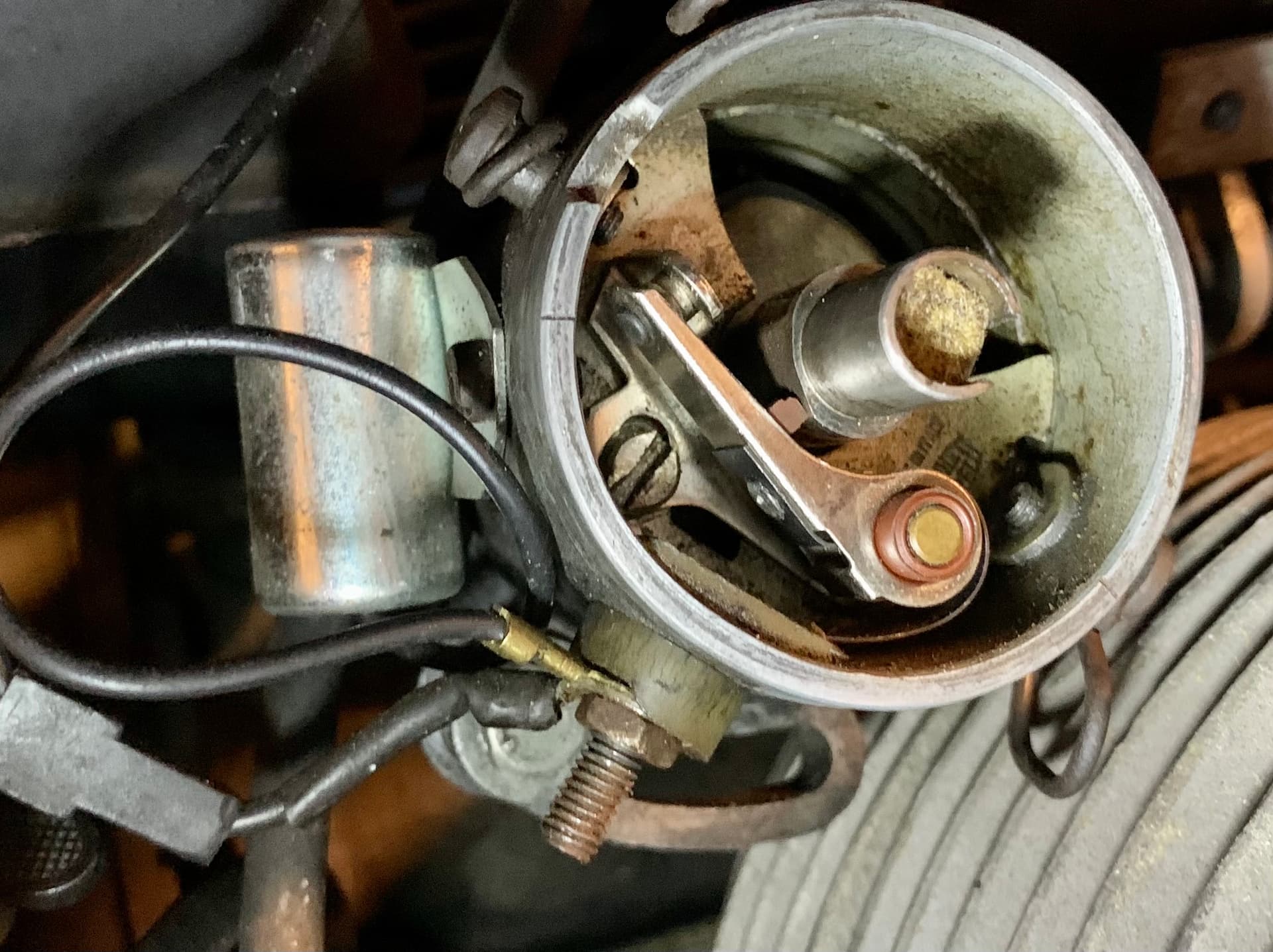

Trouble is, the distributor is right at its limit of adjustment when I get the light to come on. (Left cylinder TDC)
Does this mean that perhaps the distributor drive shaft is perhaps a tooth off and I need to remove it and shift it slightly ?
https://www.thisoldtractor.com/moto_guzzi_loopframe_distributor_installation.html
Attaching a photo.
This is the position when my timing light comes on, with the cam lobe just starting to open the points.
Is this correct ?
